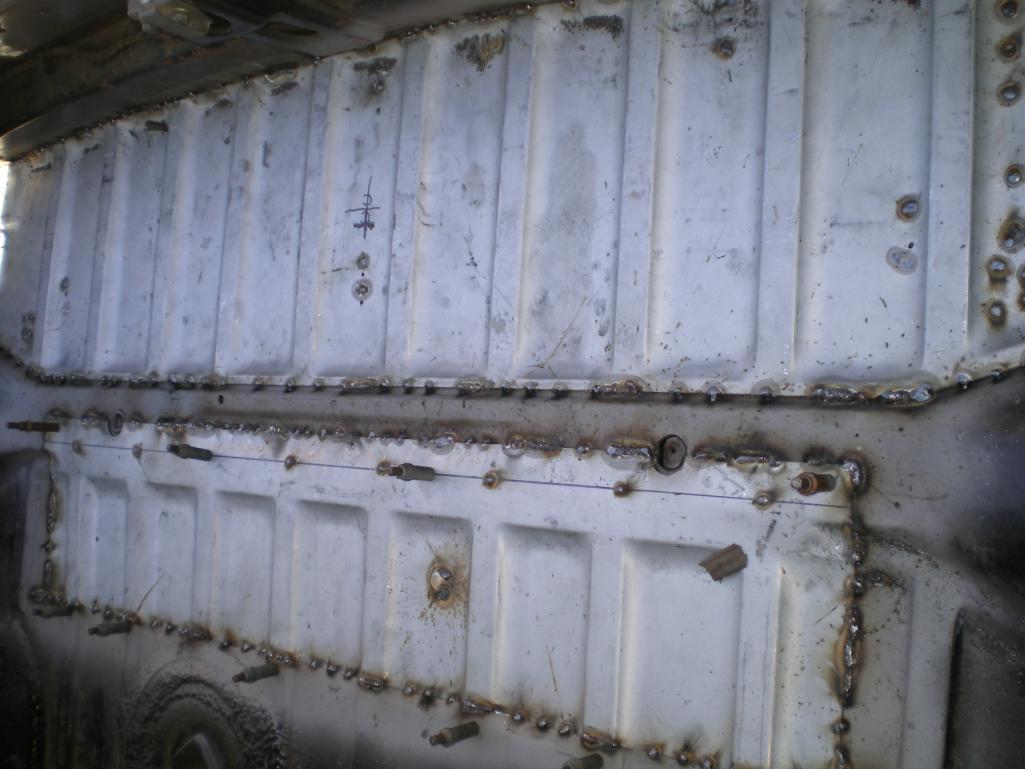

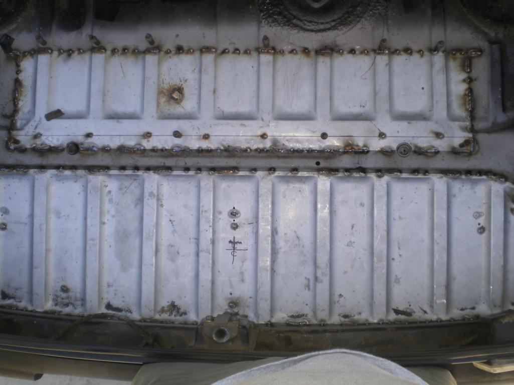

It's finally down after 8 weeks on the jack stands. Ugh! (IMG:style_emoticons/default/barf.gif). I know; it shouldn't have taken that long but I'm old and stupid so I have two good excuses for being slow. Most of this is McMarks fault. Just kidding. I had read a post where McMark describes how to check your CV's. Mine failed. (IMG:style_emoticons/default/headbang.gif) So, I ordered a set of CV's. Then that damned Otto posted these in the classified WTS:
Since it was on jack stands and my trunk looked like this I decided to repair the trunk while it was up. As I began fitting the rear panel piece I noticed the similarity between the rear panel and the piece in front of the trunk spar/brace and thought, maybe...... Then the G&R event happened and found another one of these panels ($5 cheaper than the one I bought from Otto) so I bought it, too! I said too because I also bought a set of Fuch's (IMG:style_emoticons/default/wub.gif) Sure enough, after a few measurements and "trim to fit" I was able to "sneak" this rear panel piece into the front. The slits were intentional to allow the piece to slid between. This is one place that it didn't match. Notice the gap between the new piece and the brace. It's a gap appx. 15mm |
| 76-914 |
Jun 25 2012, 11:14 AM
#2
Repeat Offender & Resident Subaru Antagonist ![]() ![]() ![]() ![]() ![]() ![]() ![]() ![]() ![]() ![]() Group: Members Posts: 13,988 Joined: 23-January 09 From: Temecula, CA Member No.: 9,964 Region Association: Southern California
Geez, I almost forgot the "money shot". Ethan aka '73-914kid was gracious enough to weld these pieces up for me. I had attempted a few spots with the flux splatter machine before Ethan offered me the use of his mig welder. You can see where I began to weld the new ground stud in place with the splatter machine. After I witnessed his abilities over mine, I decided to have Ethan weld it up. Thx a million Ethan. (IMG:style_emoticons/default/beerchug.gif)

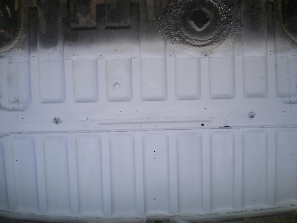

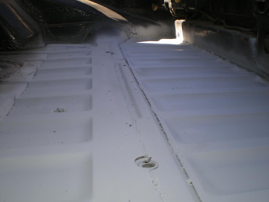

A can of Seam Sealer and a little paint is all she needs now! |

xsJerry Nice job on the trunk. I just cut out a piece of 1... Jun 25 2012, 10:05 PM
SLITS Now you can trap water again.
Good job Kent (at l... Jun 25 2012, 11:26 AM
ThePaintedMan Couple questions. Since this isn't load bearin... Jun 25 2012, 12:55 PM
76-914
Couple questions. Since this isn't load beari... Jun 25 2012, 03:32 PM
ThePaintedMan
Those extra holes should have the dowel pins ins... Jun 25 2012, 07:40 PM
