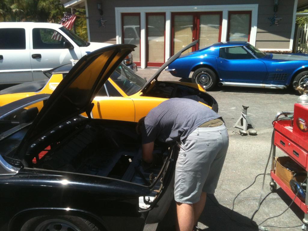

Couple questions. Since this isn't load bearing, its just spot welded in, correct? Thats what it looks like. Makes sense. Also, has anyone else used those new CV boots from Pelican? Mine had 2 blank bolt holes in them, like his. Do you plan on sealing them? I used nylon bolts from Home Depot, which seems to be working for now. Wood floors SUCKKKKKK! I had to do a whole downstairs in bamboo tongue and grove once. My knees and back have never hurt so bad (no sick jokes) Correct, it is just spot welded similar to the factory. Is it load bearing? Not really. Those extra holes should have the dowel pins inserted there. w/o those pins you place the entire shear load on those CV bolt's. I suspect that the dowel pins are of a different hardness designed for "shear strength" and not "tensil strength" which the CV bolts would employ. Here is a pic of Ethan at work. Not his best side. (IMG:style_emoticons/default/lol-2.gif) |
