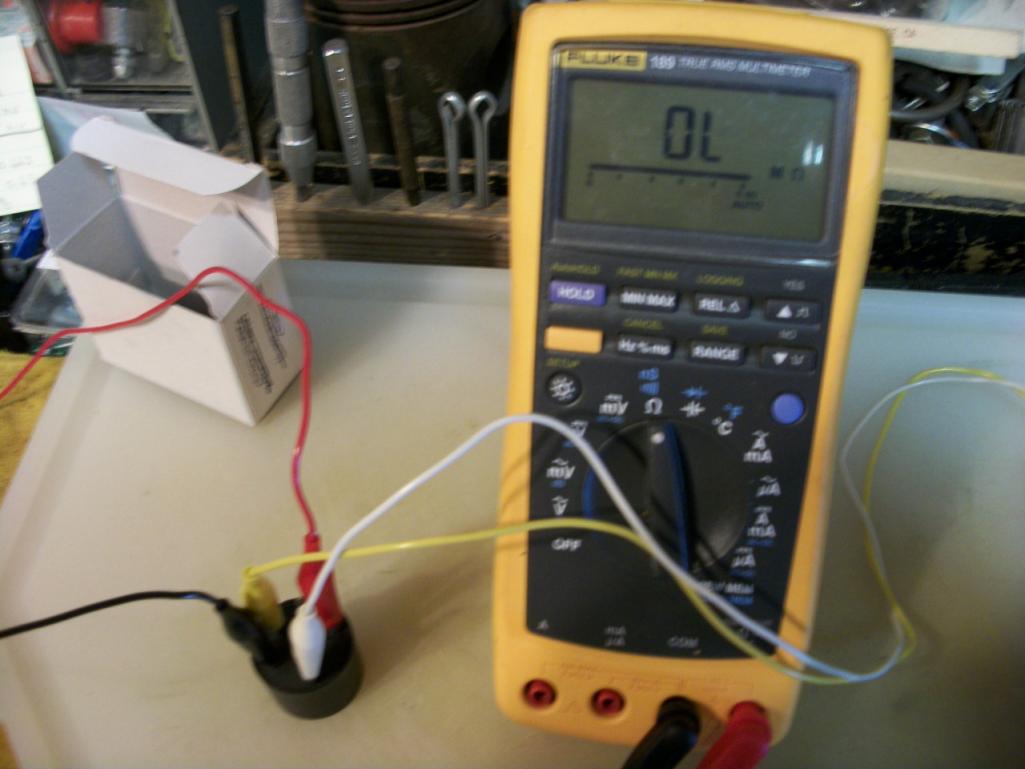

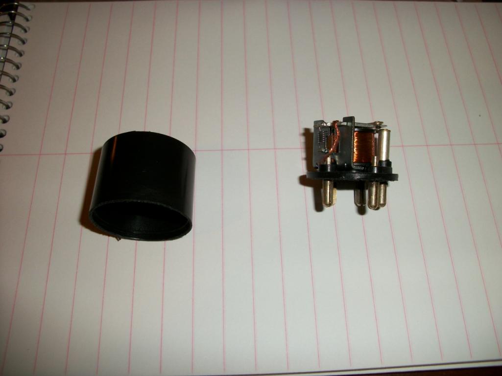

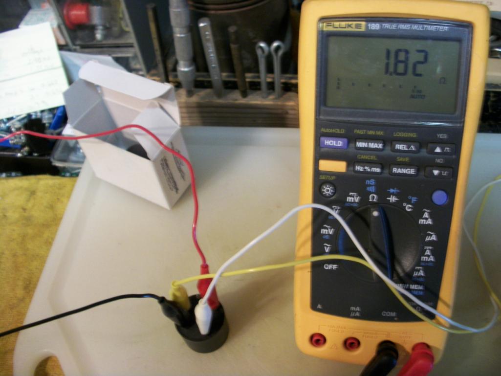

As for testing the relays here are a couple of pics. + to 85, negative to 86. Meter leads yellow to 87, white to 30. No power = open Power applied = 0 + OR - a couple of ohms. You can take the top off of these and try to repair. I have done a couple. The very fine wire from post 85 or 86 can come unsoldered. By resoldering, the relay is good again. Tom Attached thumbnail(s) |
