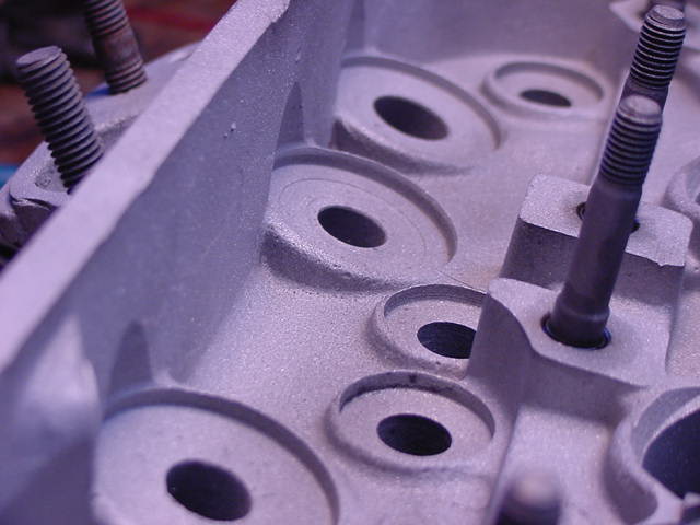

Any one in the Bay Area.... (IMG:style_emoticons/default/boldblue.gif)
I'm in need of quick referral to an excellent aluminum welder in the Bay area or East Bay, at least someone with experience in welding air cool heads.... (IMG:style_emoticons/default/welder.gif) Stupid me, without thinking carefully (and last time I played with the heads about six years ago), I tried to press out the old intake guides and S$%T, there's a shoulder on the top part of the guide, being forced into a smaller hole! Yeah, dummy me! (IMG:style_emoticons/default/headbang.gif) (IMG:style_emoticons/default/headbang.gif) (IMG:style_emoticons/default/headbang.gif) (IMG:style_emoticons/default/pissoff.gif) I really need to move fast as I want to get the engine out into the car before WWC...so HELP!! Anyone??? (IMG:style_emoticons/default/wacko.gif) Thanks in advance....sigh! jerry |

Member ![]() ![]() Group: Members Posts: 292 Joined: 9-February 03 From: Pleasanton, CA Member No.: 273 |
Now, the weird head....with the "step up" part machined off...

Carrera916 Hi again....
I got around to take pictures...it s... May 31 2004, 09:53 PM
Carrera916 Here's the picture.... May 31 2004, 09:54 PM
Carrera916 Same head, inside the guide bore: May 31 2004, 09:55 PM
Carrera916 Same head again, somewhere around the bore: May 31 2004, 09:56 PM
Carrera916 and with the 'pothole' markings underneath... May 31 2004, 09:58 PM
Carrera916 Same pothole'd head.... May 31 2004, 09:59 PM
