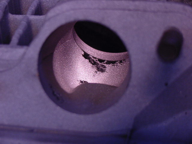

I'm in need of quick referral to an excellent aluminum welder in the Bay area or East Bay, at least someone with experience in welding air cool heads.... (IMG:style_emoticons/default/welder.gif) Stupid me, without thinking carefully (and last time I played with the heads about six years ago), I tried to press out the old intake guides and S$%T, there's a shoulder on the top part of the guide, being forced into a smaller hole! Yeah, dummy me! (IMG:style_emoticons/default/headbang.gif) (IMG:style_emoticons/default/headbang.gif) (IMG:style_emoticons/default/headbang.gif) (IMG:style_emoticons/default/pissoff.gif) I really need to move fast as I want to get the engine out into the car before WWC...so HELP!! Anyone??? (IMG:style_emoticons/default/wacko.gif) Thanks in advance....sigh! jerry |

ppickerell PLease shoot a picture and post and I will ask my ... May 30 2004, 07:21 PM

Carrera916 Hi again....
I got around to take pictures...it s... May 31 2004, 09:53 PM
Carrera916 Here's the picture.... May 31 2004, 09:54 PM
Carrera916 Same head, inside the guide bore: May 31 2004, 09:55 PM
Carrera916 Same head again, somewhere around the bore: May 31 2004, 09:56 PM
Carrera916 Now, the weird head....with the "step up" part mac... May 31 2004, 09:57 PM
Carrera916 and with the 'pothole' markings underneath... May 31 2004, 09:58 PM
Carrera916 Patrick....
To do the welding on the Weird Head..... May 31 2004, 10:02 PM
Carrera916 oh...
I forgot to show you this....the valve guid... May 31 2004, 10:05 PM
Carrera916 the other ones.... May 31 2004, 10:05 PM
Carrera916 Engine builders....Jake, Brad, anyone...
Do you f... May 31 2004, 10:22 PM
Mark Henry Both heads need a lot of work, I'd try to find... Jun 1 2004, 07:55 AM![]() ![]() |
