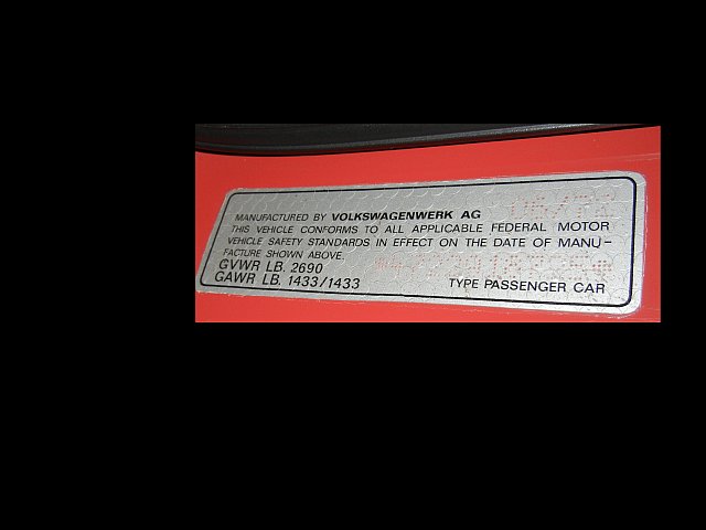

Pat, Is it possible you drove a left over '71 dealer test vehicle?
Doc Johnson says, "A third version of the dash was used on all models from 1972 on." (this is in reference to the two earlier versions of the '70/'71 models /4 & /6)
"This corresponds to the wiper/washer system controls being moved to the column on four-cyl cars, disappearance of the center defrost vent and the appearance of fresh air vents on the ends of the dash board." Page 59 of the revised edition.
In addition, I have an early '72 owners manual printed VIII/71 which shows a detailed picture of the new '72 MY dash.

Don,
Here's my plate.
