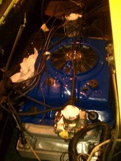

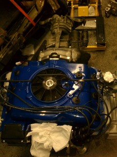

Well engine is in the car, not fully secure but in the car. Fits nice as long as you cut off the oil filter mount and remove the original Corvair engine mount plate..

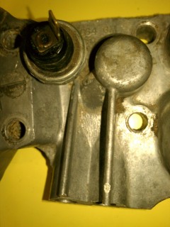

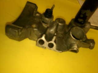

Made monting it more difficult because of choosing a aluminum finned oil pan which took away a 1 1/4 inch of clearance from the enging mount bar, going to be a tight fit. May have to lower the bar a bit depending on final mount design.
Going to be a bit before it is started. Since I did not take the engine out I need to figure out what wires go where.
Also need to fab up the engine mount and there is the filter mount I cut. I think I have two options, Weld in AN fittings where I cut it off and do a remote filter and cooler. Will need to angle cut at least one of them to allow room to thighten fittings to them. Other option that may work is to weld the holes shut and remove the pressure switch, drill a hole at the other 90 degree angle and add AN fittings there. Then do a remote filter, cooler and pressure switch mount.
Here are pictures of the cut filter and mounting plate.

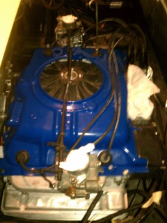

Here is the engine before it went into the car.
