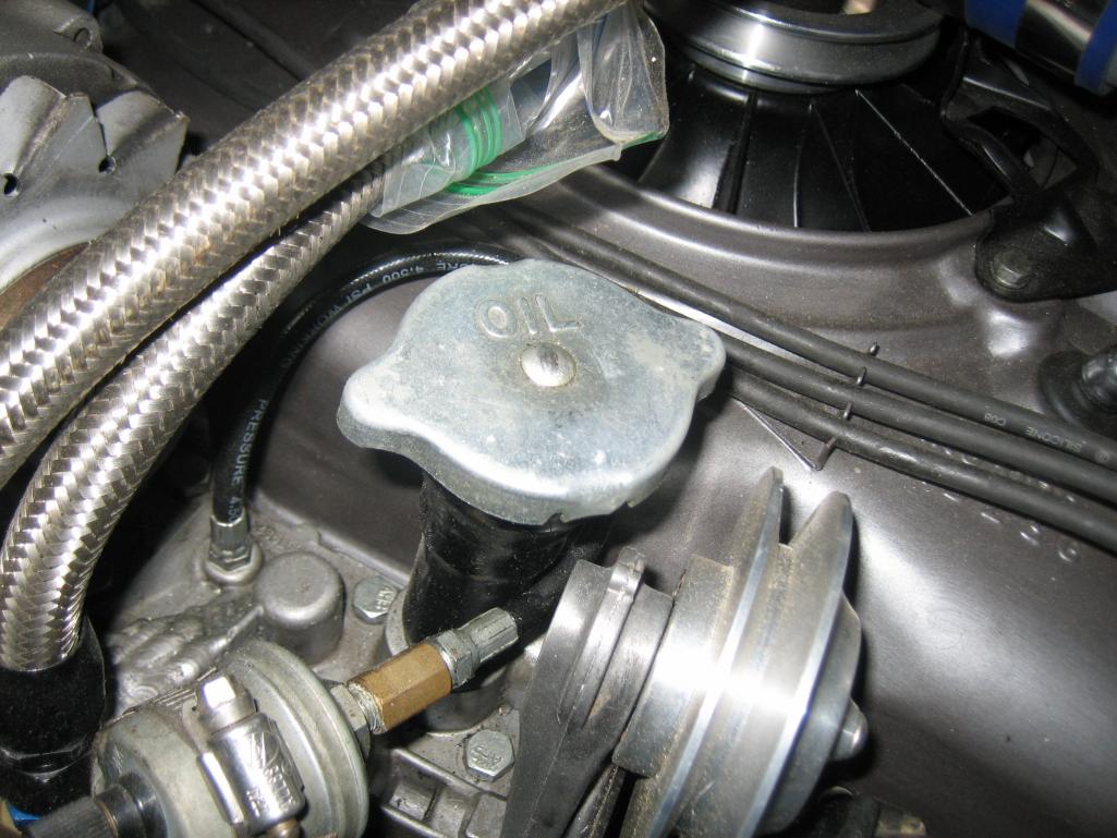

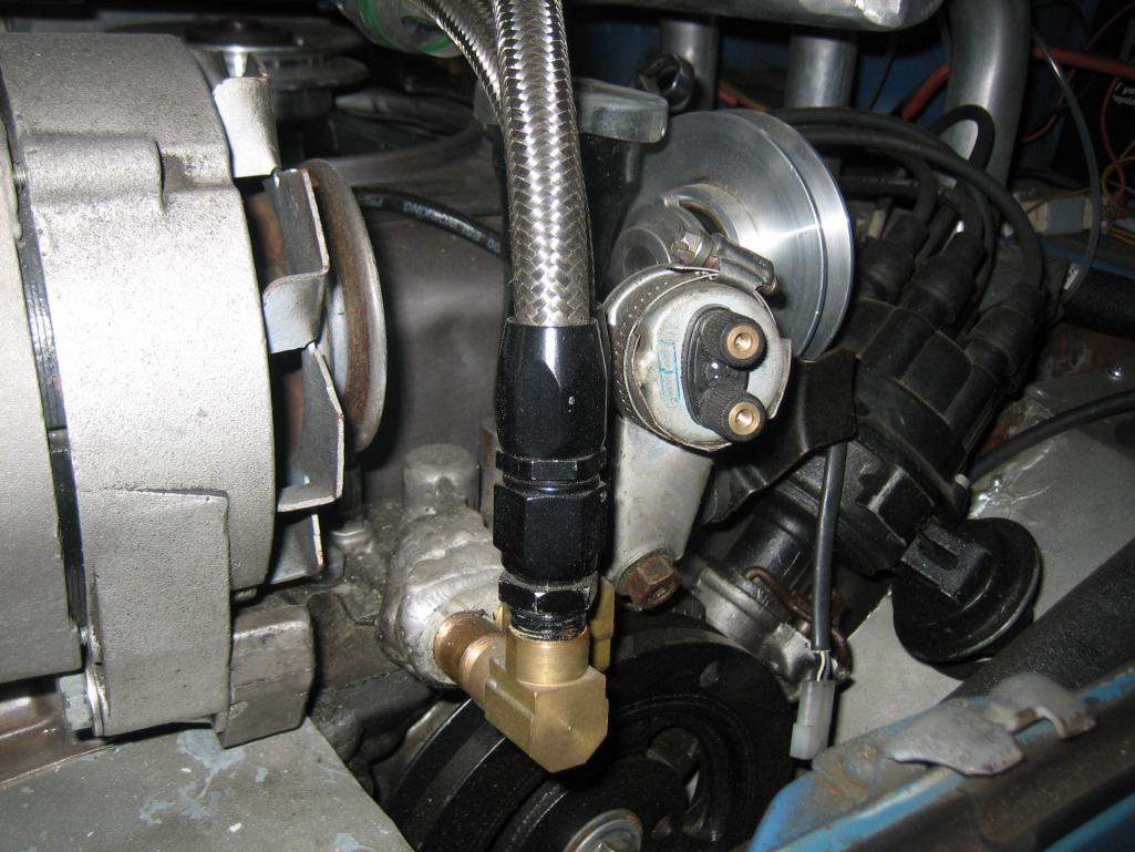

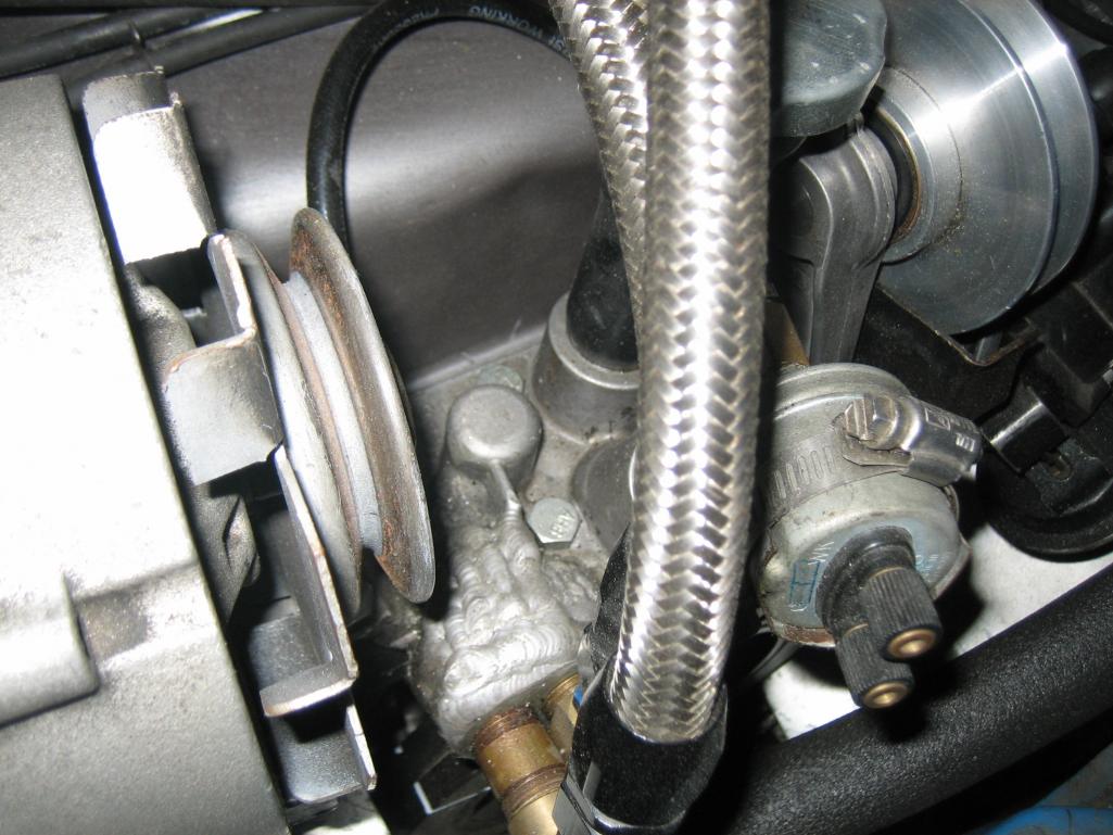

Here is my setup. I have the lines going to a thermostat and cooler.

Dr Evil   Here is my setup. I have the lines going to a ther...   Jul 1 2012, 06:52 PM
