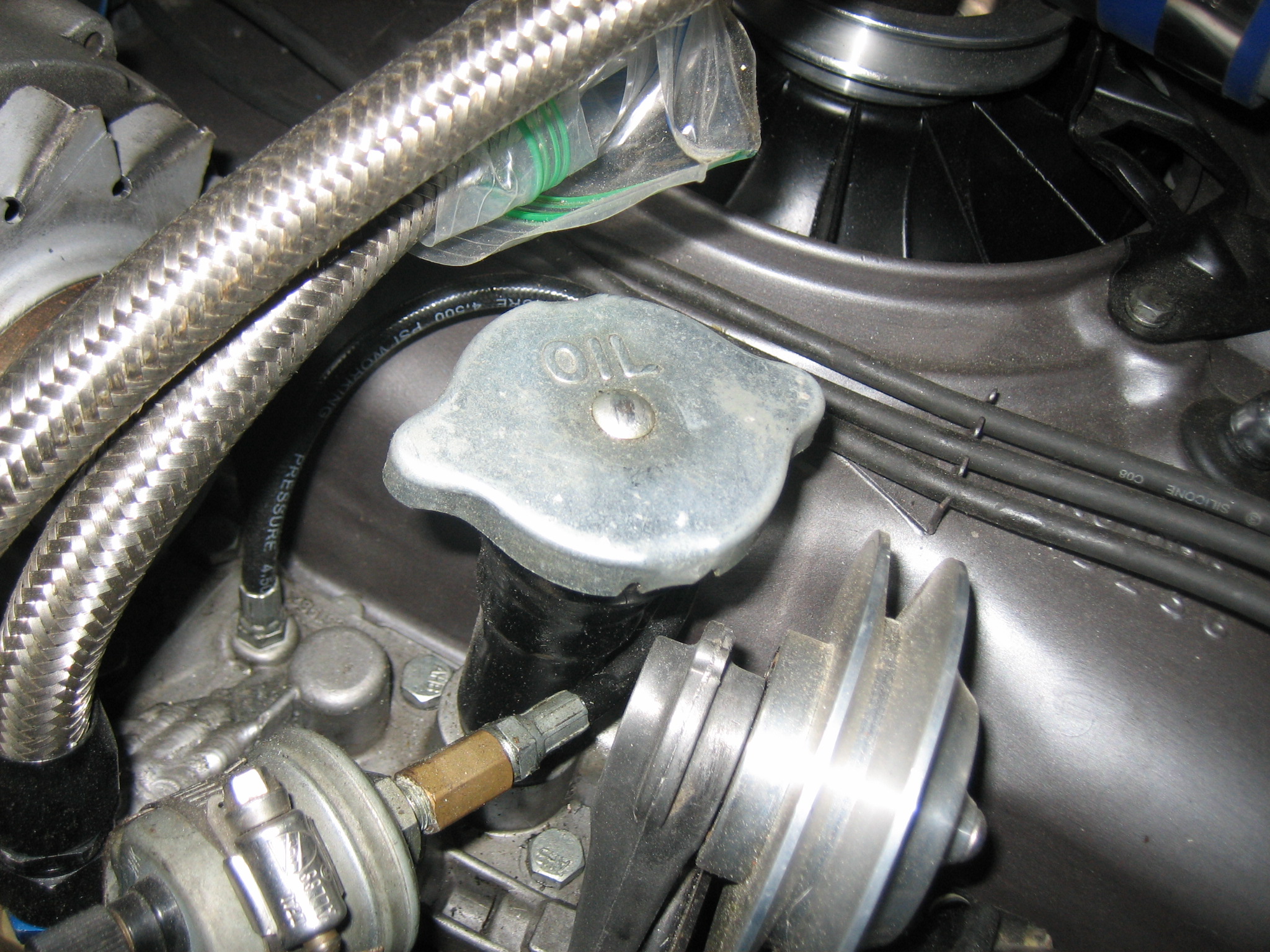

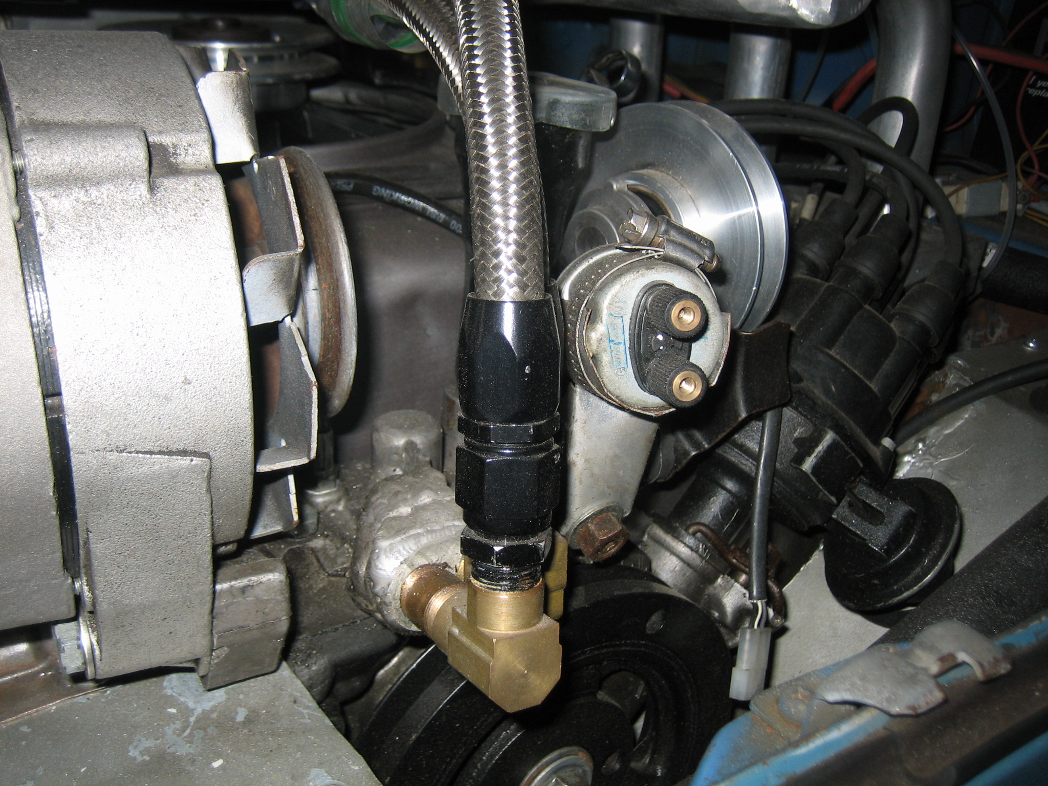

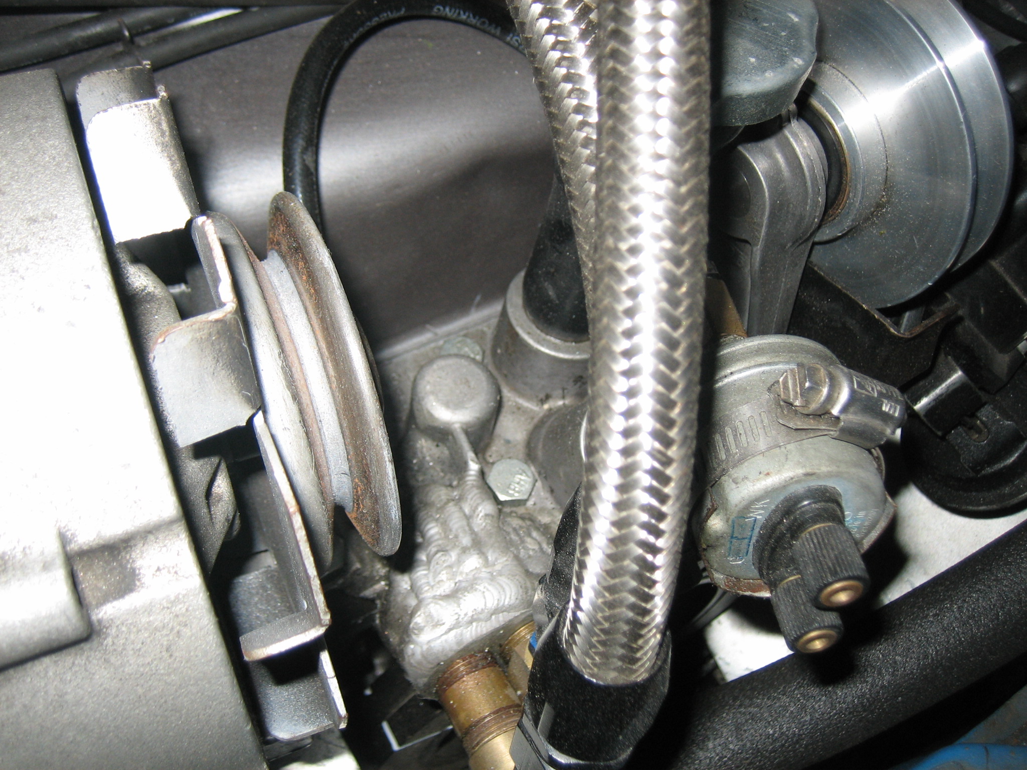

Here is my setup. I have the lines going to a thermostat and cooler.

Thanks, basically what I came up with yesterday. I will be using AN fittings, should have it together tomorrow.
Thanks for confirming I am on the right track.
