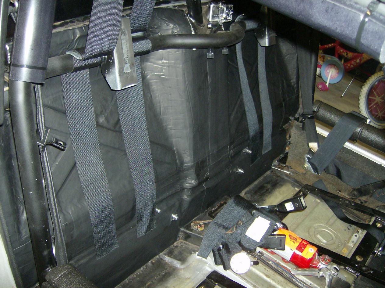

Added another layer of Damplifier (http://www.secondskinaudio.com) to the firewall. Mainly because it is now offered in in black

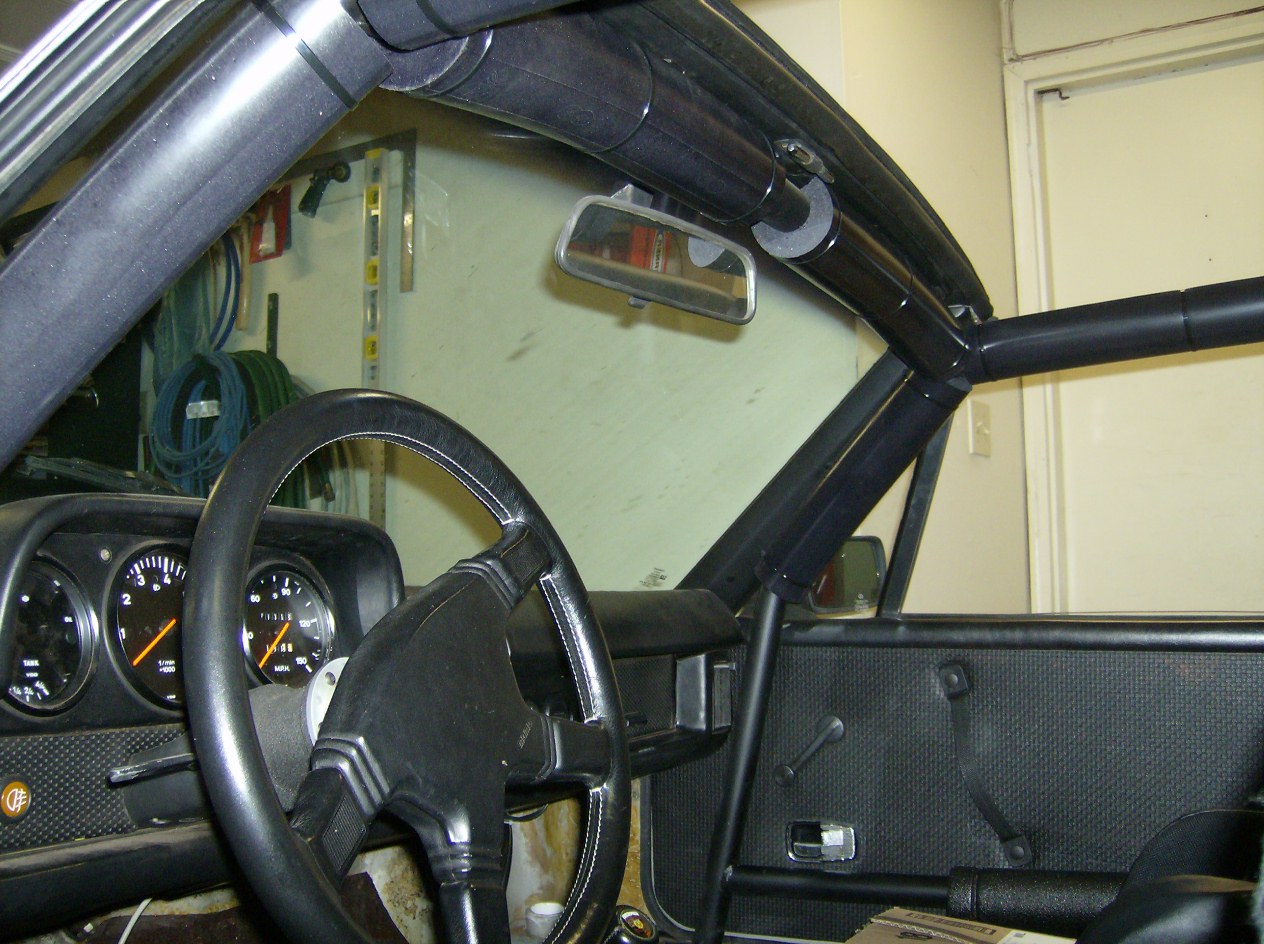

Changed out the roll bar padding to the "correct" SFI padding. I like the BSCI stuff (http://www.rollbarpadding.com) because it's just a little softer than the hard padding offered by others.

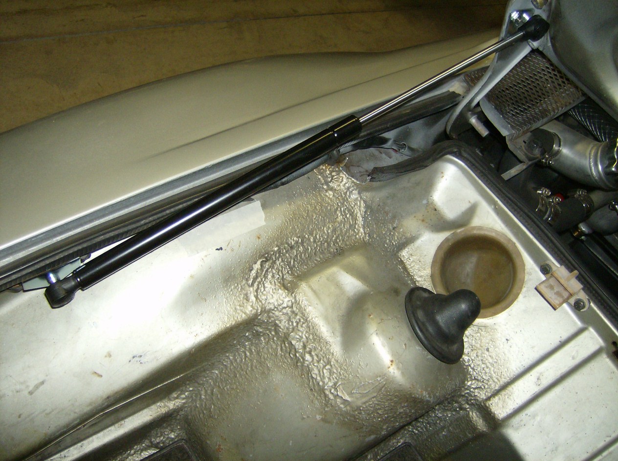

The previous owner had removed the trunk torsion springs for some bizzaro reason. I'd been keeping the trunk open with a wooden grade stake. Finally bought the CAMP914 trunk shock kit (http://www.camp914.com).
