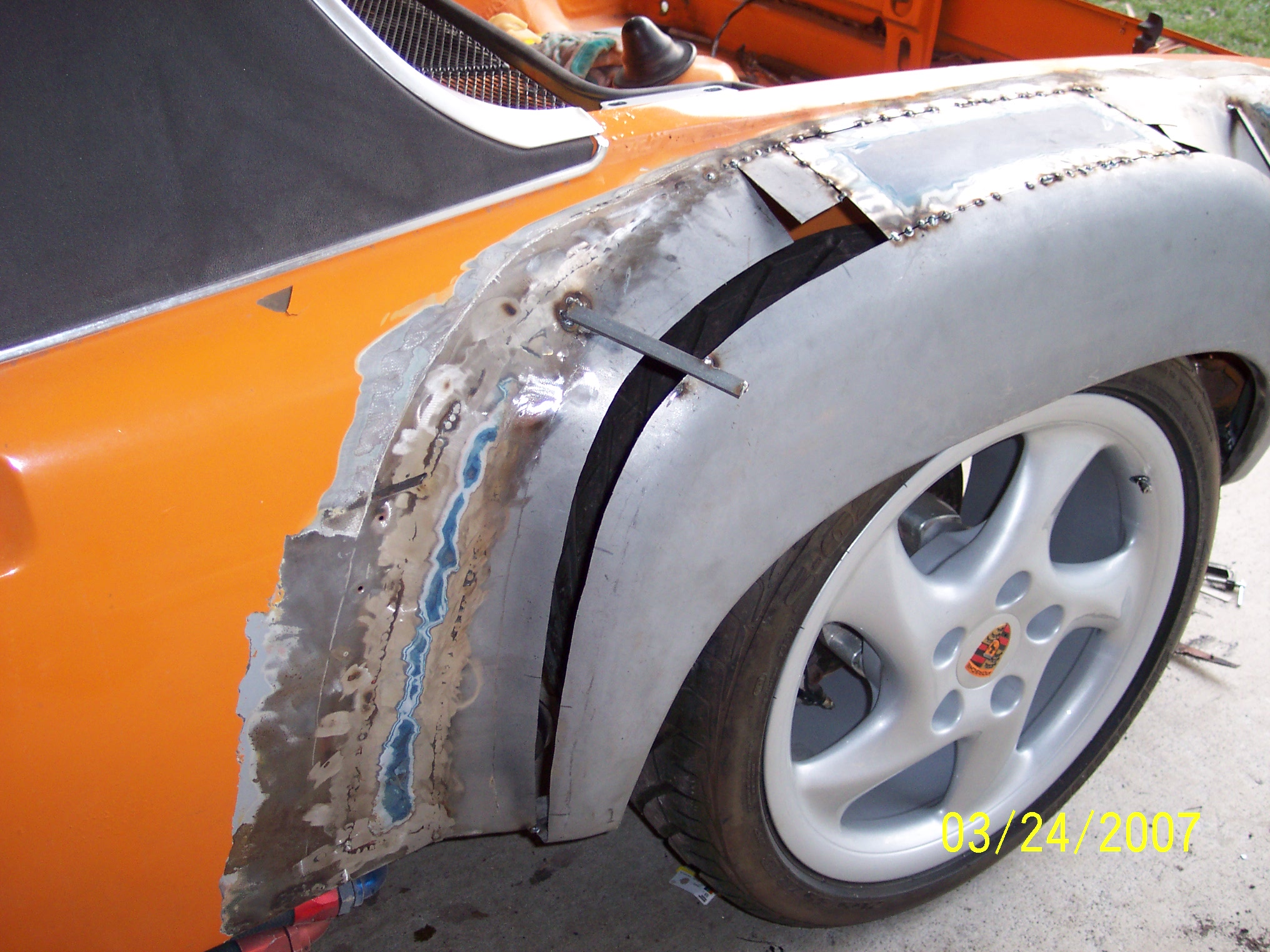

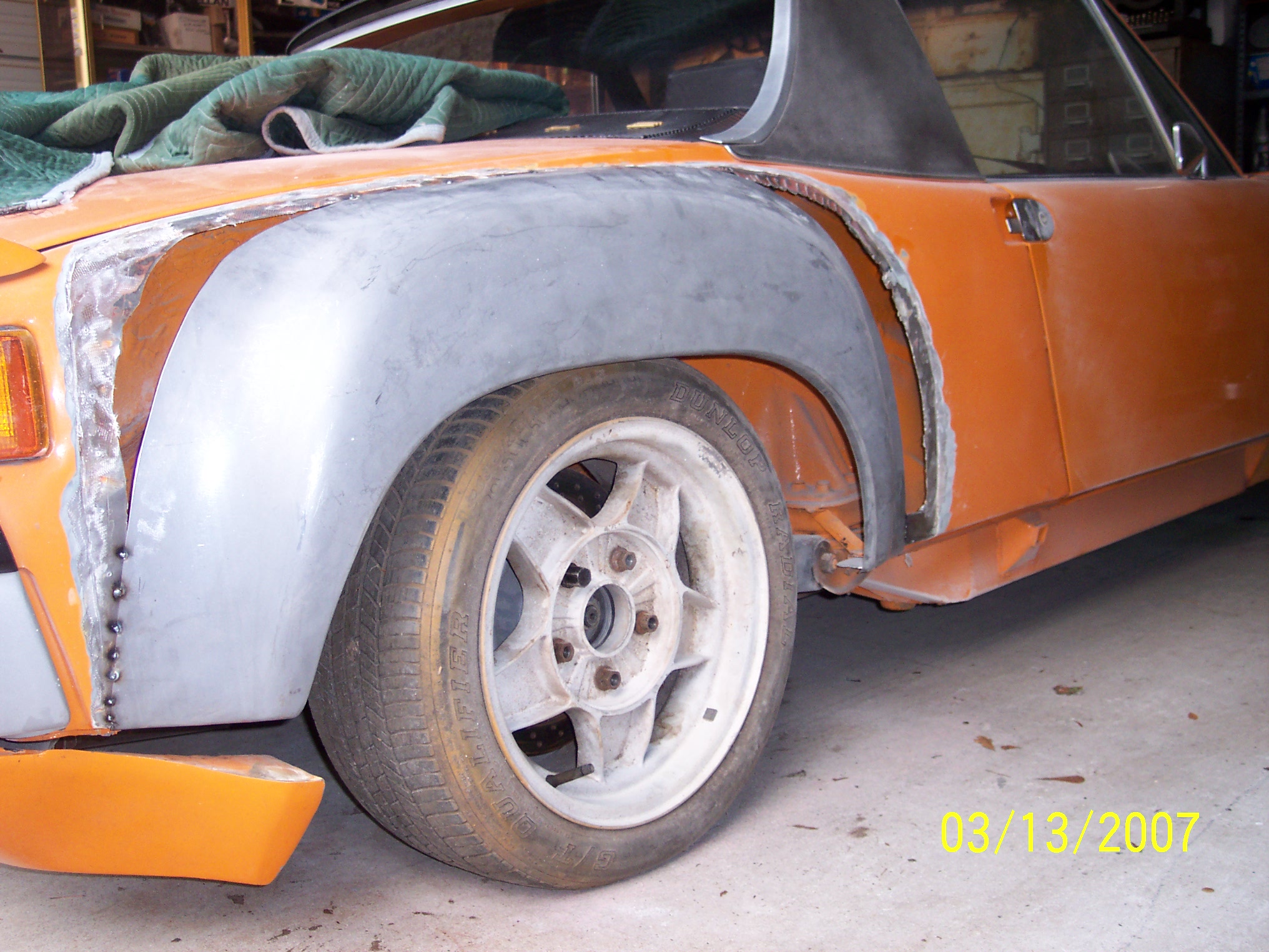

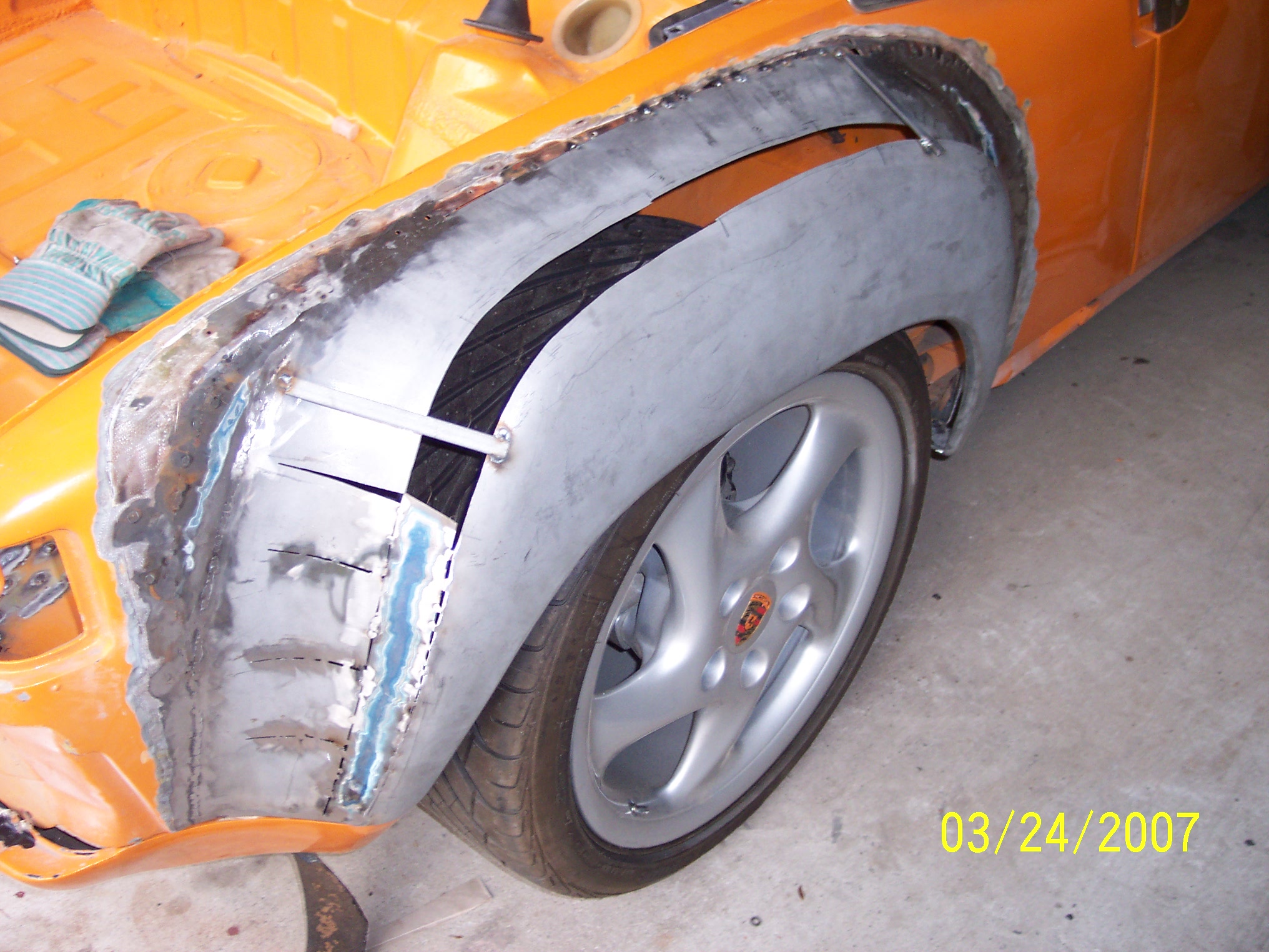

The bumpers were just painted with a semi-gloss black on the tops, and gloss silver enamel on the bottoms.
QUOTE(ruby914 @ Jul 4 2012, 06:13 PM) *
Yes, that's a very nice car Ron.
Nice work.
I did see someone section out the bottoms of the flares, maybe it was you.
It's still not too late for me to do the same, I like the look.
Are your rockers Getty Design? My thinking was, if they all fit like (IMG:style_emoticons/default/stromberg.gif) just get the cheap ones and make them work.
I am sure it helps with a good rocker to start with.
I did most all of the fit work on the flare bottoms. The rockers had a some what flat edge to them so I made the flares to match the rockers. The front spoiler, rear valance and the rocker panels were all AIR products. The front spoiler and the rear valance were heavily sectioned then bolted to the car, then re fiber glassed while in place to form to the car. Doing this removes the stresses on the panel when locked down and in operation. No worries about cracks or broken mounting ears after years of road use. The rockers were pretty much a bolt on only. They were bought for 11'' wide rear flares, so again when I fit the rear flares I made the ends match the rear end of the rockers. My flares were AA flairs also. They were a really good product to work with. They key is to take your time and get it looking the way it needs to look before you shoot the paint.
Ron
