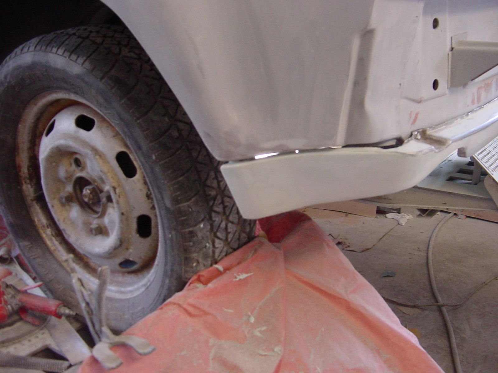

ruby914   Here is another photo of what I am up against. Ron...   Jul 5 2012, 12:12 AM

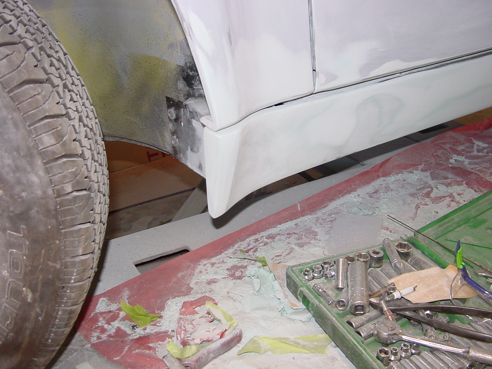

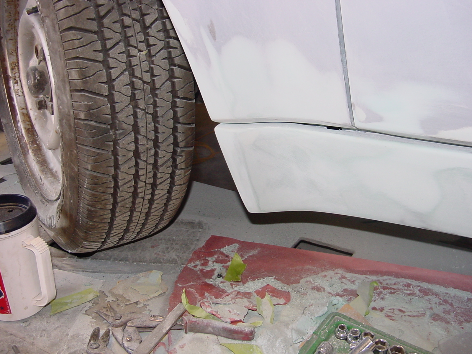

3d914   Here are examples of more conventional approaches ...   Jul 6 2012, 06:32 PM

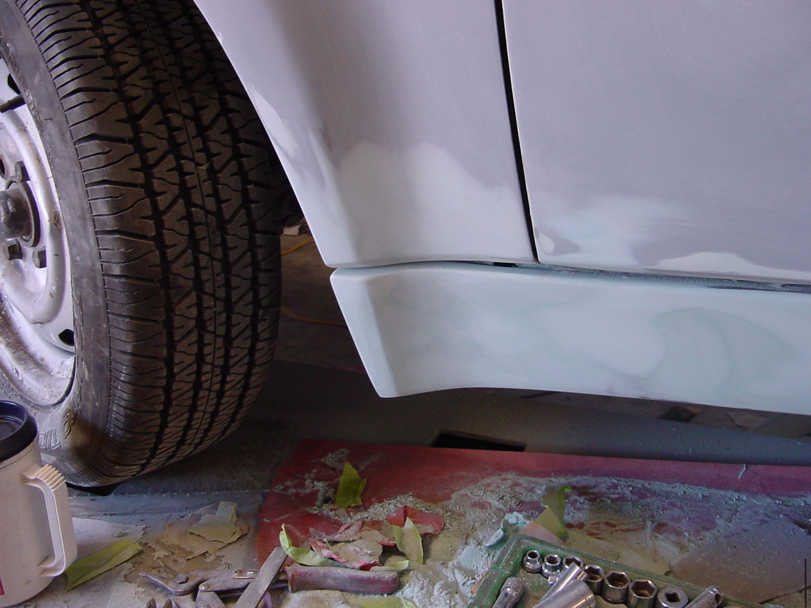

3d914   Here's a 914-6 in progress so we can see bette...   Jul 6 2012, 06:38 PM
ruby914   3d914, Nice collection of photos. The white car i...   Jul 7 2012, 01:45 AM

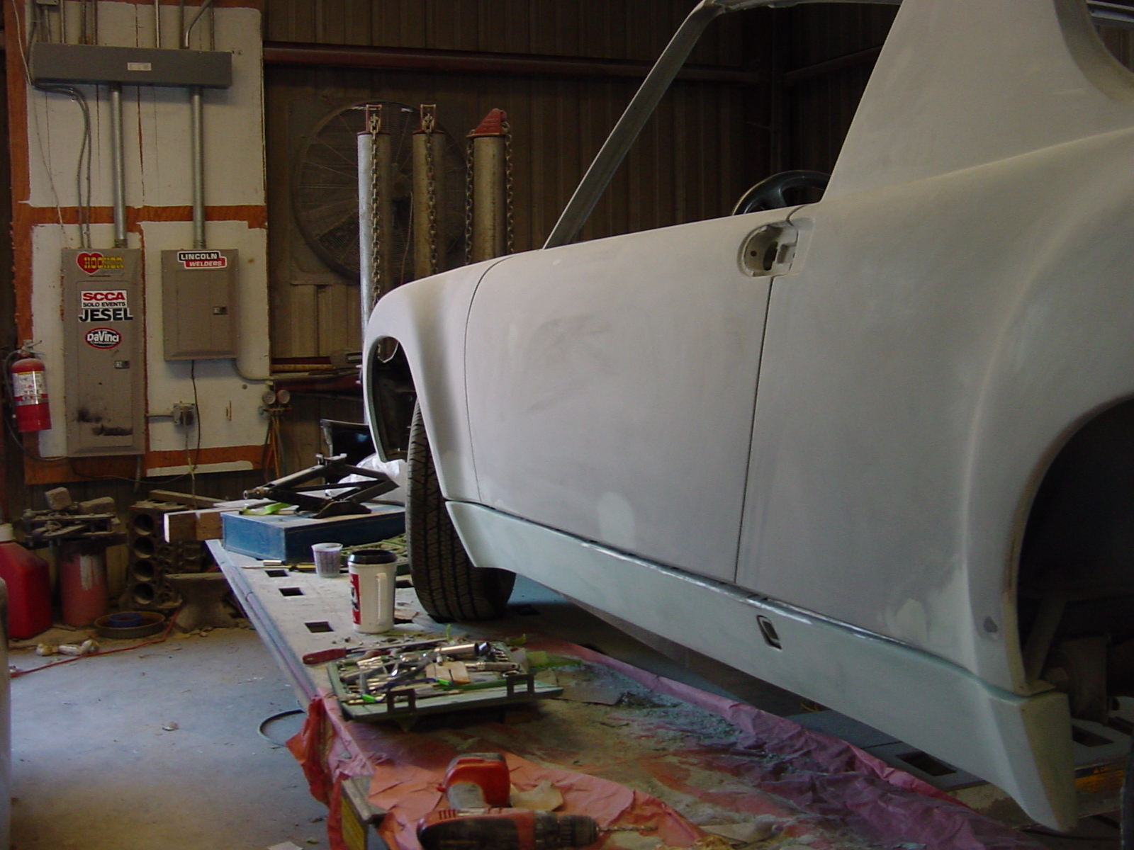

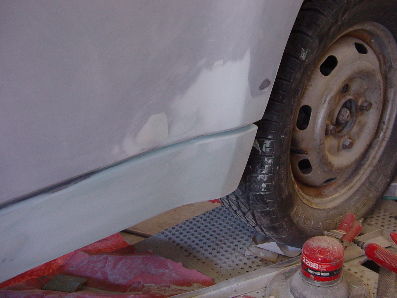

ruby914   Here is a fine example. I would like to see a fron...   Jul 7 2012, 02:13 AM
3d914   Ruby, that's looking pretty good. Can't te...   Jul 7 2012, 09:14 AM
