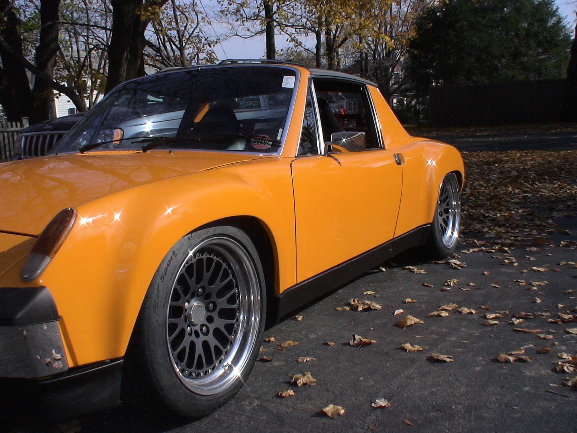

I got some budget rockers that (IMG:style_emoticons/default/barf.gif) needed lots of work.
First cut about 1" off the top and had to add 3/4" to the bottom.
Cut about 1/4 off the front but I still don't like how it flares out different than the body lines.
On the bottom of the door there is a bevel in the body that the rocker follows until it flares out. At that point the rocker flares as much as the body, not staying set in as much as the bevel. I am thinking it would look better If the rocker didn't flare out so much. Is that clear?
I would like to see how others have handled this trasition.

Here are examples of more conventional approaches - closing the gap between the bottom of the door and the rockers, but not changing the geometry of the door.
Close-ended flares with a minimal gap between the body and rockers, resulting a slightly large gap at the doors due to its chamfered outer edge.
Another example of the same.
Here's a 916 example where the chamfer & gap is more evident.
