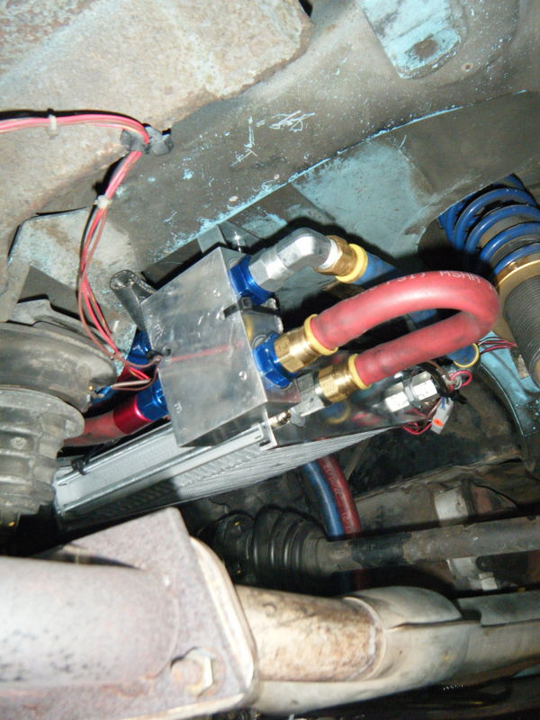

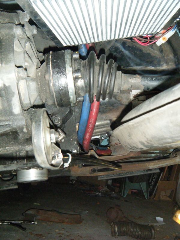

Here's a view from the back of the car. You can see the cooler at the top, and the lines from the engine in the background.
This shows the thermostat and lines to the cooler.

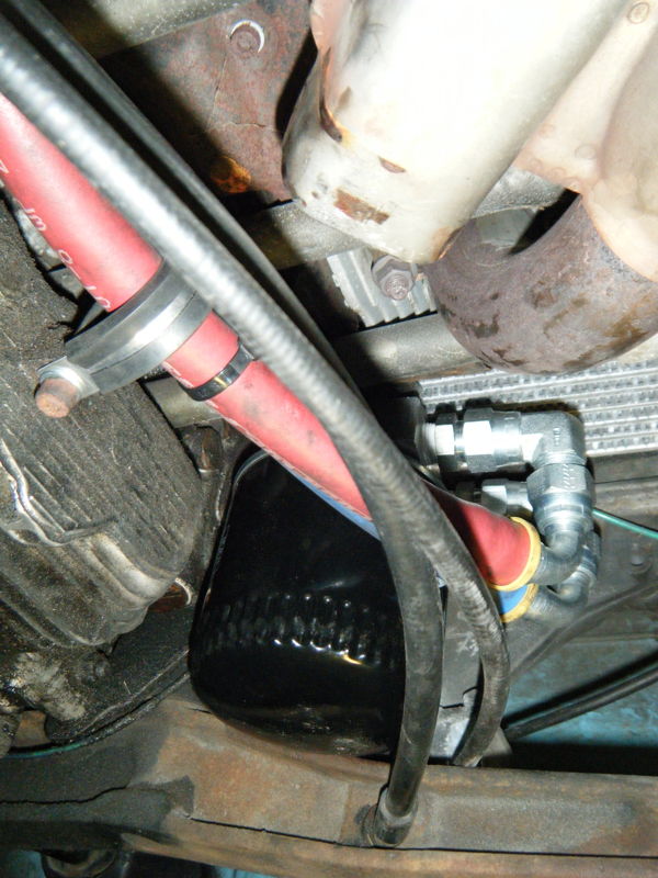

The sandwich plate and lines from the plate heading to the cooler.
I'm not completely satisfied with it (not enough Adel clamps, too many zip ties), and it seeps a little where the hot line to the cooler connects to the thermostat. But it's done. The fan is hooked up to a switch in the center console. It should (hopefully!) be effective at keeping the oil temps under control.
