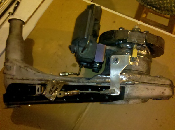

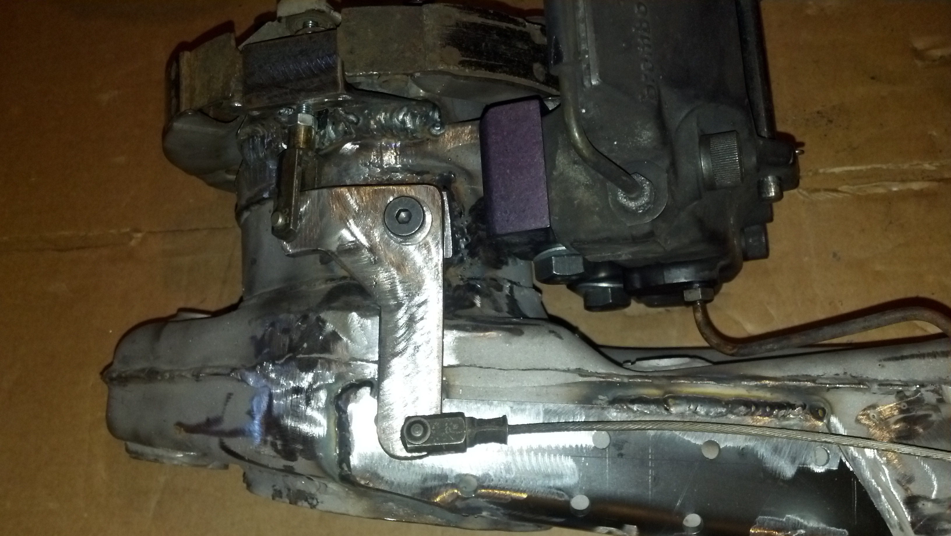

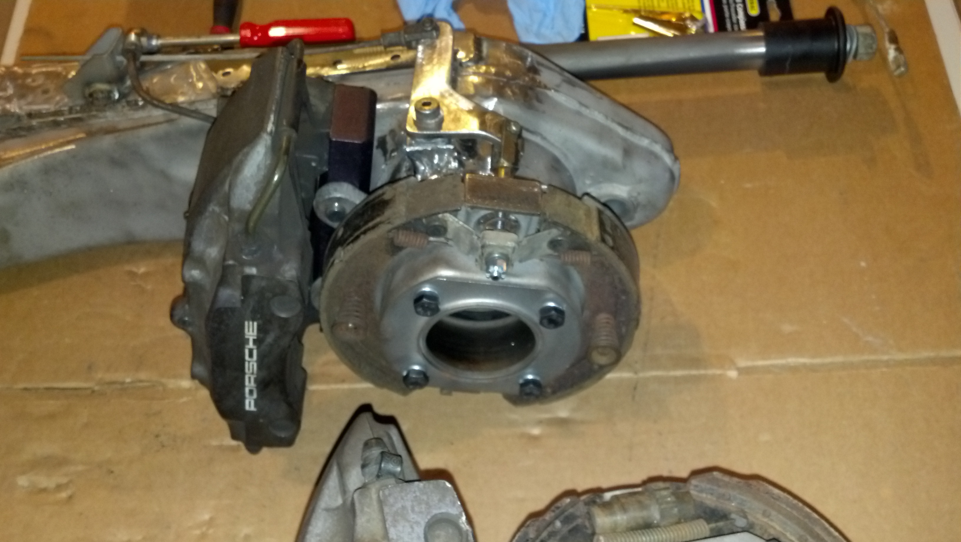

I have the same setup as Andy but I installed the early 911 e-brakes on the rear.
It wasn't too bad had to measure alot to get things just right with the lever mounts.
I also had to make a small cable to attach to the 914 e brake cable.
I took a look at my caliper pistons like Aaron brought up . The rear calipers bolt right up ( small piston to the top ) as for the fronts they need to be flipped ( right now larger piston is on top ) .

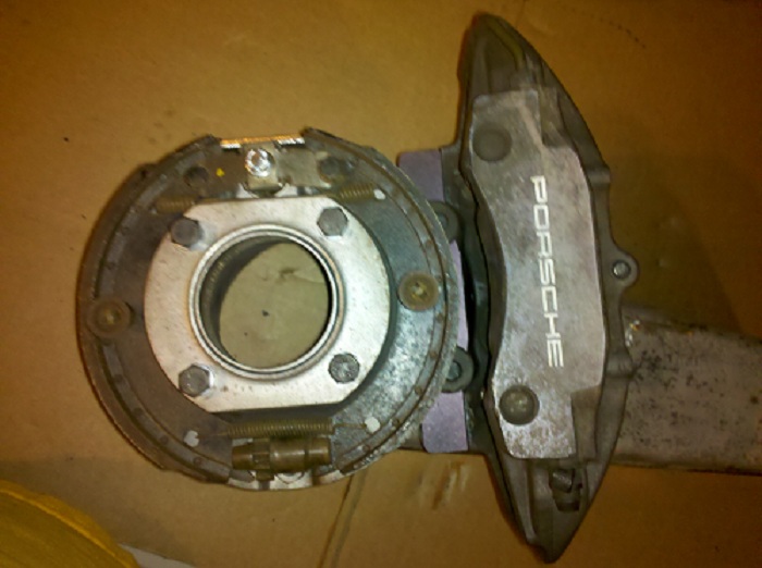

Luke M   I have the same setup as Andy but I installed the ...   Jul 9 2012, 06:47 AM

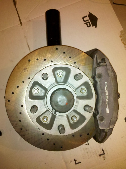

CptTripps   So here I go digging up an old thread, and digging...   Aug 30 2013, 01:28 PM
Luke M   I just checked my calipers and this is what I have...   Aug 30 2013, 04:00 PM
CptTripps   I think you may have a set of fronts on the rear.....   Aug 30 2013, 05:15 PM
