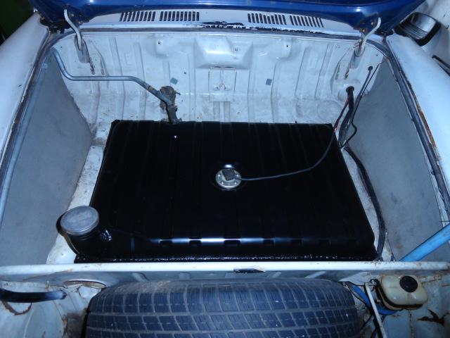

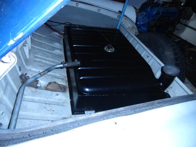

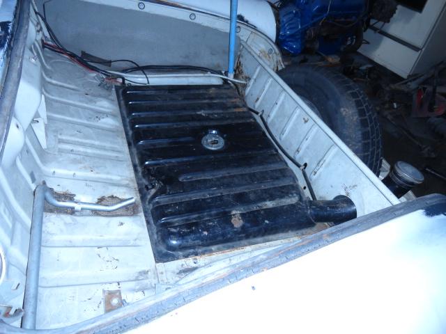

Last Friday, I cleaned and treated the new tank with POR-15 tank treatment to seal and treat the rust and any minor pin holes that may have been present after all the welding. It has to cure for a full 4 days afterwords, so on Saturday, I painted it and under coated the bottom, added a new fuel sock screen and a new petcock.
Today was the swap-out day. I had to remove the breather tube and do some minor surgery to it to make it fit the new height so a low point was not created and block proper breathing.
Before:
(IMG:http://www.914world.com/bbs2/uploads_offsite/images.thesamba.com-9730-1341873464.1.jpg)
After:
(IMG:http://www.914world.com/bbs2/uploads_offsite/images.thesamba.com-9730-1341873464.2.jpg)
(IMG:http://www.914world.com/bbs2/uploads_offsite/images.thesamba.com-9730-1341873465.3.jpg)
I added 2 gallons from a can I had, then proceeded 1 mile away to the filling station where I proceeded to top it off with an additional 17.2 gallons. I was expecting somewhere around 17 gallons total, so i was a bit surprised when the total ended up being 19.2!!.
No leaks (whew!) due to the POR-15 sealer I'm sure. (IMG:style_emoticons/default/biggrin.gif) As was expected, the car has a heavier feel at the wheel at slow speeds due to the added weight right over the front wheels, but it's not excessive and the added weight where I need it going into a corner will be welcomed. I plan to auto-X this car and hopefully use it on an occasional track day.

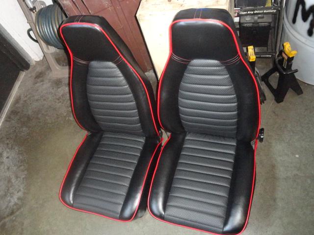

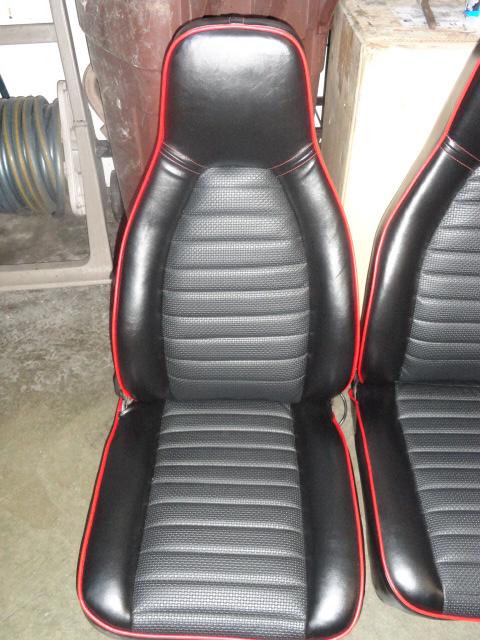

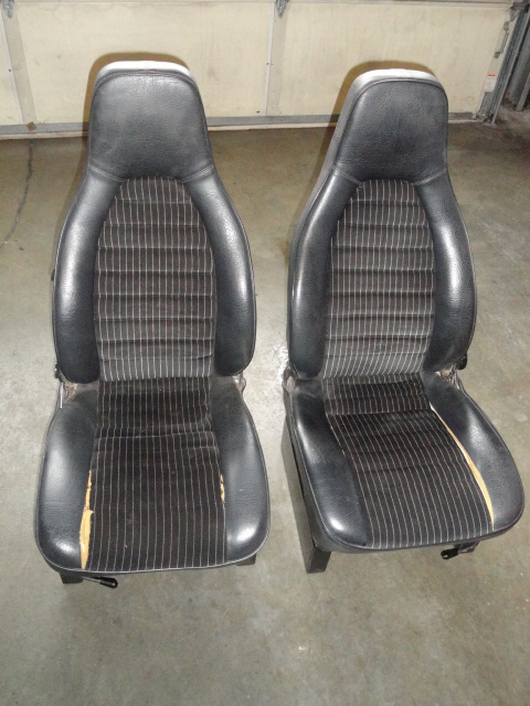

Got my Porsche 911 seats back from the upholstery shop this morning. I’m lovin’ how they turned out. We used stock VW black basket weave for the inserts so they look more at home in the VW. Then I chose red welting and stitching to accent the black. The car will be painted hot rod black with red pin stripping so these should accent the final look really well. I do like the clean look of the stock, low-backs, but these are safer and if I kept the low-backs I would never be able to get it the car onto a race track in the future.
I had seat heaters installed so this winter my wife should be comfy and I should hear no complaints.
Before:
(IMG:http://www.914world.com/bbs2/uploads_offsite/images.thesamba.com-9730-1341873465.4.jpg)
After:
(IMG:http://www.914world.com/bbs2/uploads_offsite/images.thesamba.com-9730-1341873466.5.jpg)
(IMG:http://www.914world.com/bbs2/uploads_offsite/images.thesamba.com-9730-1341873467.6.jpg)
