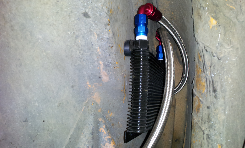

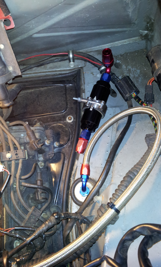

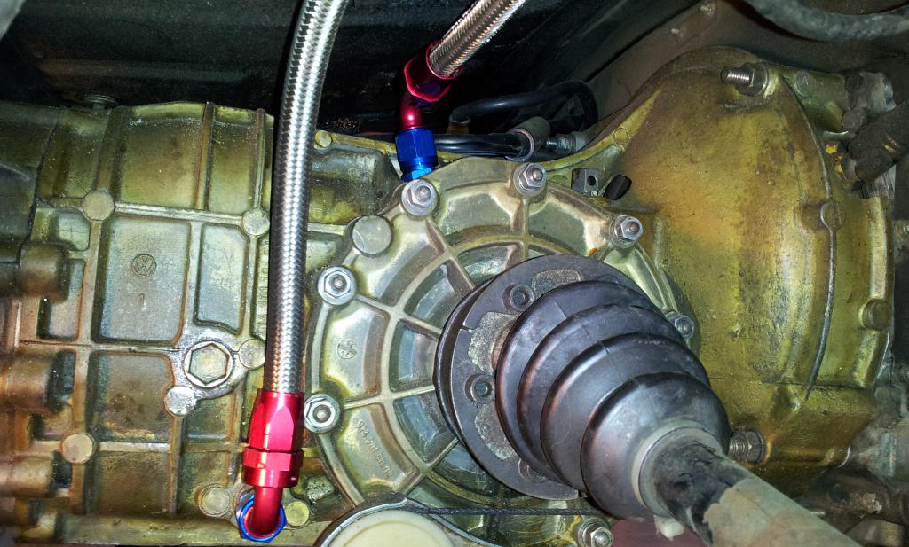

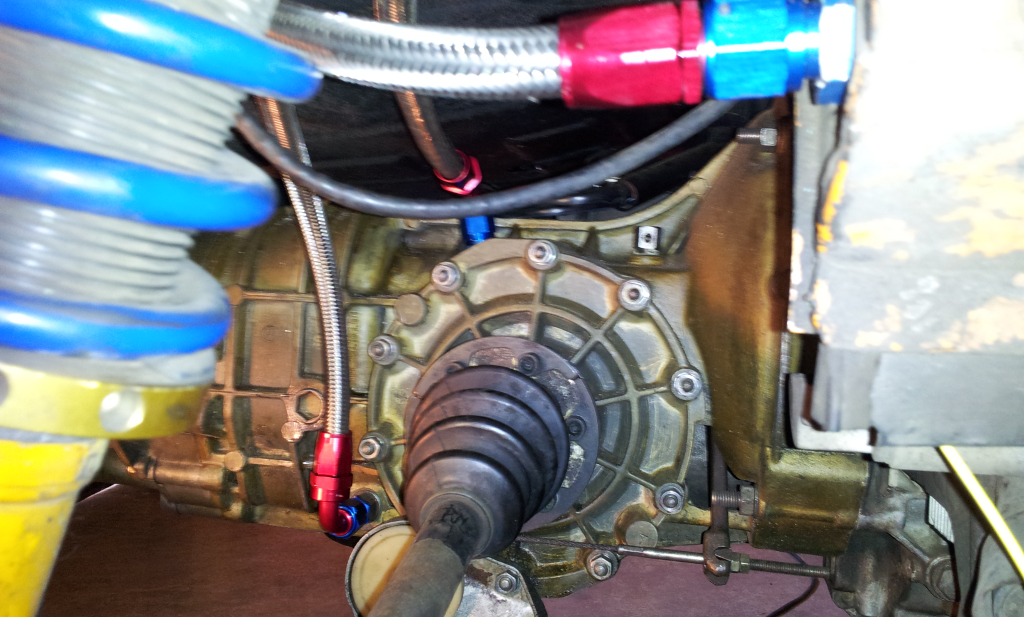

Finally time for an update. I forced myself off of the road because two weeks of consecutive 100+ temperatures reminded me that I hadn't installed this cooling system into the car. Attached are photos of the installation. I'm running the wire for the temperature sending unit after lunch today but everything works with no leaks.
Total system capacity worked out to be 3.75 quarts.
I have a 7in. Spal fan in the engine lid above the pump to help move more air into that side of the engine compartment. If the cooler can't move enough heat out of the fluid in the right rear fender well, I'll cut a hole into the engine compartment next to the cooler and force air out over the cooler. But I suspect the cooler will shed enough heat for me not to worry about it... unless it starts to bake my paint!
More below...
