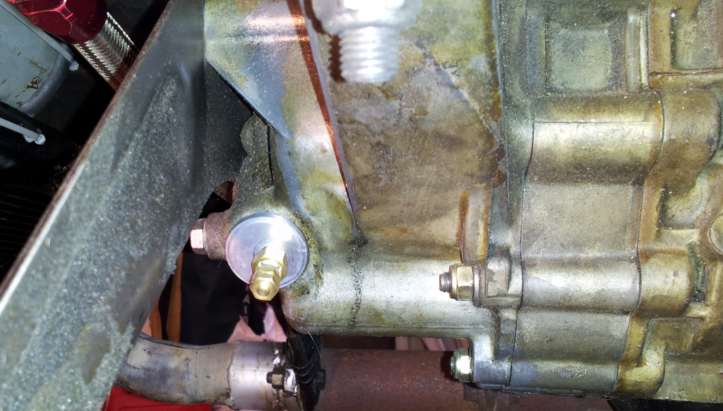

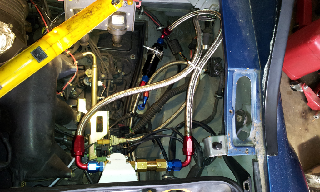

The engine compartment plumbed and the temperature sending unit installed into my speedometer block-off plug.
