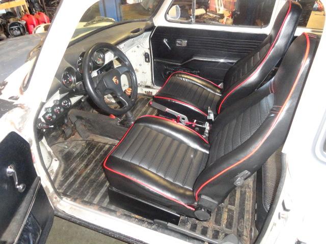

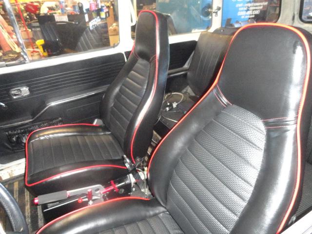

I finally got the chance to install the new seats. Man are they comfy!! My seating position is a lot better and they are mounted about 1 inch lower than the stock seats. This helps the viewing of my gauges and lowers my center of gravity (which can't be a bad thing since I'm a big guy).
(IMG:http://www.914world.com/bbs2/uploads_offsite/images.thesamba.com-9730-1342051725.1.jpg)
(IMG:http://www.914world.com/bbs2/uploads_offsite/images.thesamba.com-9730-1342051726.2.jpg)
