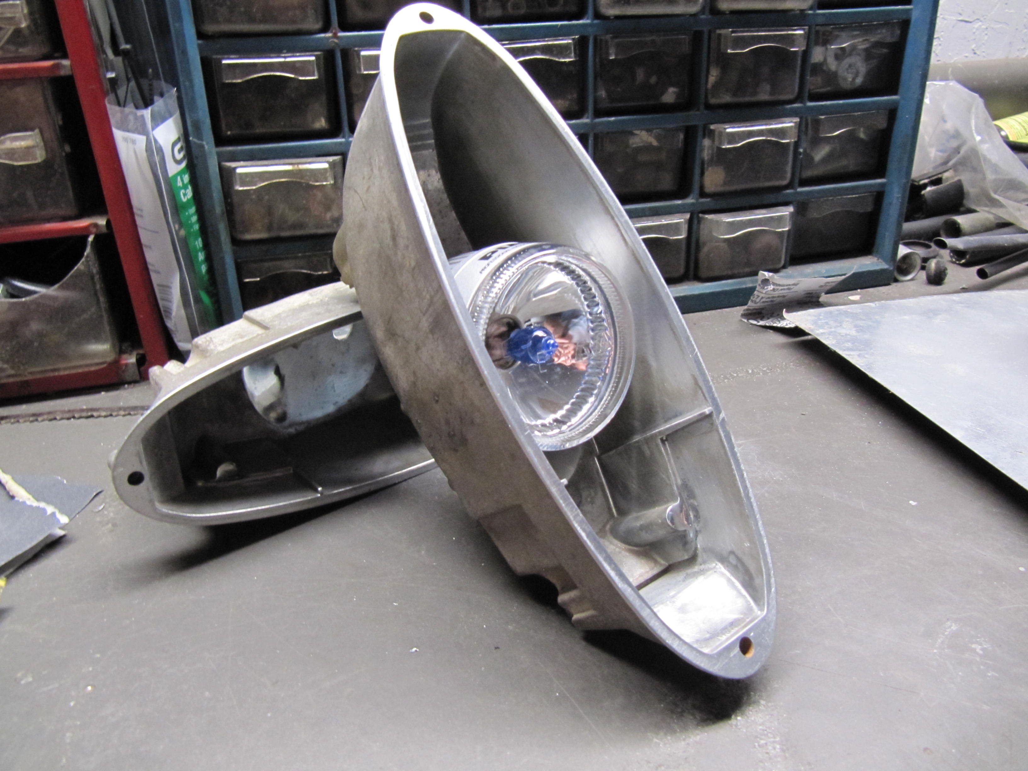

I ground down the back side just enough so that it barely sticks out past the horizontal plane of the outside of the bucket. Yes flat lexan will be coming my way. They are snug in there.

Krieger   I got my light and trimmed the plastic housing on ...   Jul 17 2012, 08:49 PM
Black22   Where's the pic of the light IN the turn bucke...   Jul 17 2012, 08:51 PM
Krieger   I ground off 6 protrusions (they look like tits on...   Jul 17 2012, 08:56 PM
Krieger   I ground down the back side just enough so that it...   Jul 17 2012, 09:01 PM

Krieger   This has been done for a while. Buckets polished ...   Nov 29 2012, 08:23 PM
Krieger   The headlight is snug in there. If I wanted it to ...   Nov 29 2012, 08:31 PM
Krieger   Flat Lexan cover, cut on band saw. Belt and hand ...   Nov 29 2012, 08:33 PM
Krieger   Oops double post. :beer3:   Nov 29 2012, 08:41 PM
Krieger   I used the rubber grommet from the PIAA lights on ...   Nov 29 2012, 08:44 PM
Krieger   I put some of the original PIAA plastic tubing and...   Nov 29 2012, 08:45 PM
