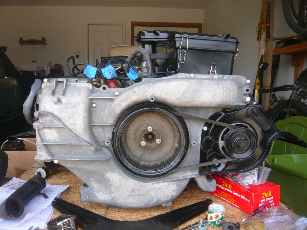

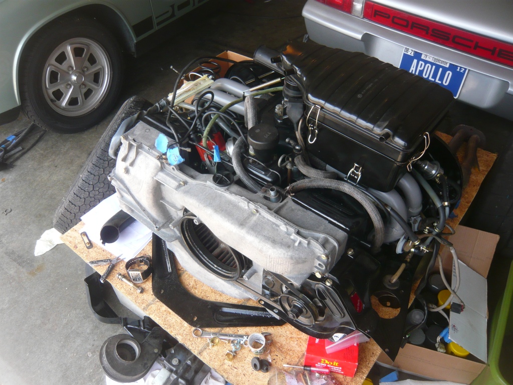

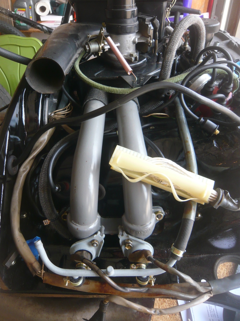

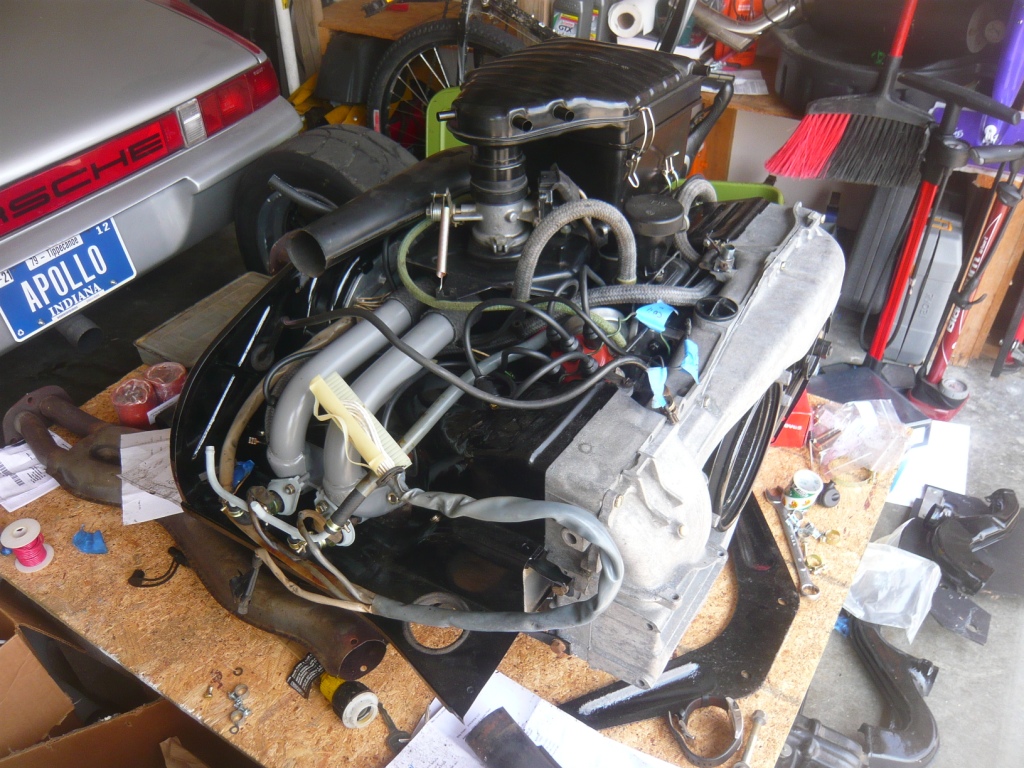

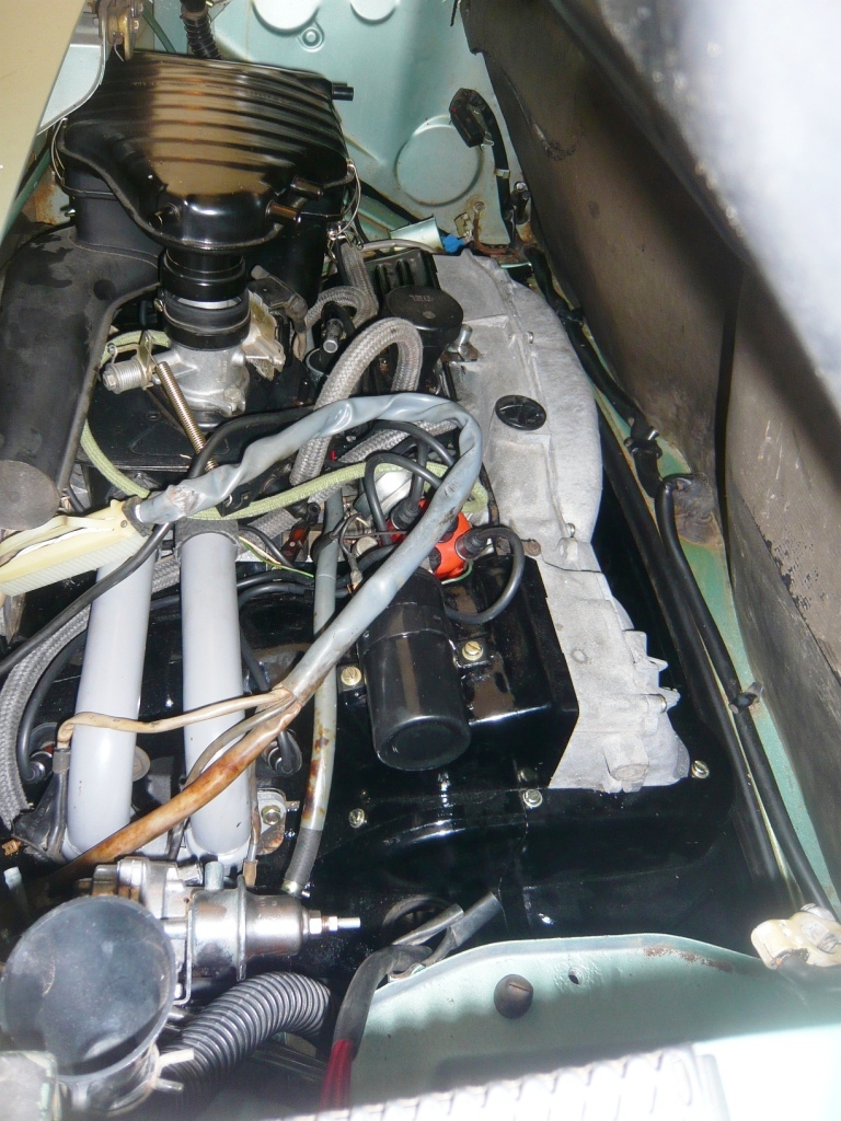

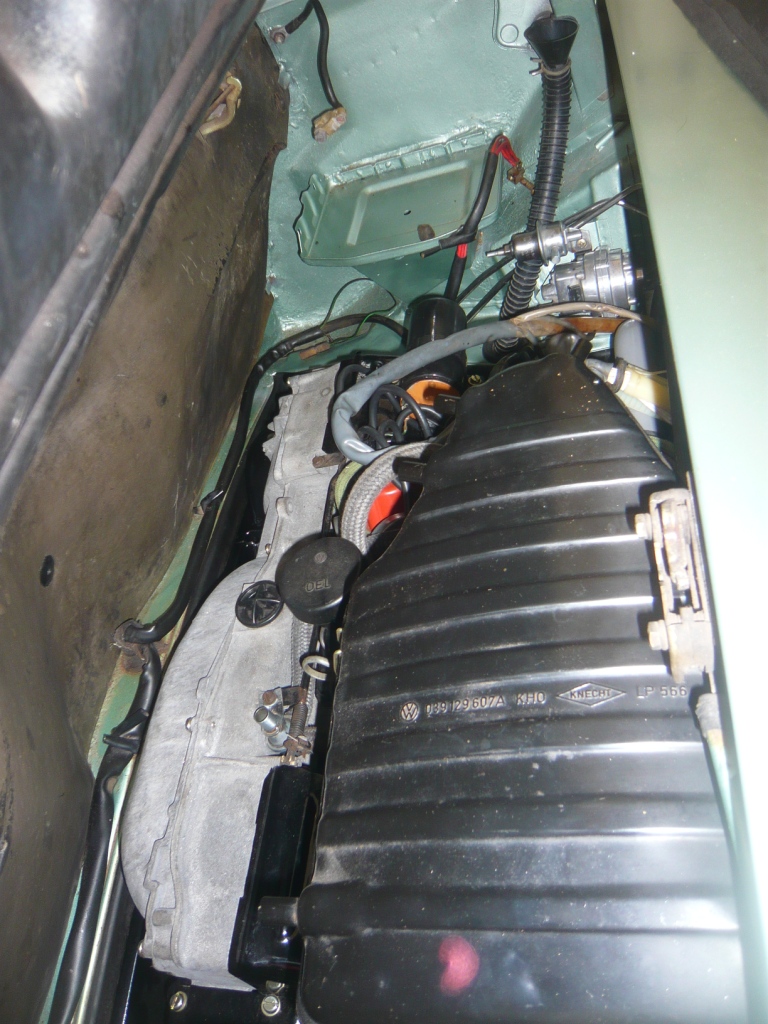

I finished Installing the engine along with the newly painted tins and started her up. There were a few problems; first, the accelerator cable had broken, and was very difficult to remove (I ended up cutting the shank off the cable to remove). To install the new cable I cut 1/4" off the end of the cable and it slid in with much less difficulty. The length is almost too short, but is workable.
Second, the oil pressure idiot light was not turning on with the engine not running. The switch had stopped working. I removed it and polished the contacts and it worked again, but its time to order one from pelican.
Also, one of the fuel injectors was leaking from the injector body itself. The leak eventually stopped, but I ordered 4 NOS injectors from Otto's in California anyways.
Last weekend I drove the car to Porsche's 2 Ohio in Granville. A total of 600 miles or so and it ran without a hiccup. The E-brake seems a bit loose though, so that will need a checkup soon.
Now Pictures.
