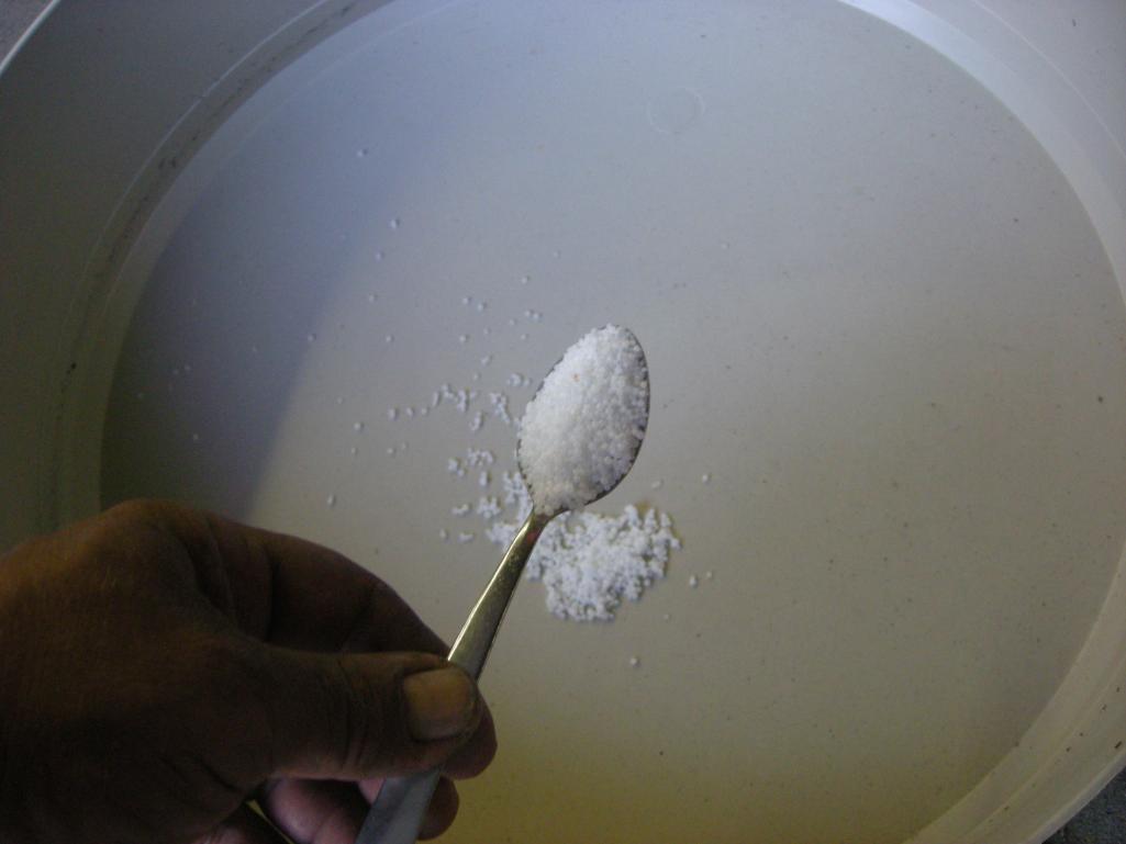

I'm using a very weak solution, 4 heaping teaspoons to about 2 gallons (10L) of water.
Takes about 30-40 minutes to strip the anodizing. I could add more and speed up the process but this is working for me.
BTW if you did forget about your rim, say overnight, you most likely would find a puddle of goo the next morning. Even this weak you can see the aluminium coming off.
This stuff is caustic so use proper safety gear and have a good supply of water on hand.
Of course I have my safety flip-flops and shorts on (IMG:style_emoticons/default/rolleyes.gif)
