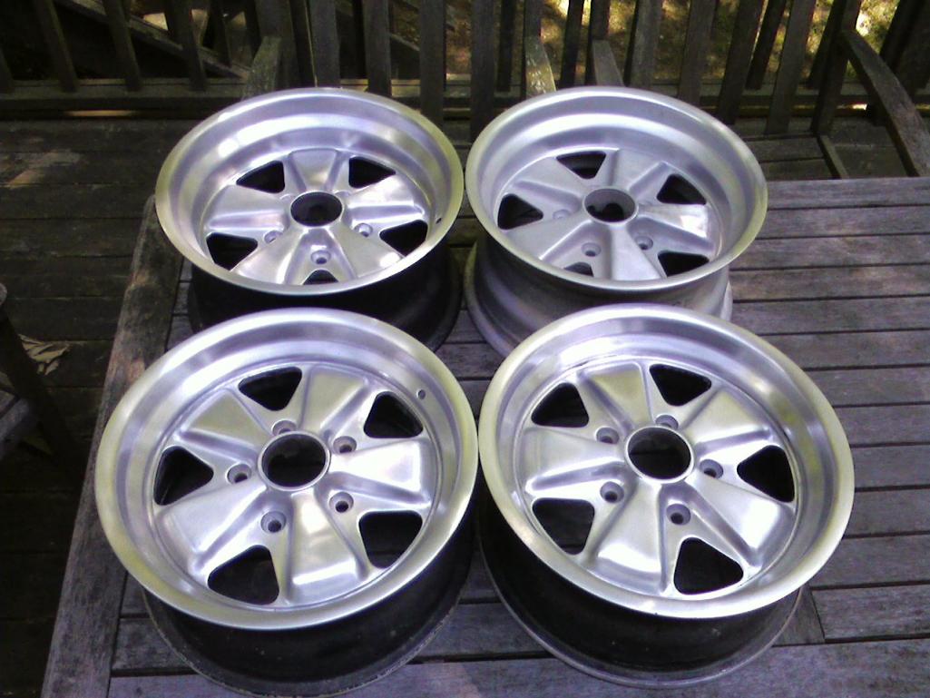

So I'm doing the RSR treatment to my straight but cosmetically challenged Fuchs.
First I stripped the anodising from one wheel using a caustic soda (also known as lye or Sodium hydroxide) solution, it takes off the anodizing like a champ, but hardly touches the old paint. Bottom left rim first pic has been in the caustic soda . So it was off to the hardware store for some stripper.
The stripper worked, but I had to take off the paint leftovers with the bead blaster (last pic).
They are going back into the caustic soda solution again tonight to get rid of the rest of the anodizing.
I love the finish, it has me debating whether to leave them like this or to paint the usual black background. (IMG:style_emoticons/default/idea.gif)

I used a heavy duty scotch brite pad on mine. Looks like brushed stainless. Cost less than $5 and I can always polish or paint in the future. Future touch up should be easy. Have to dig up a pic.

Mark Henry   I'm using a very weak solution, 4 heaping teas...   Aug 7 2012, 07:58 PM
Mark Henry   Here you can see the smut rising (that's alumi...   Aug 7 2012, 08:01 PM
Mark Henry   This is my stir stick/test strip, a scrap piece of...   Aug 7 2012, 08:05 PM
Mark Henry   Fuchs rims are not just aluminium they are an allo...   Aug 7 2012, 08:15 PM
Mark Henry   This picture the rim on the right you can see how ...   Aug 7 2012, 08:47 PM

Mark Henry   Just a few notes, I changed my solution after 2 ri...   Aug 7 2012, 10:28 PM
