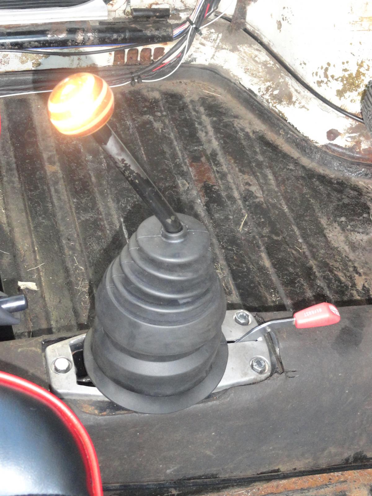

Last weekend I attended John Walker's annual Porsche swap in Seattle. I scored a perfect '72-'89 Porsche 911 shifter. This is the original style of shifter that was used with my 912E (923) 5-speed. Until now I have been using a slightly modified '73-'76 Porsche 914 shifter and while it worked well, it lacked the reverse lock-out of the 915 style shifter. However this style if shifter is no bolt-in part. I had to cut the ball off the bottom of this shifter and weld on the linkage mount off the 914 shifter in order to have the shift pattern right. Then I had to carefully cut a window behind the shifter tower so that I could access the shift adjustment bolt. Then I also had to cut a slot in the front and shave down some of the right fwd edge in order to continue to use my Porsche heater switch. Viola!! Smoother, even ore positive shifting with reverse lock-out!!
(IMG:http://www.914world.com/bbs2/uploads_offsite/images.thesamba.com-9730-1344565430.1.jpg)

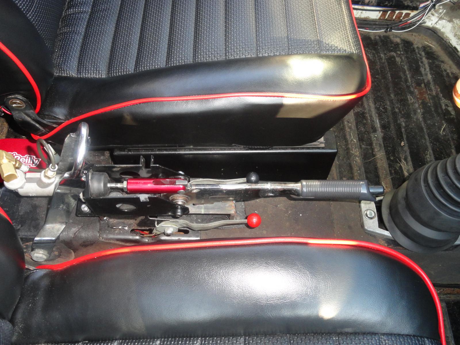

Next was the e-brake handle. Since I upgraded the rear brakes using 914 rotors w/ 912E calipers, I had to switch to a hydraulic e-brake. The lock ratchet worked O.K. (barely O.K.) but needed both hands to dis-engage. I figured at first, no big deal. But after a couple months driving it, I really got tired of 2-handing the brake handle. So my solution was to shorten the handle 4" and add a boss to the top that would work the piston of the slave cylinder. I also shortened the actuator arm to get it to all fit and work like a stock e-brake, but this one REALLY grabs the brakes now!!
(IMG:http://www.914world.com/bbs2/uploads_offsite/images.thesamba.com-9730-1344565431.2.jpg)
