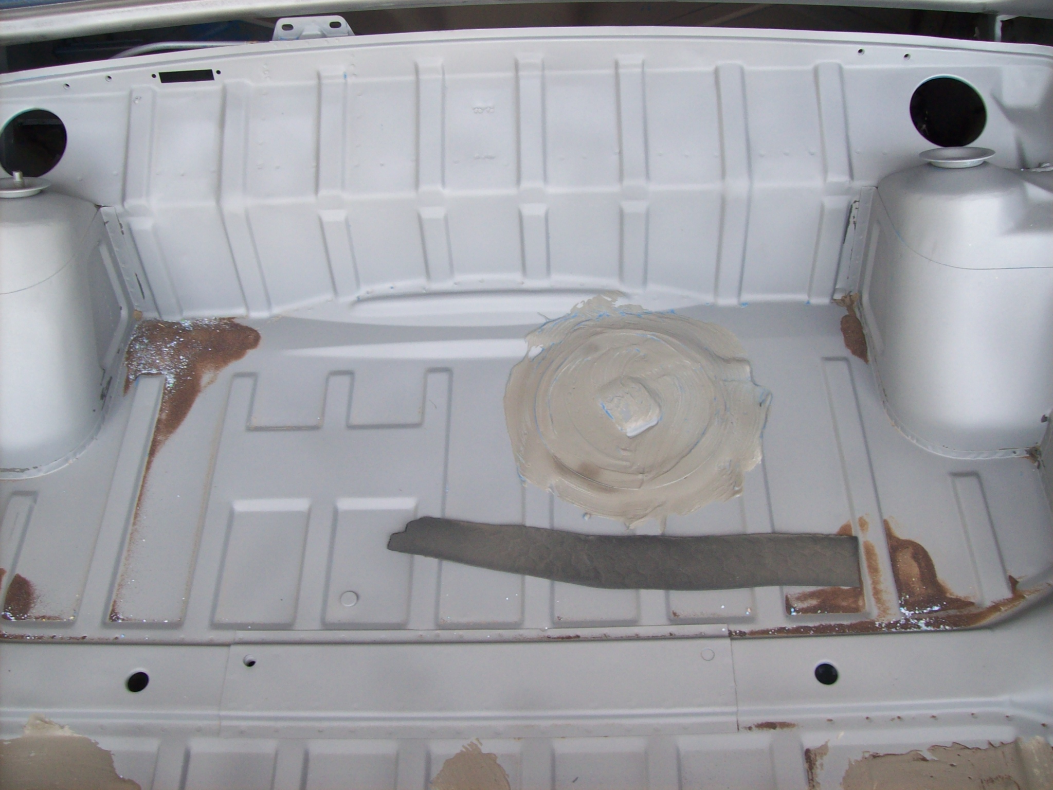

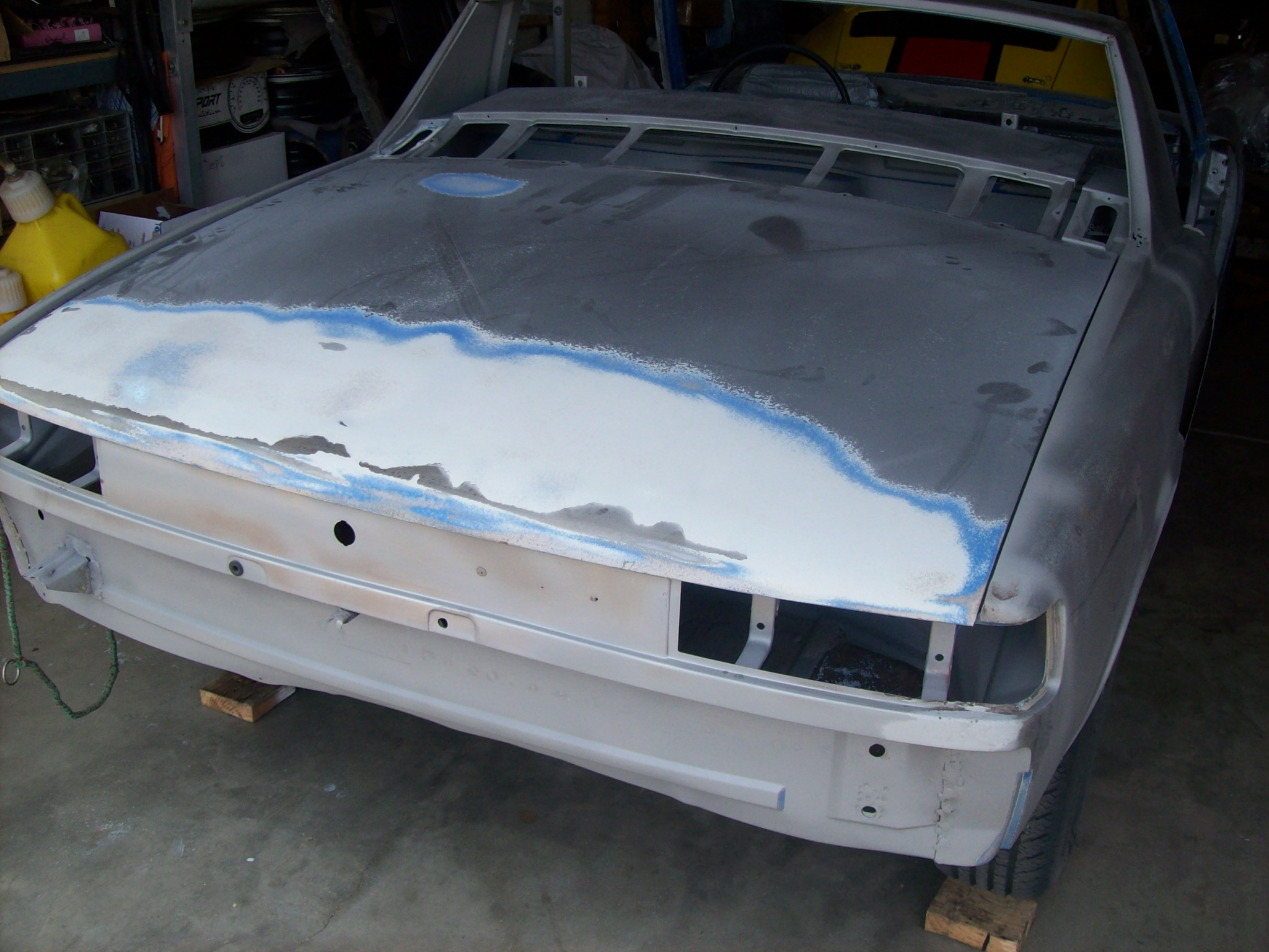

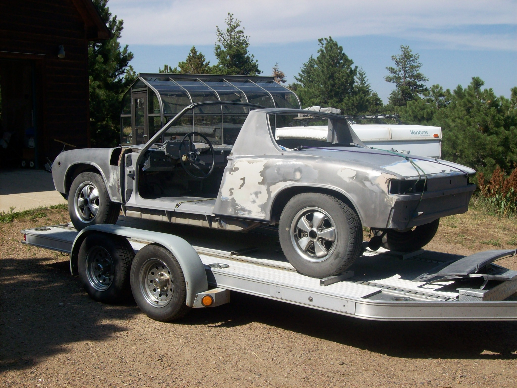

The car came back form the blaster and there were no real surprises. Two different kinds of media used, heavy for the inside and lighter for the outside. AS usual, when you think the body has only one spray, you find underneath the paint, areas of bondo which obviously means not only resprays, but also body damage at some point. Here is what we looked like coming home...

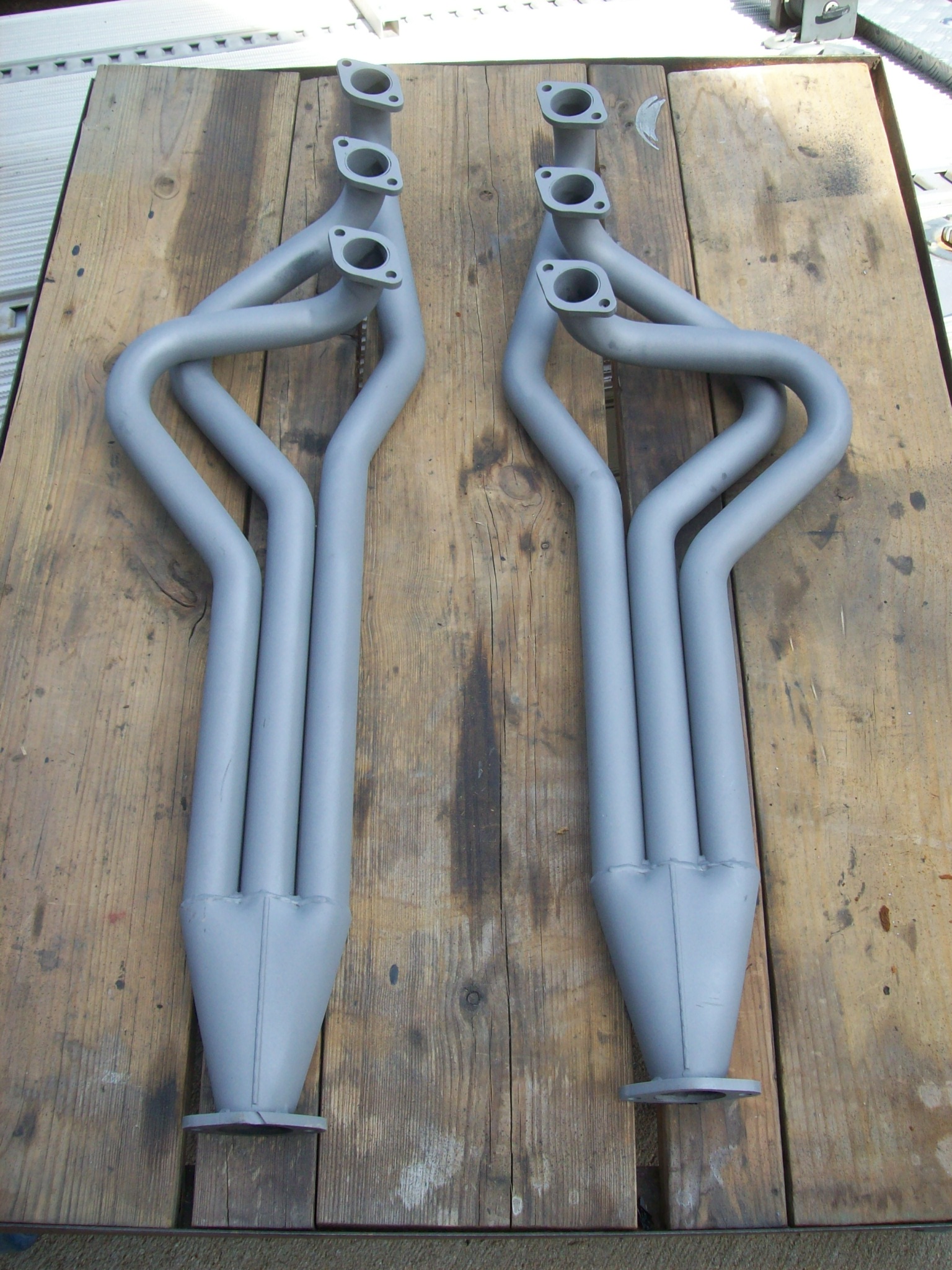

I also had the headers cleaned up. These will get hot coated and sold. I have sourced a nice pair of heat exchangers in their place
Here are some of the areas that "came clean"
