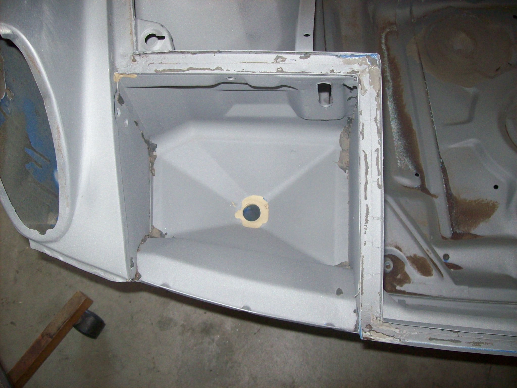

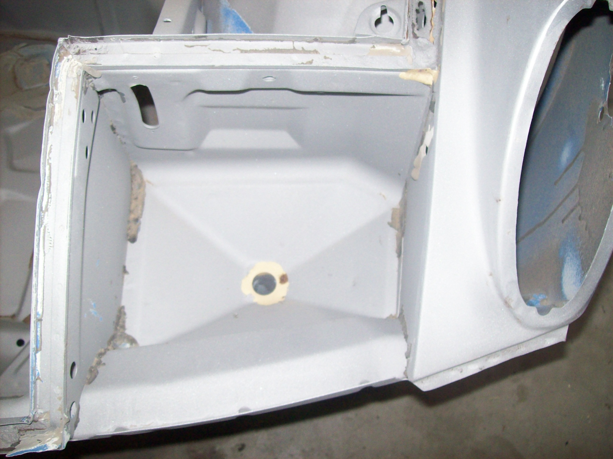

New to the board. Most of my work and experience is over on Pelican with 911 longhoods. I stalked a local PCA guy who was going to eventually sell his 914-6. No pressure, just every few months I let him know I hadn't forgotten. Finally got a chance to see the car in person three weeks ago. Passenger rocker issues as well as surface bubbling in a number of places. Car had been extensively autocrossed at PCA parades for years...very successfully. Owner had pulled the original 2.0 and replaced with a 2.7 RS spec engine with carbs. He bought another mid-engined car (boxster) and ignored the 6. I bought the car (w/ 2.7) and original engine. Got the 2.7 running well enough to drive the car...and decided to dive into the resto. I am familiar with rust, and plan to do it correctly. I have a rotisserie with 911 mounts, but shouldn't be a big deal to make mounts for the 6. Made a couple calls to Resto Design to check on parts...and away I go. I have a 71 911 softie that has been at paint too long...so while I wait for it to come home, thought I would see what my sandblasters schedule was. Turns out he can do the car in two weeks. So, I have a deadline. So...I guess this is my resto thread on my new Adriatic Blue 6...
I took a few hours Friday afternoon,a couple yesterday, and a few more today. Almost ready for the blaster
yuck...passenger side. Drivers side looks ok. Before you question...yes I do have some hell-hole issues.
More later...
Speedo

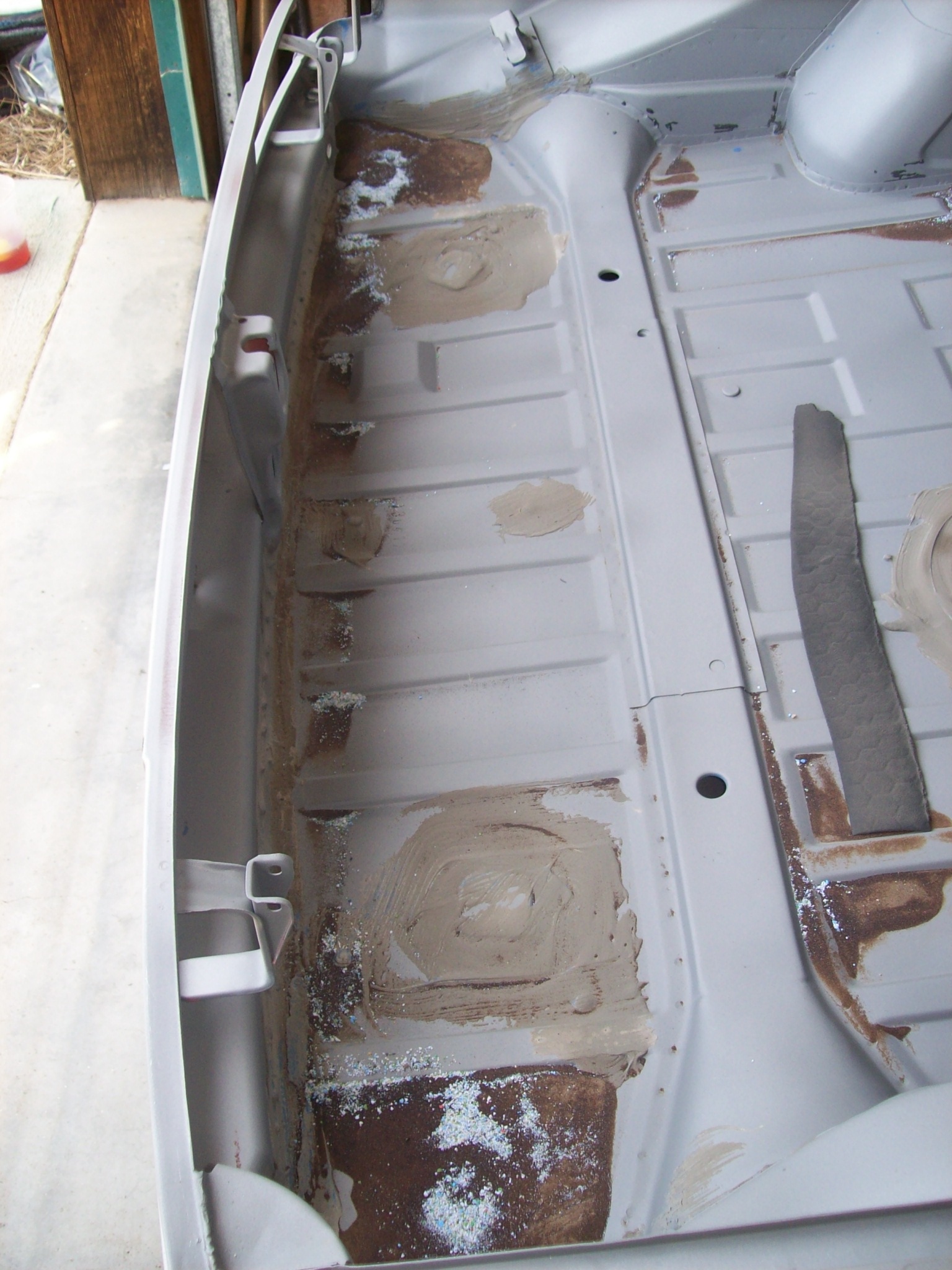

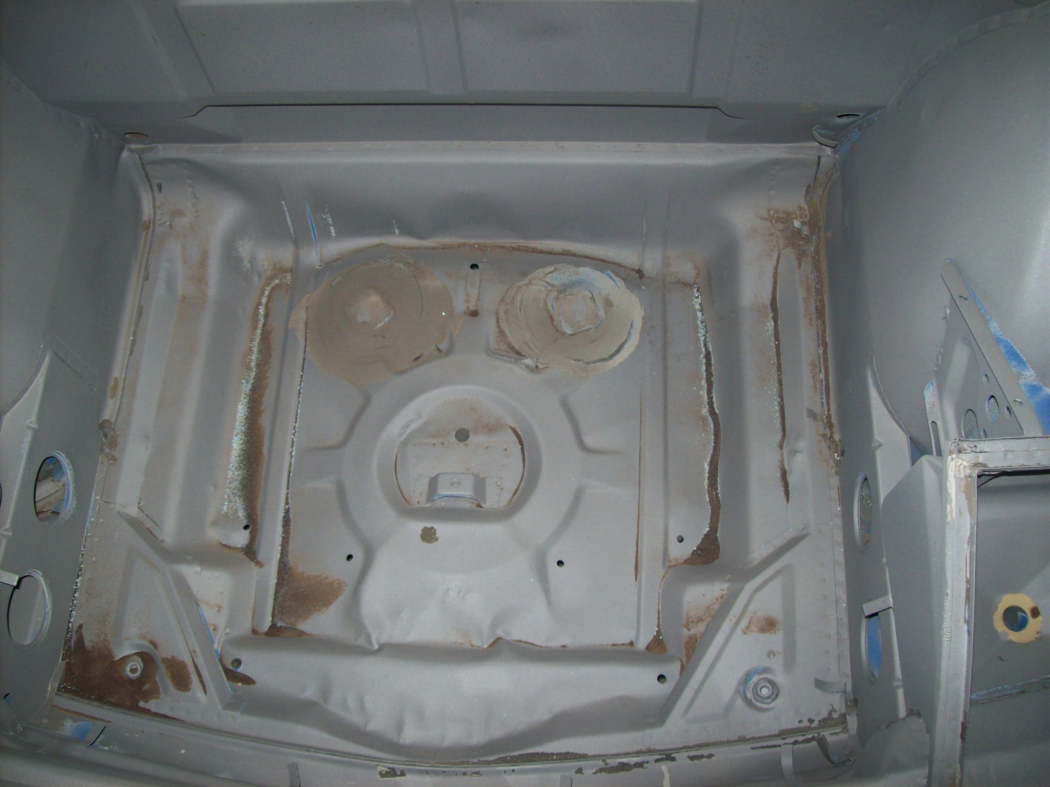

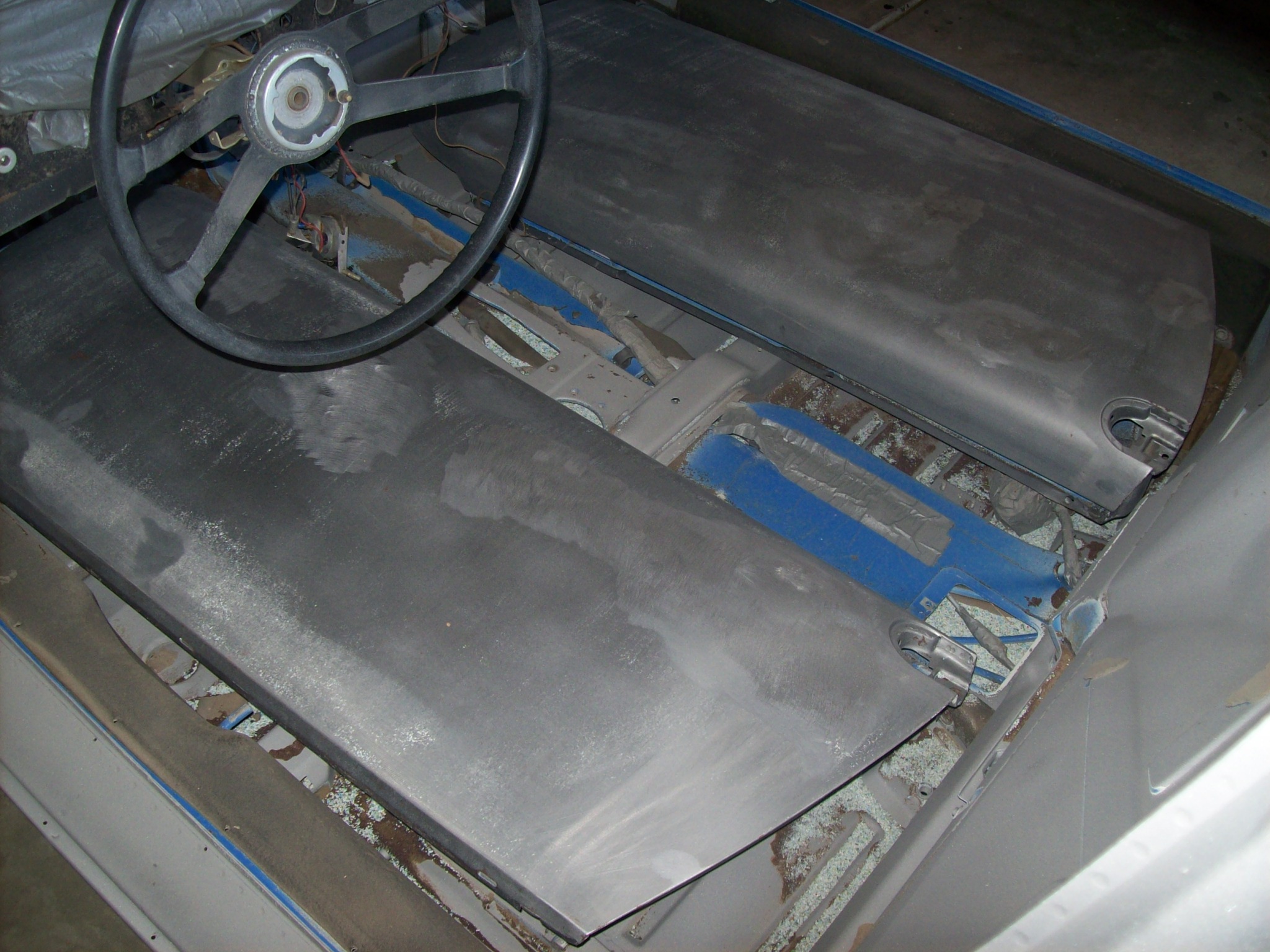

Clean continued....
Now for something completely different...the not so clean...the bad news...the unhappy steel. Take a deep breath...

wachospeedo   The "unwashed"...the worst first I ...   Aug 12 2012, 09:43 AM
wachospeedo   Instead of "the corner workers", these a...   Aug 12 2012, 09:50 AM
