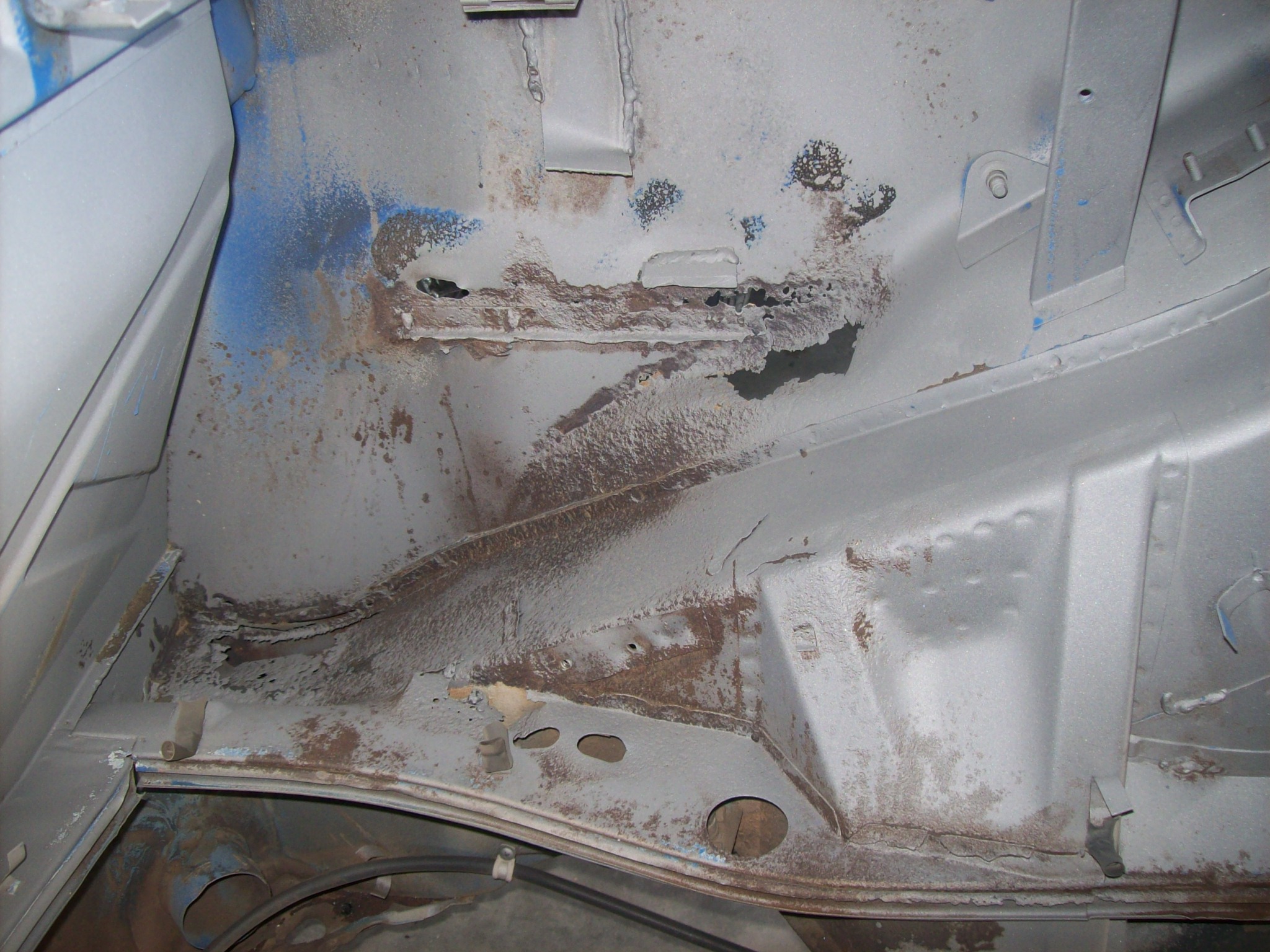

I took a few hours Friday afternoon,a couple yesterday, and a few more today. Almost ready for the blaster
yuck...passenger side. Drivers side looks ok. Before you question...yes I do have some hell-hole issues.

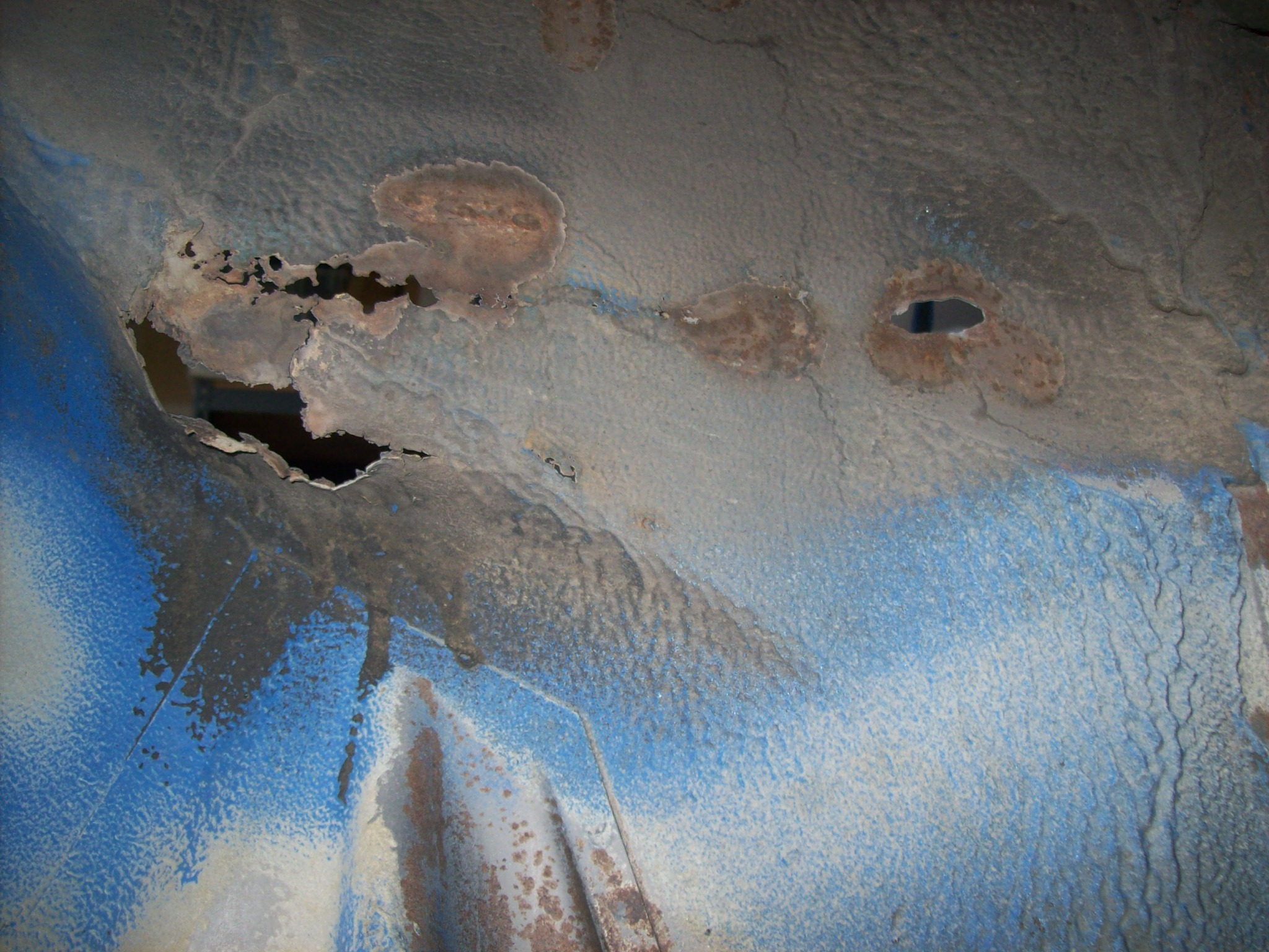

wachospeedo   Couple more...the hell hole. Hopefully after blast...   Jun 12 2012, 07:30 PM

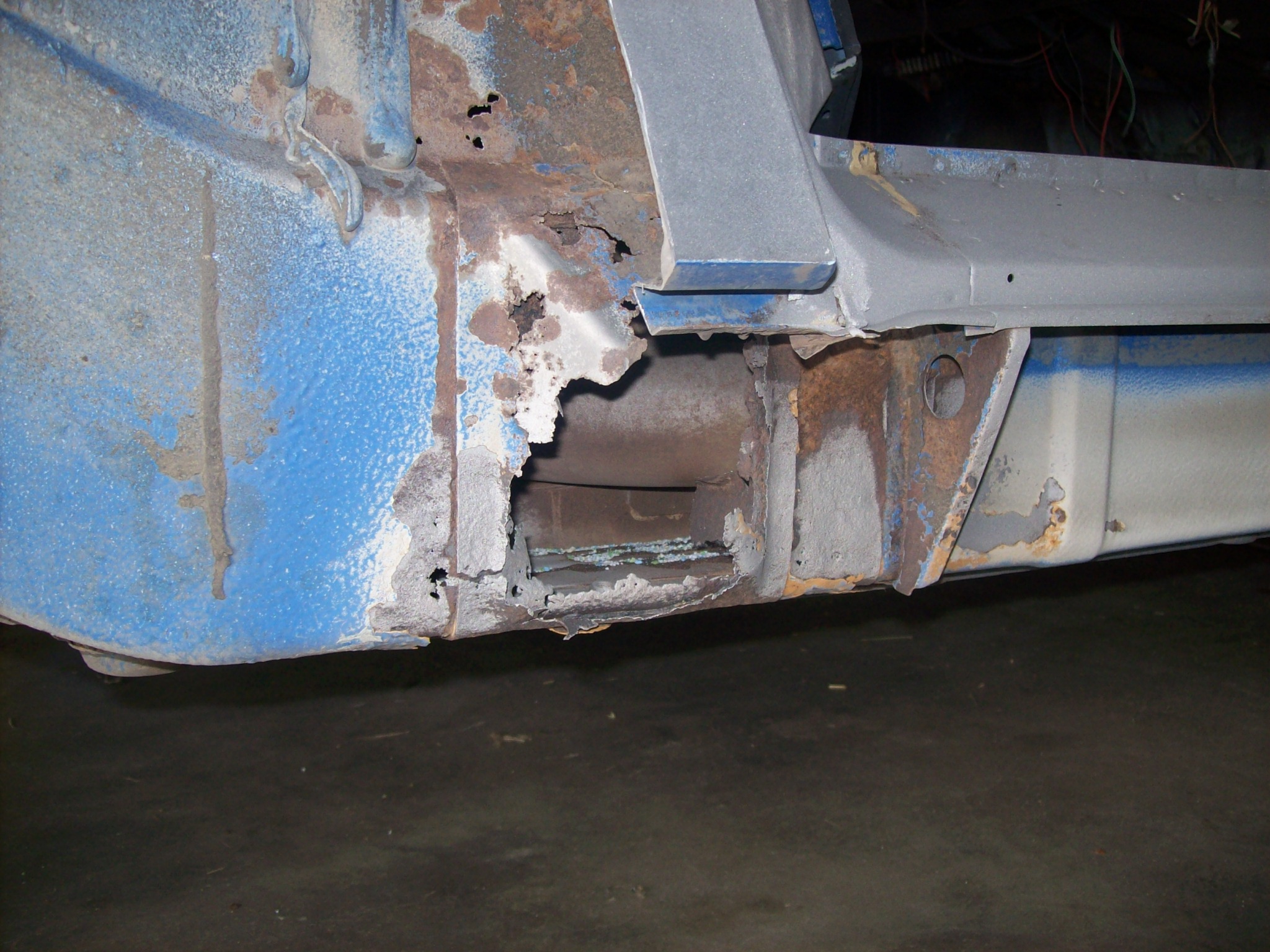

wachospeedo   More prepping for sandblaster. Removing the oil ta...   Jun 18 2012, 06:52 PM
wachospeedo   Moving on...This all obviously is bye bye I atta...   Jun 18 2012, 07:11 PM

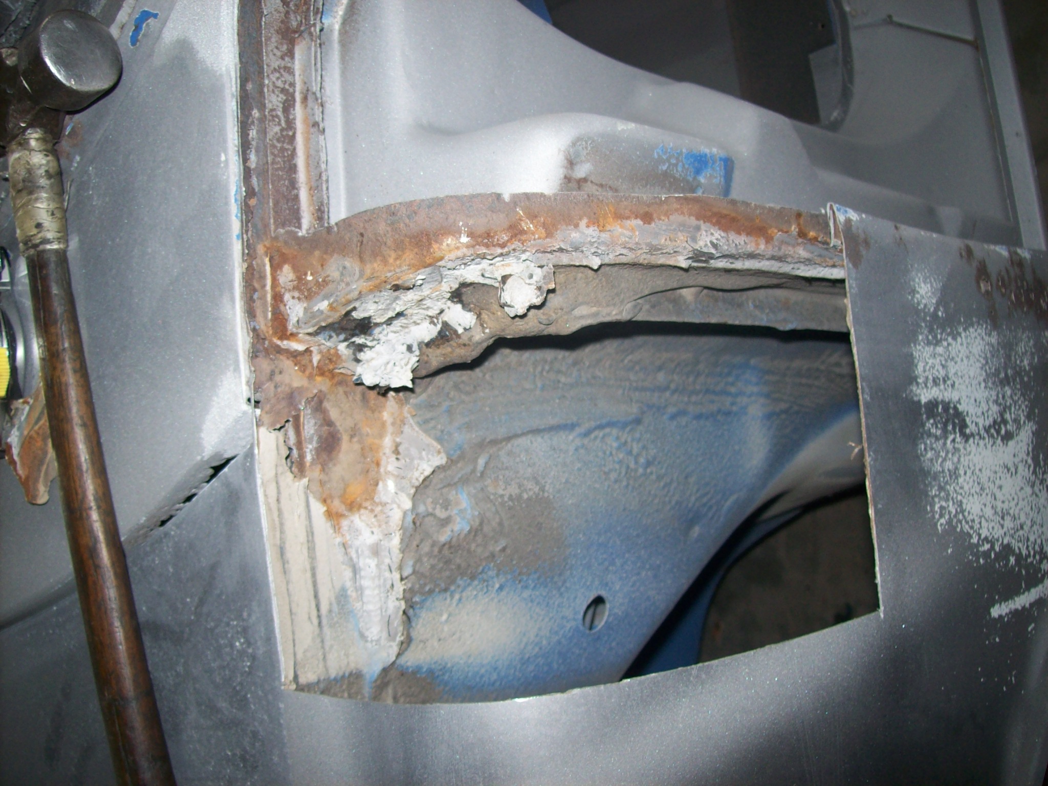

wachospeedo   Ok Brant... Marching orders...cut the bad out befo...   Jun 20 2012, 08:25 PM

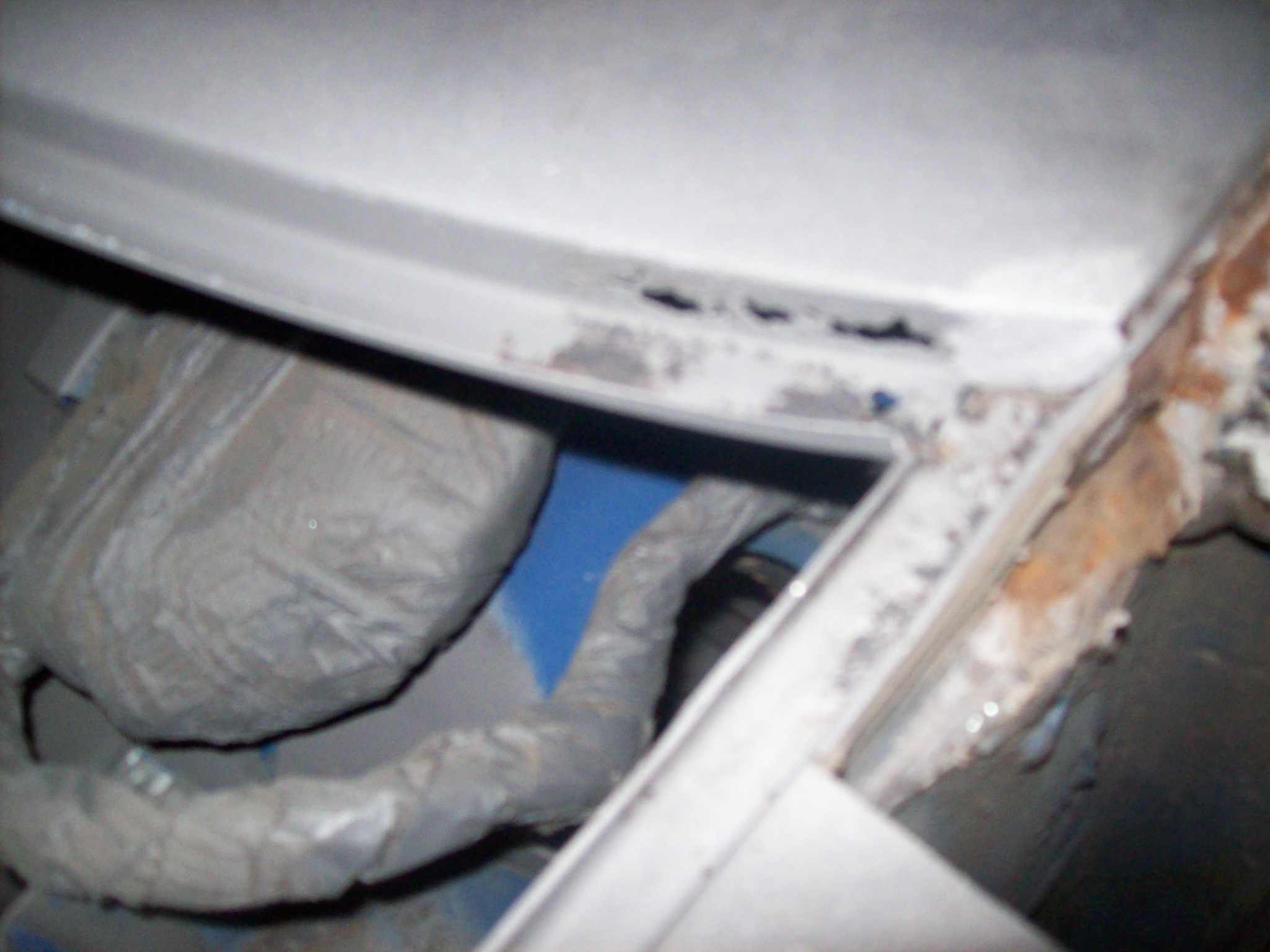

wachospeedo   One more view of the perforations in the lip next ...   Jun 20 2012, 08:38 PM
