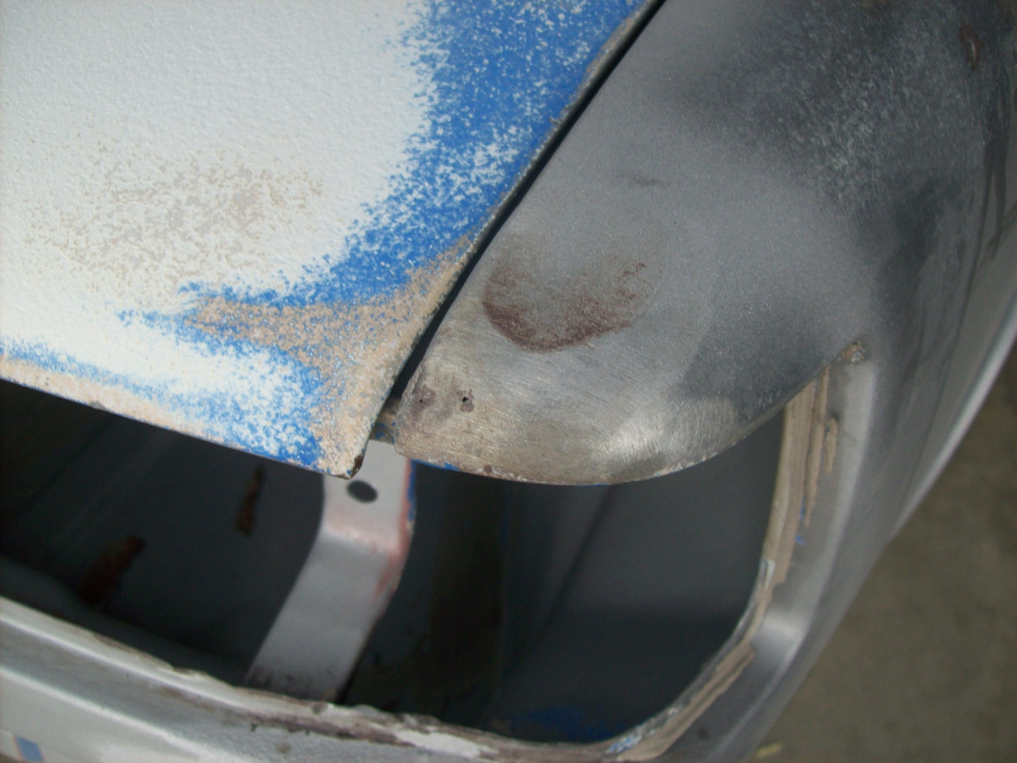

I took a few hours Friday afternoon,a couple yesterday, and a few more today. Almost ready for the blaster
yuck...passenger side. Drivers side looks ok. Before you question...yes I do have some hell-hole issues.

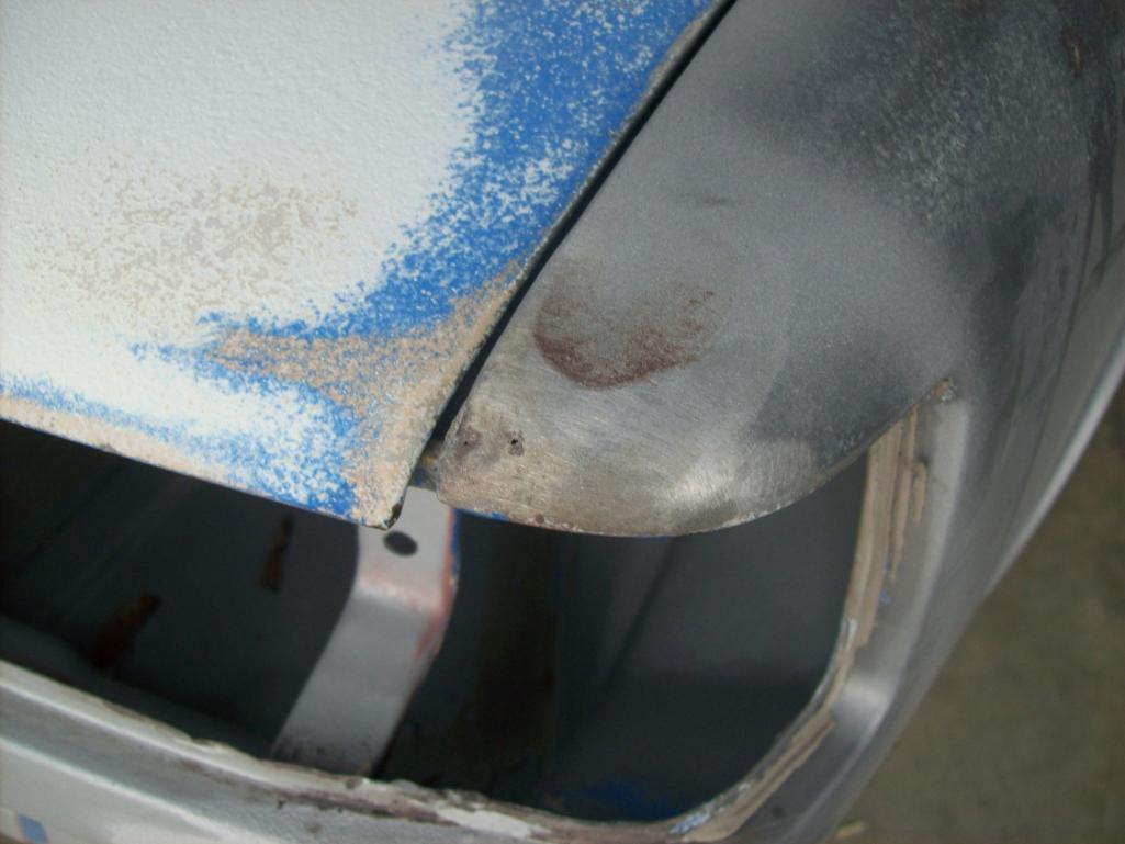

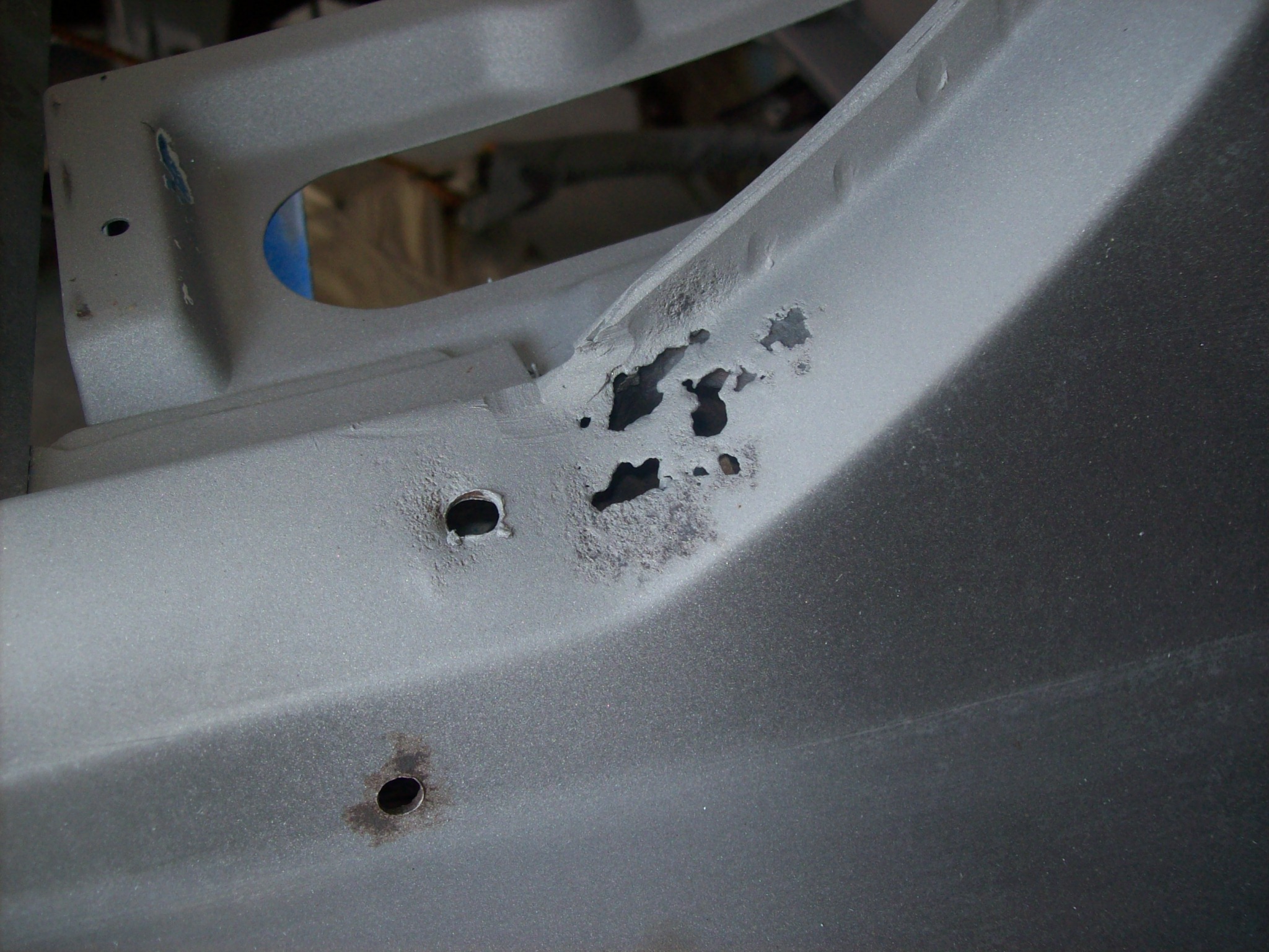

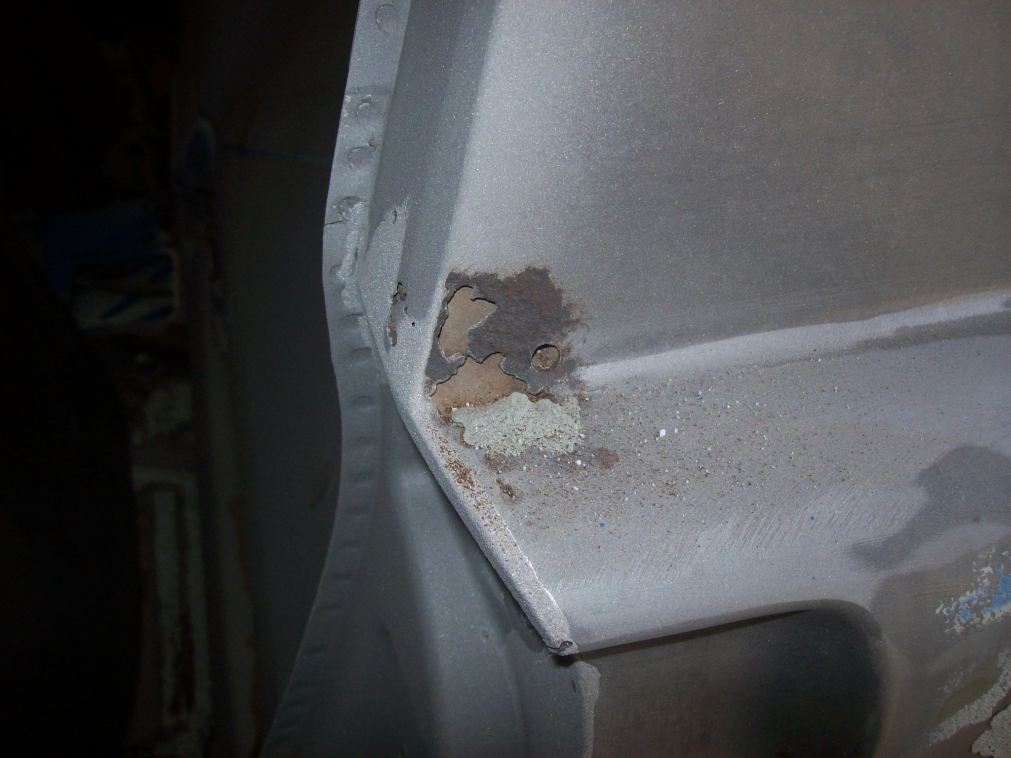

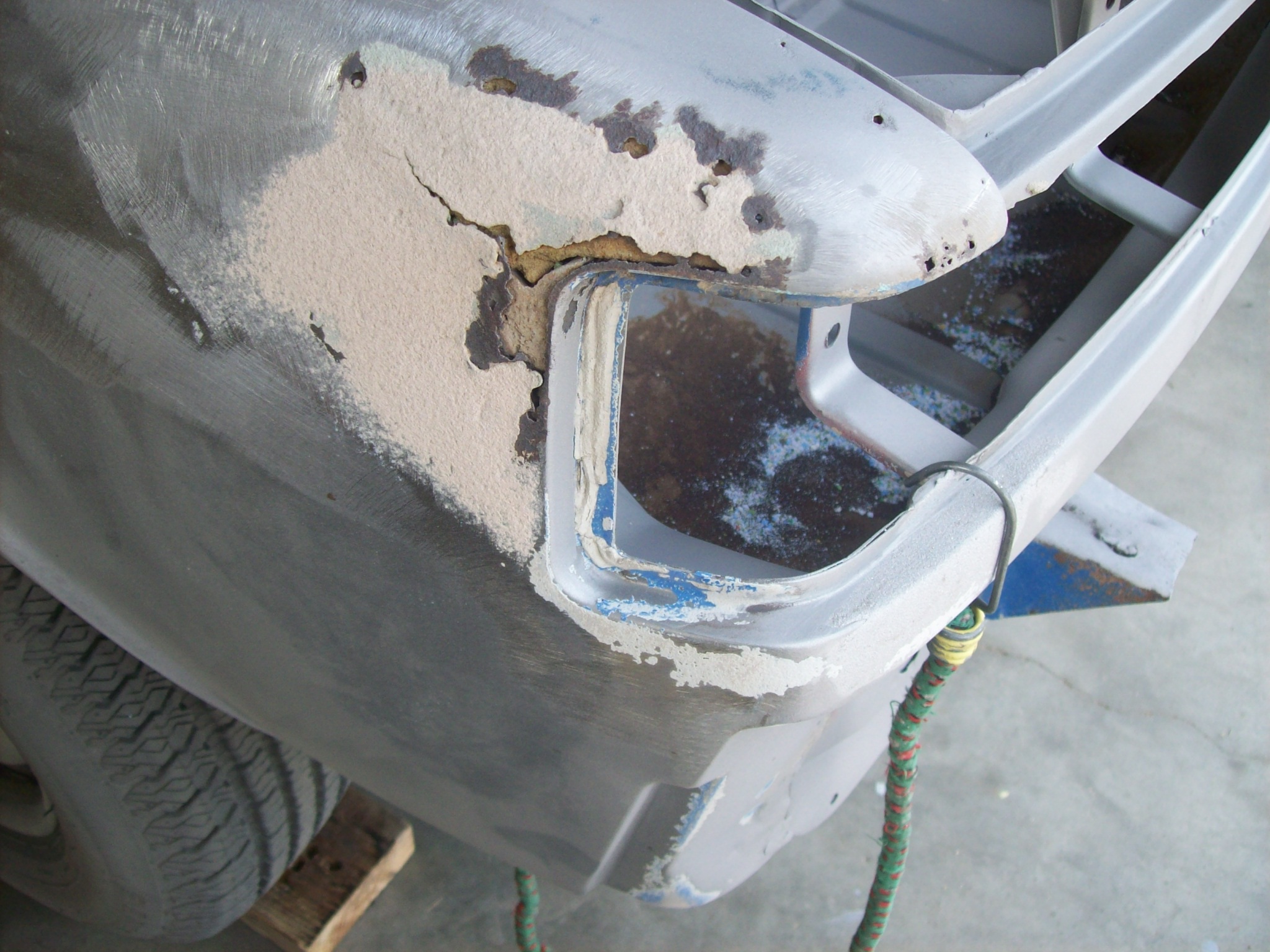

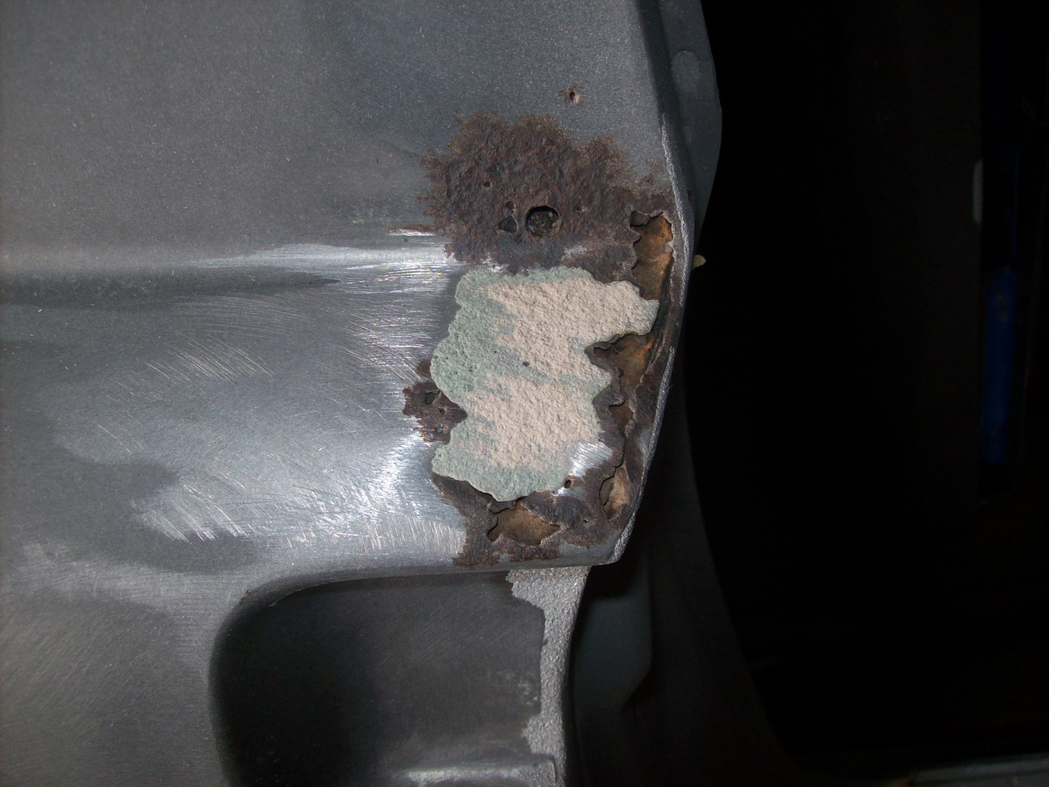

Instead of "the corner workers", these are the corners needing work...
Some are worse than others, but the donor shell will come in handy
