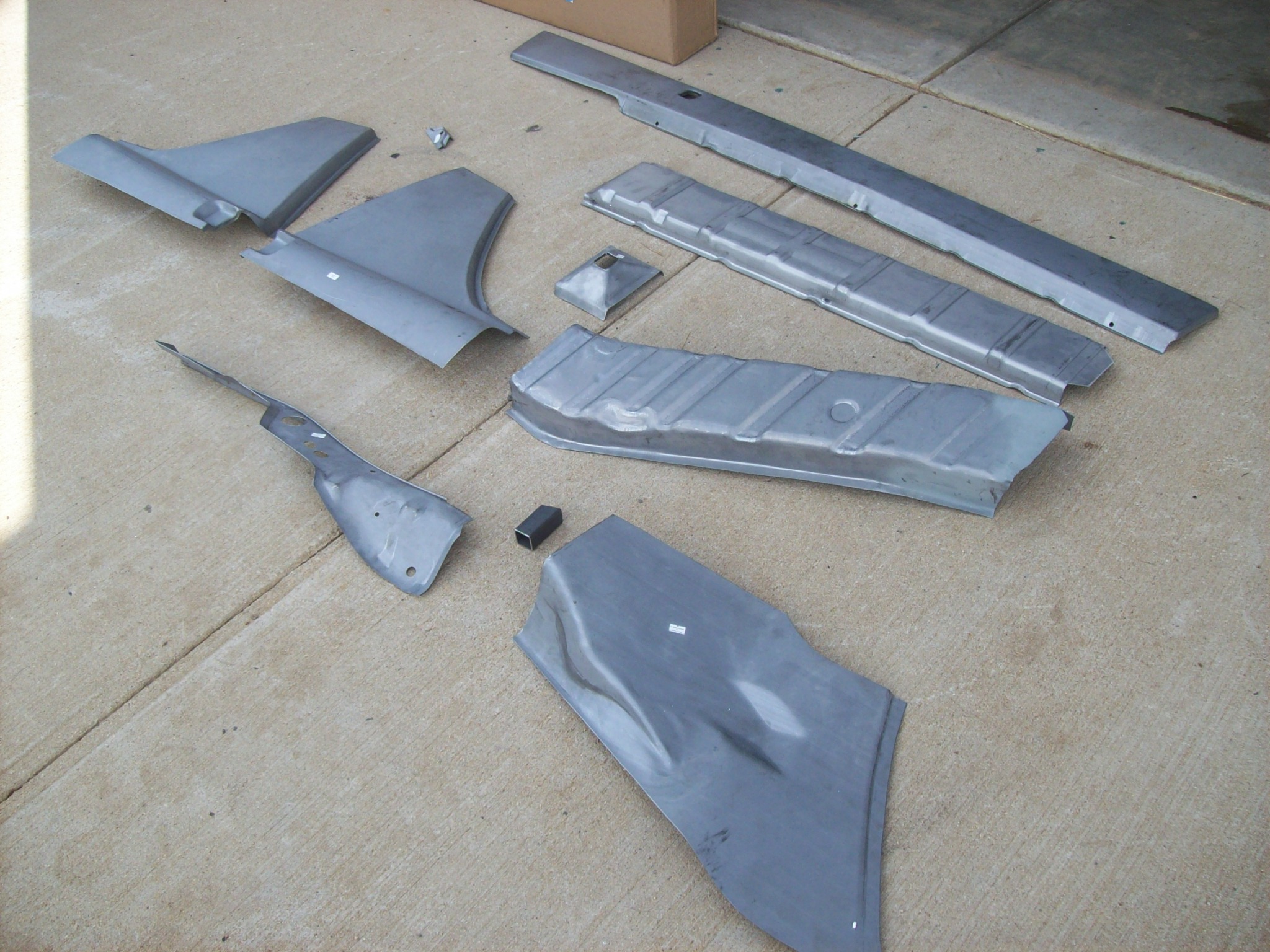

I ordered a big batch of repro steel from RD with Peter's help. Somewhere along the line, the shipper laid the box flat, something got stacked on the box, and the outer rocker for the right side got damaged so we had to ship it back. Claim seems to be going smoothly...we'll see.
The repro steel...

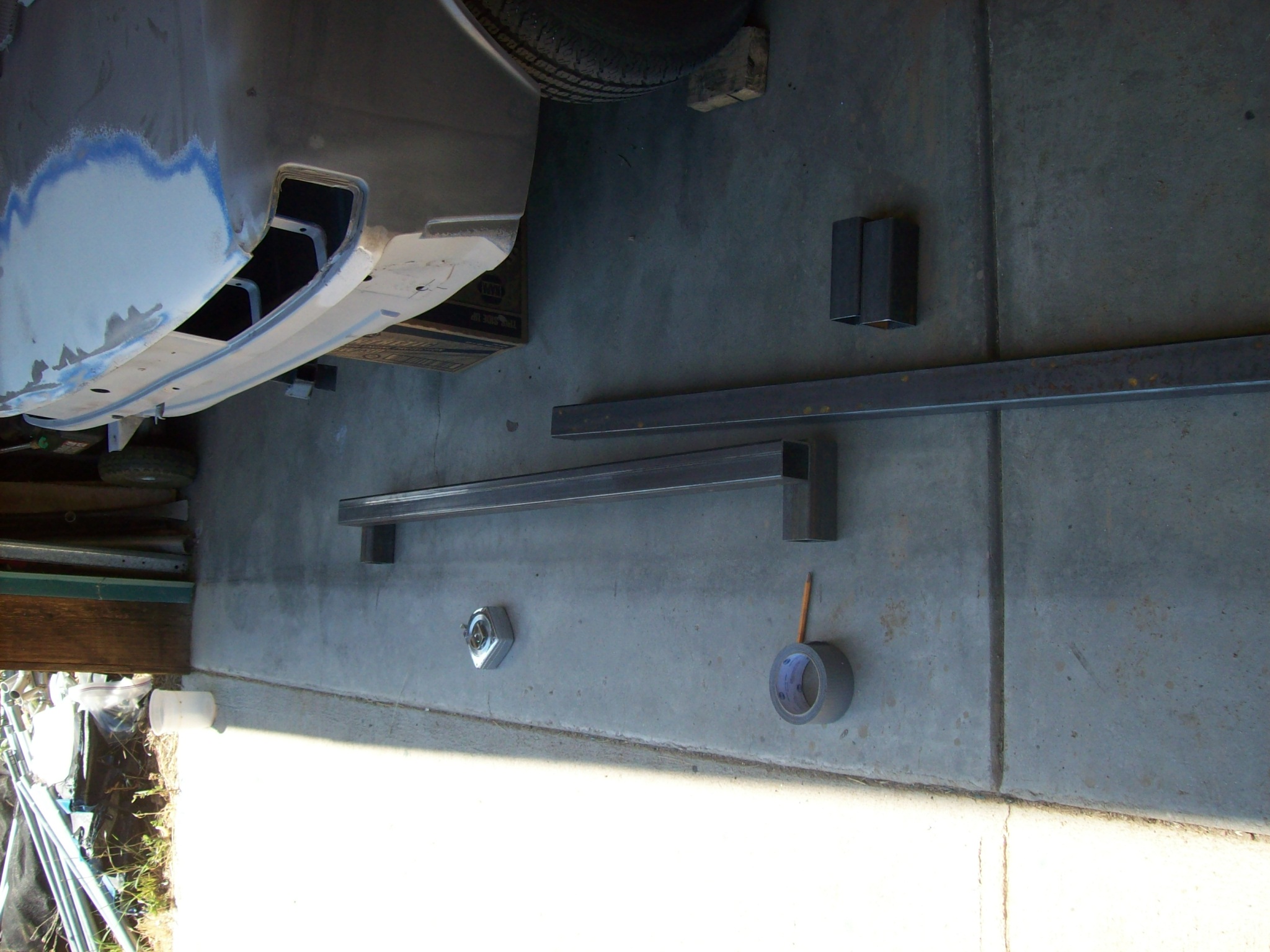

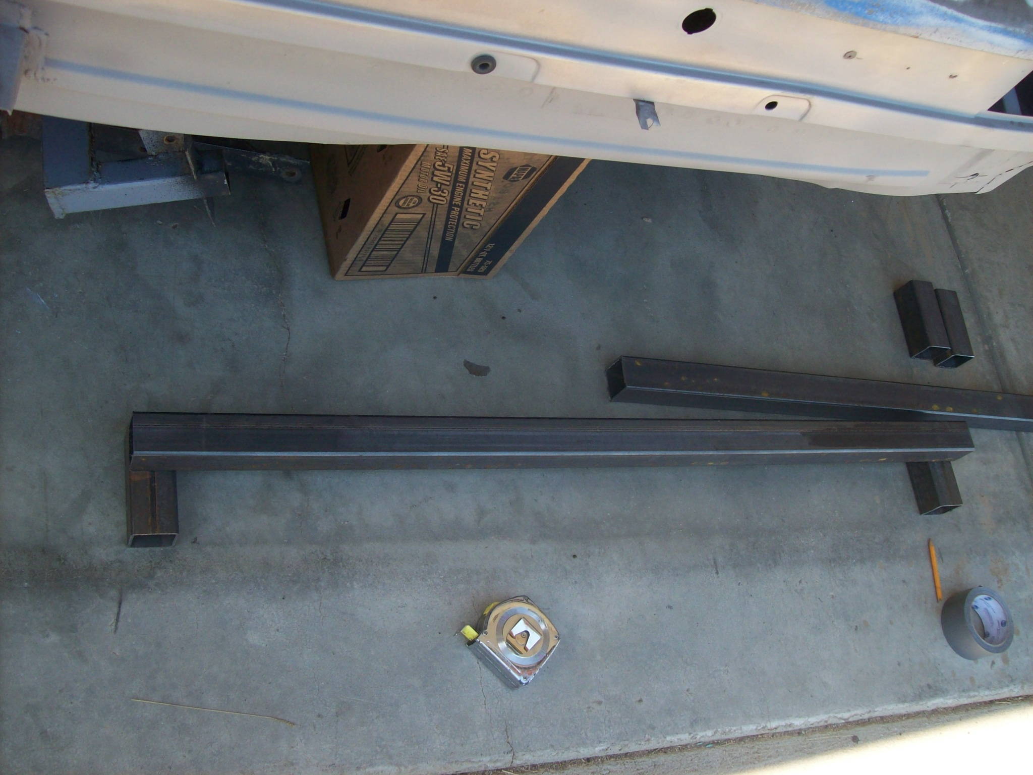

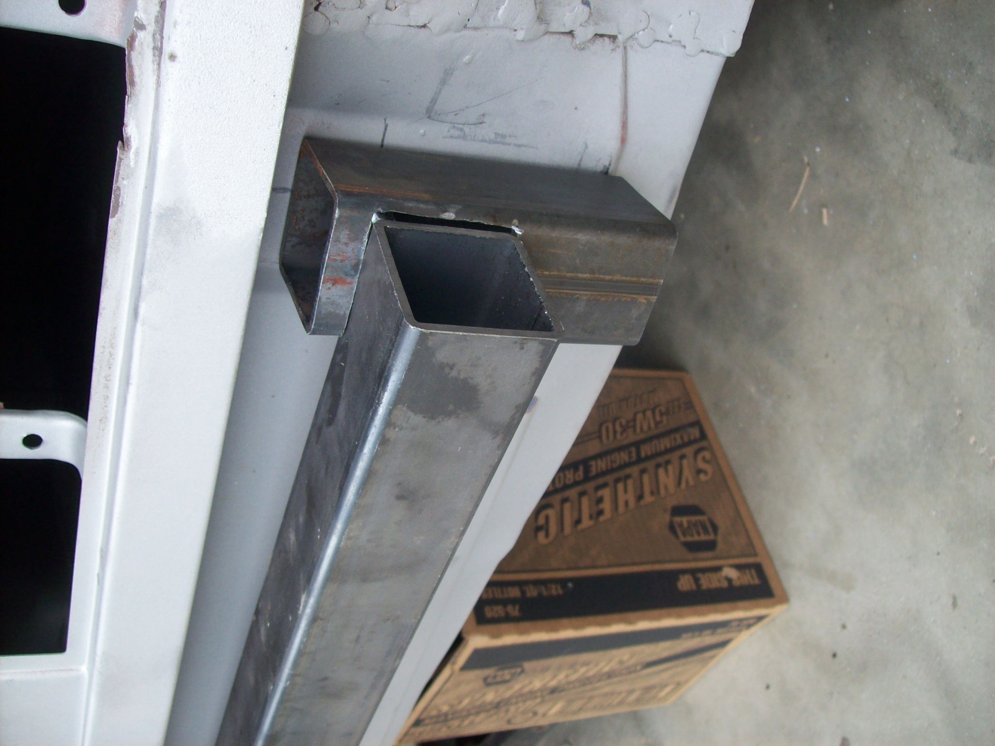

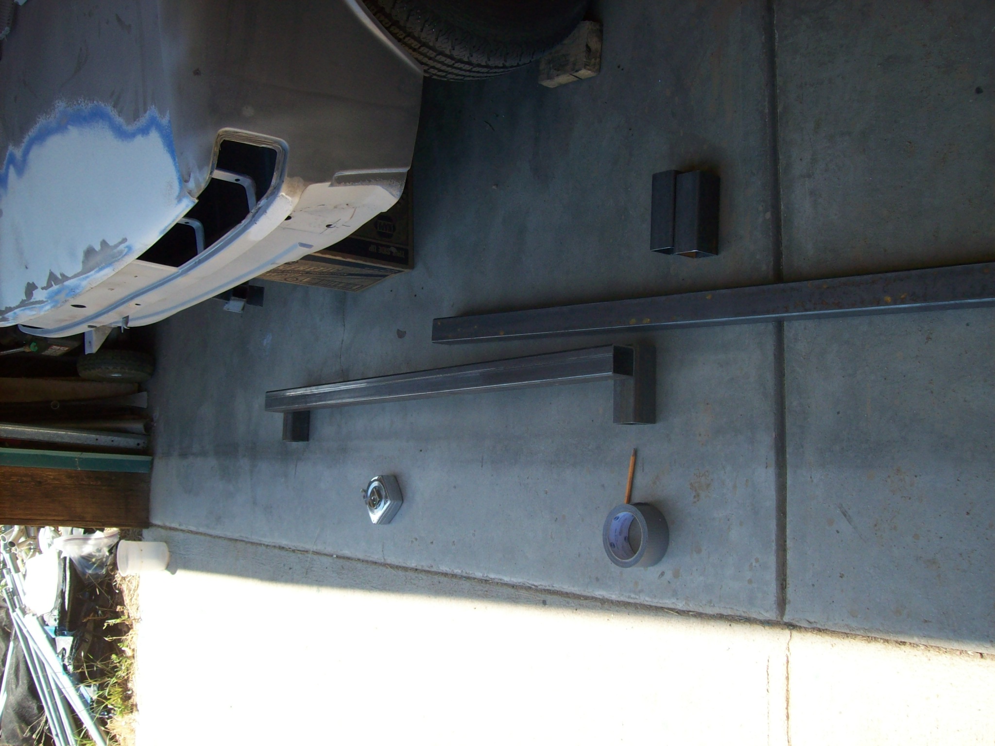

I ordered some 2 inch square steel tube to make the front and rear attach points for the rotisserie. In the beginning...
After getting it cut and trimmed and mocked up, the welding was a piece of cake.
