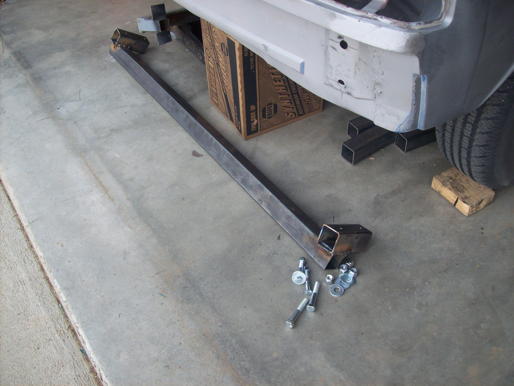

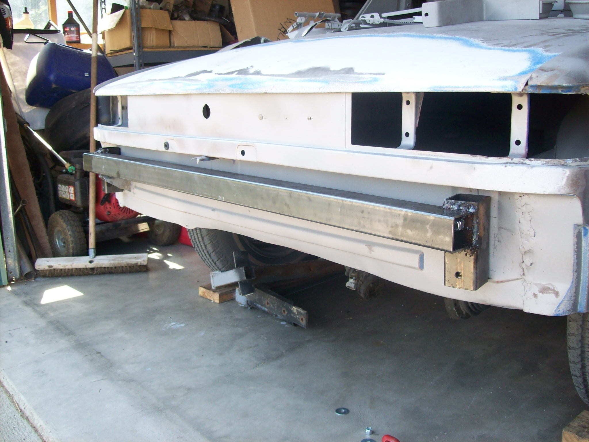

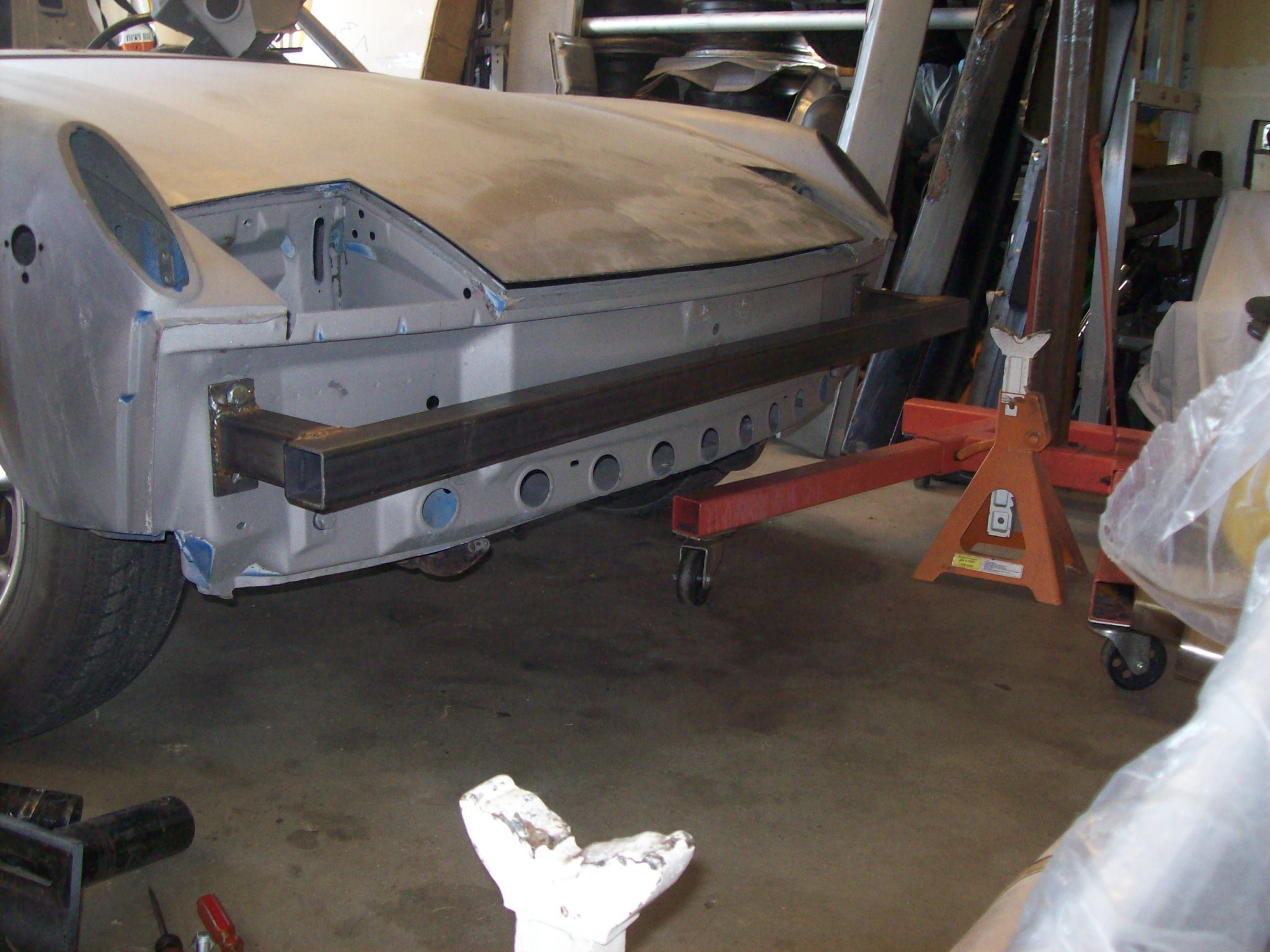

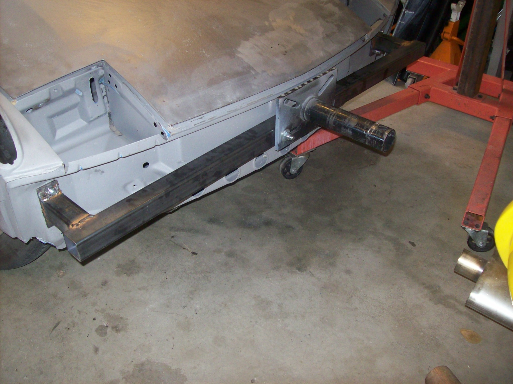

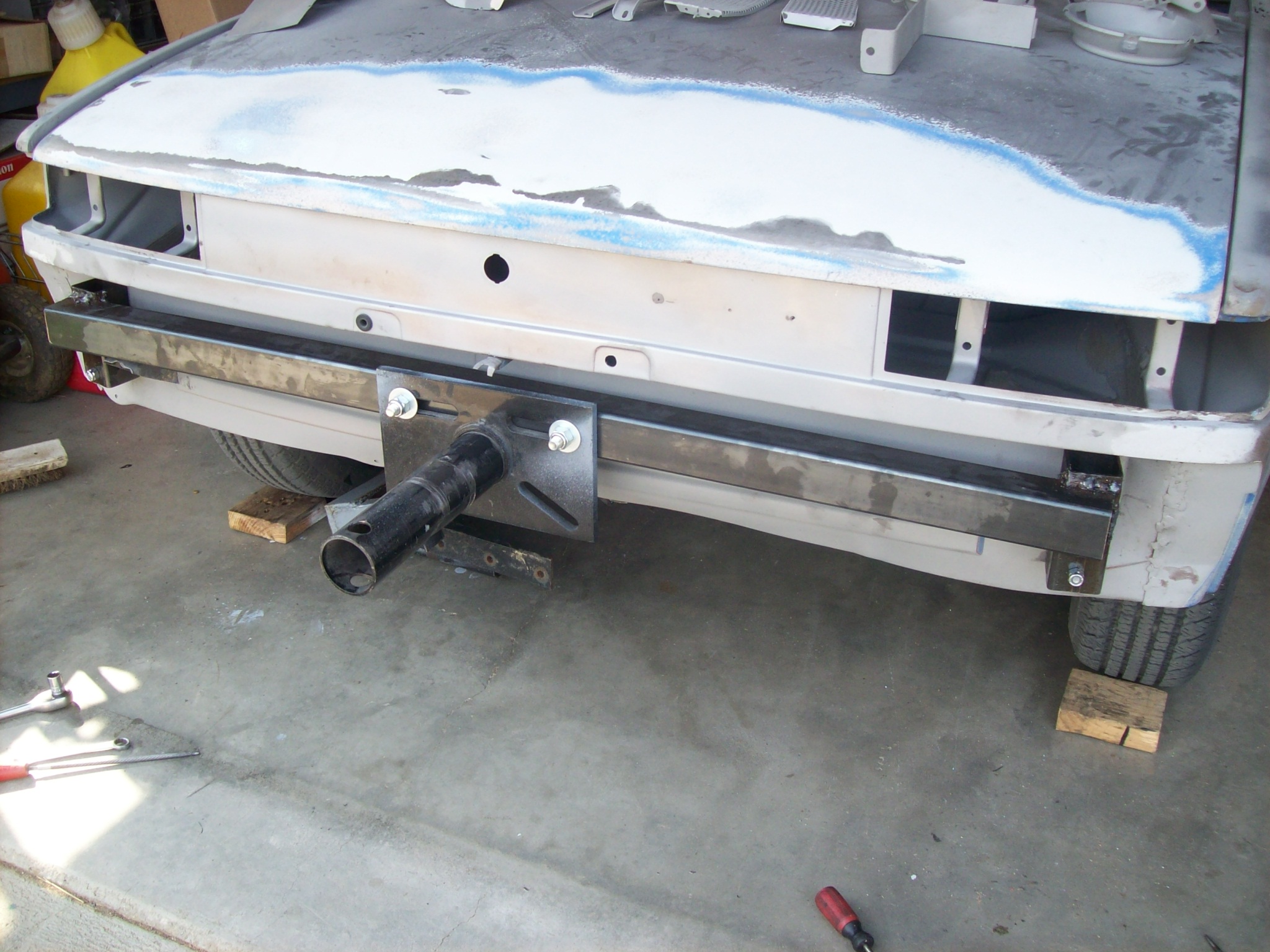

Braces going together...trial fit
I had to use a cutoff wheel in a chop box to fine tune the steel tubing angles. This meant that the steel got hot...very hot. I finished the vertical for the left rear, removed it (carefully) and was setting the right side in the box. Leaning forward ready to pull the saw down...I braced my left (bare) arm on something for no more than a second. I have a nice brand of that left side vertical on the back side of my forearm. Didn't take long to go through several layers of skin quickly. Seared it right up. Glad I'm not a cow.
Finished mounts
And with plugs for yokes
