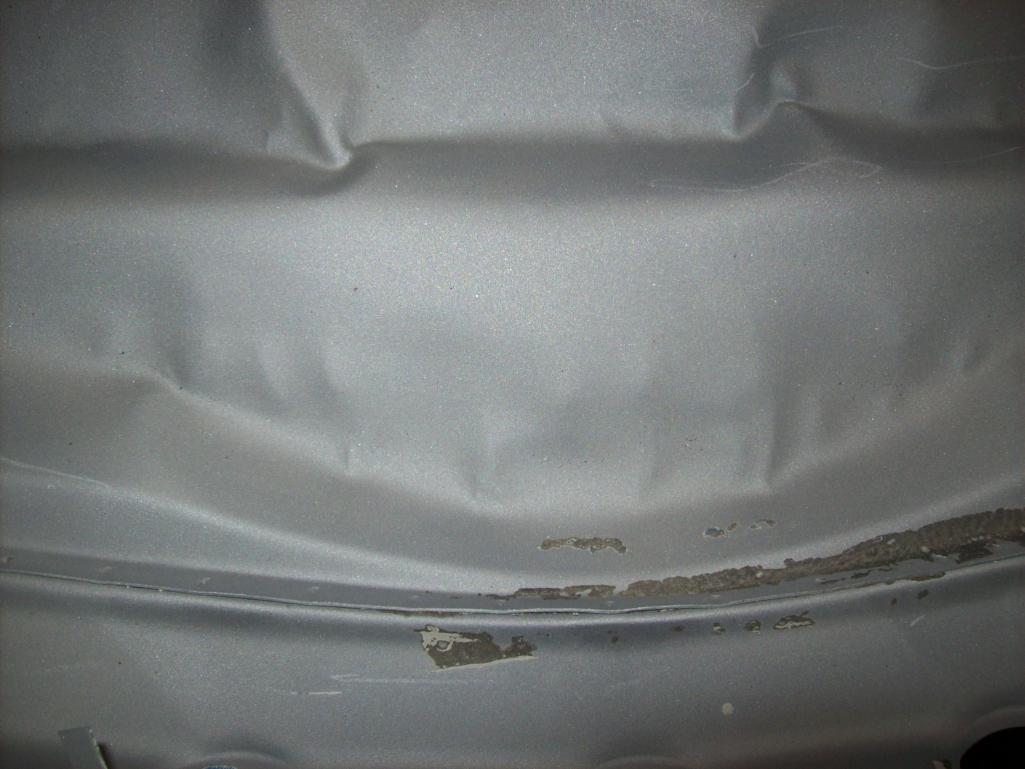

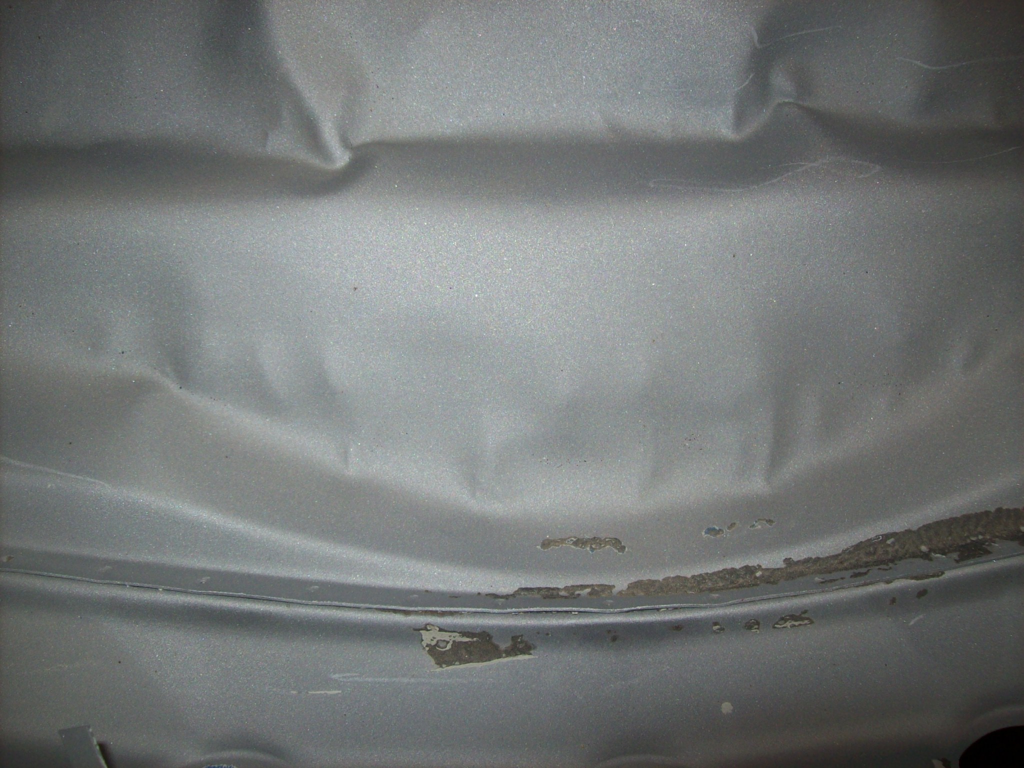

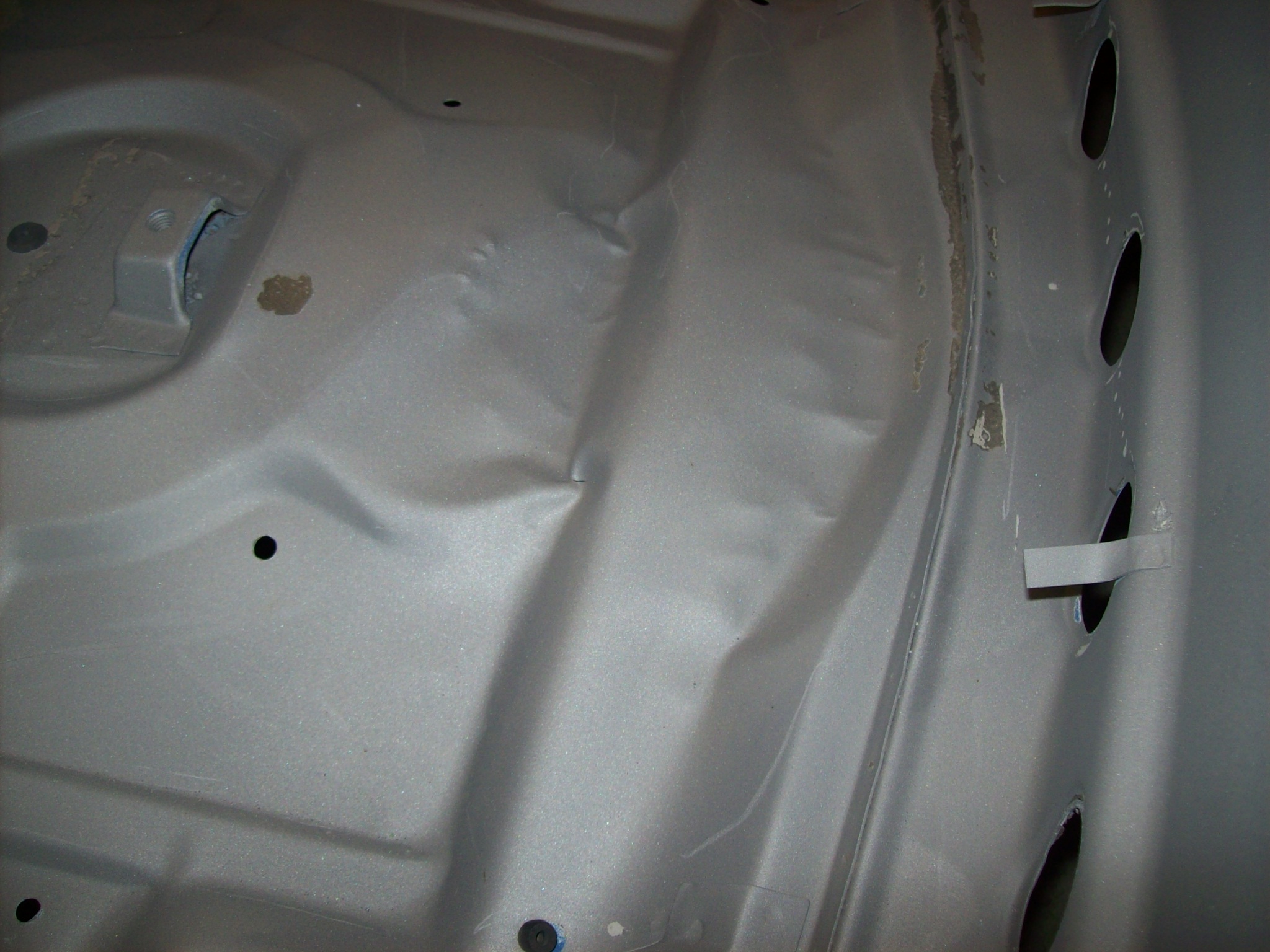

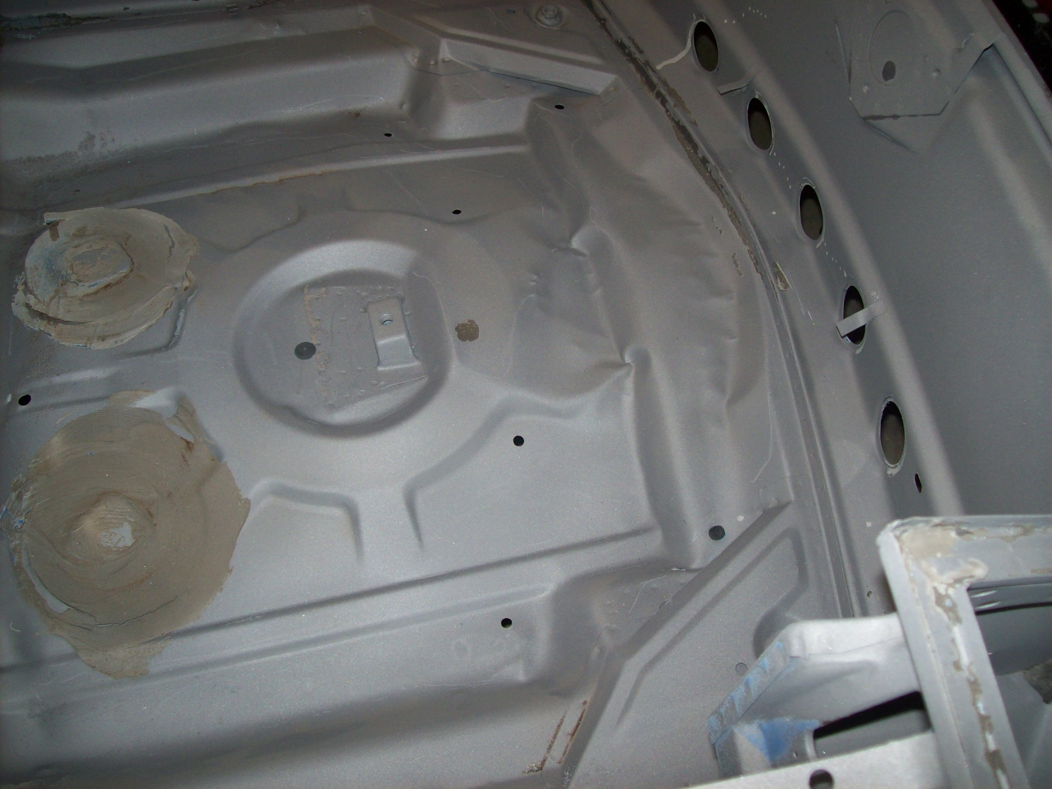

I needed to massage a few front trunk areas while the car was still supported by it's suspension. This area is solid, but beat up. Like it was seriously offroaded. The PO did a lot of autox in his day...but the cones he hit must have been made out of wood. Take a look
I talked with Peter again at RD and he sent me a link to his stamping link for the new front pan. I wanted to know how far down I need to work the pan. I believe there is a very slight "arch" at the front of the pan after it comes up off the floor of the pan. I am amazed that this thing has dents (upward) on top of dents. Like looking at pictures of mars with craters inside craters inside craters. You get the picture.
I metal worked with a hammer and dolly all of the small dings and some of the large ones. The pan is still "proud", but not much I can to from here...I will likely run my cutoff saw exactly down the middle of the pan north to south and release the tension. That will allow me to work both sides down so that I can stitch the center back together once flat.

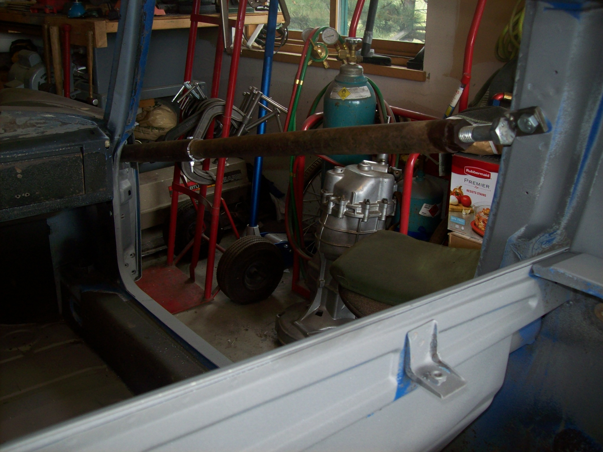

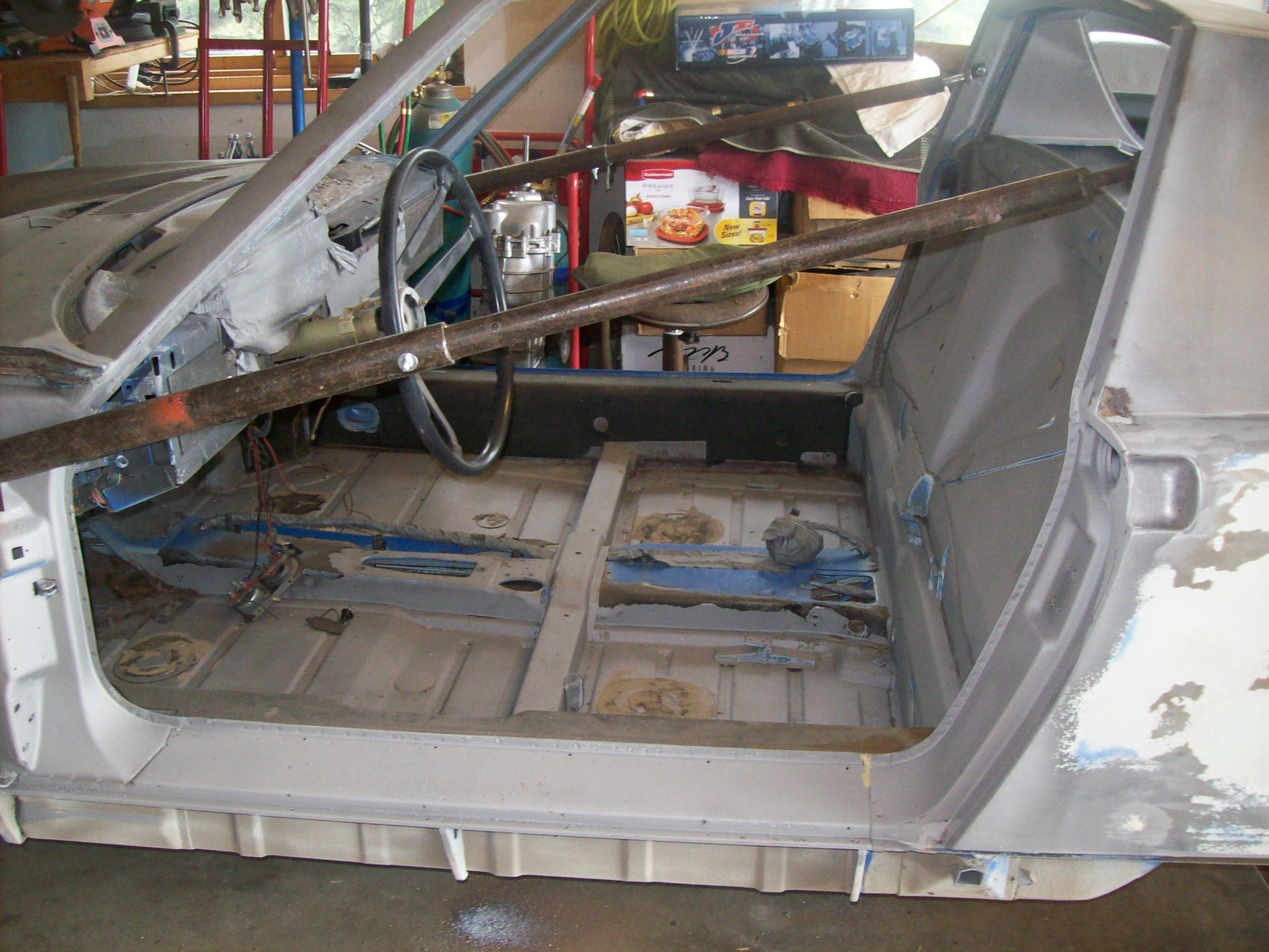

Won't go into the detail, but I needed to fabricate side braces that telescope. Put these together and gave just a tidge of "pre-load". I used the typical top hinge and the seat belt support

wachospeedo   So I need to get a concensus as to whether where t...   Aug 13 2012, 08:15 PM
seanery   That looks bent to me.   Aug 13 2012, 08:54 PM
brant   sorry but I agree... bent can people please add p...   Aug 13 2012, 10:40 PM
DEC   sorry but I agree... bent can people please add ...   Aug 14 2012, 03:07 AM
Cairo94507   Yup; should be flat.   Aug 14 2012, 06:25 AM
brant   Nice shot DEC does anyone have a frontal shot sho...   Aug 14 2012, 08:35 AM
peteyd   Heres a pic...   Aug 14 2012, 03:12 PM
sixnotfour   Pete's looks pushed up in the center also.   Aug 14 2012, 04:07 PM
Katmanken   Dang, I wonder if the PO used the flat of the fron...   Aug 14 2012, 06:03 PM
seanery   I like where you're going with that ken.   Aug 14 2012, 06:27 PM
