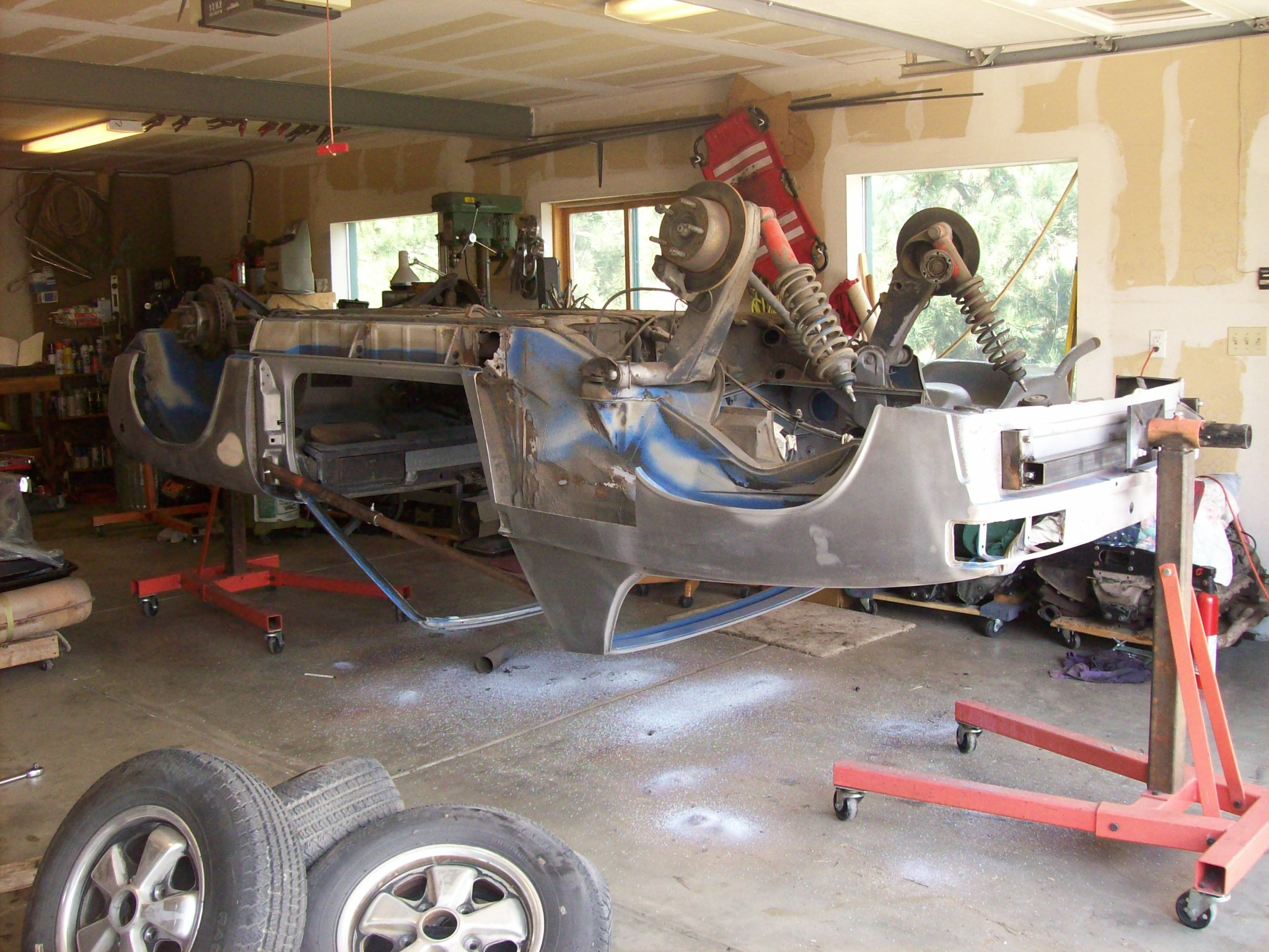

I took a few hours Friday afternoon,a couple yesterday, and a few more today. Almost ready for the blaster
yuck...passenger side. Drivers side looks ok. Before you question...yes I do have some hell-hole issues.

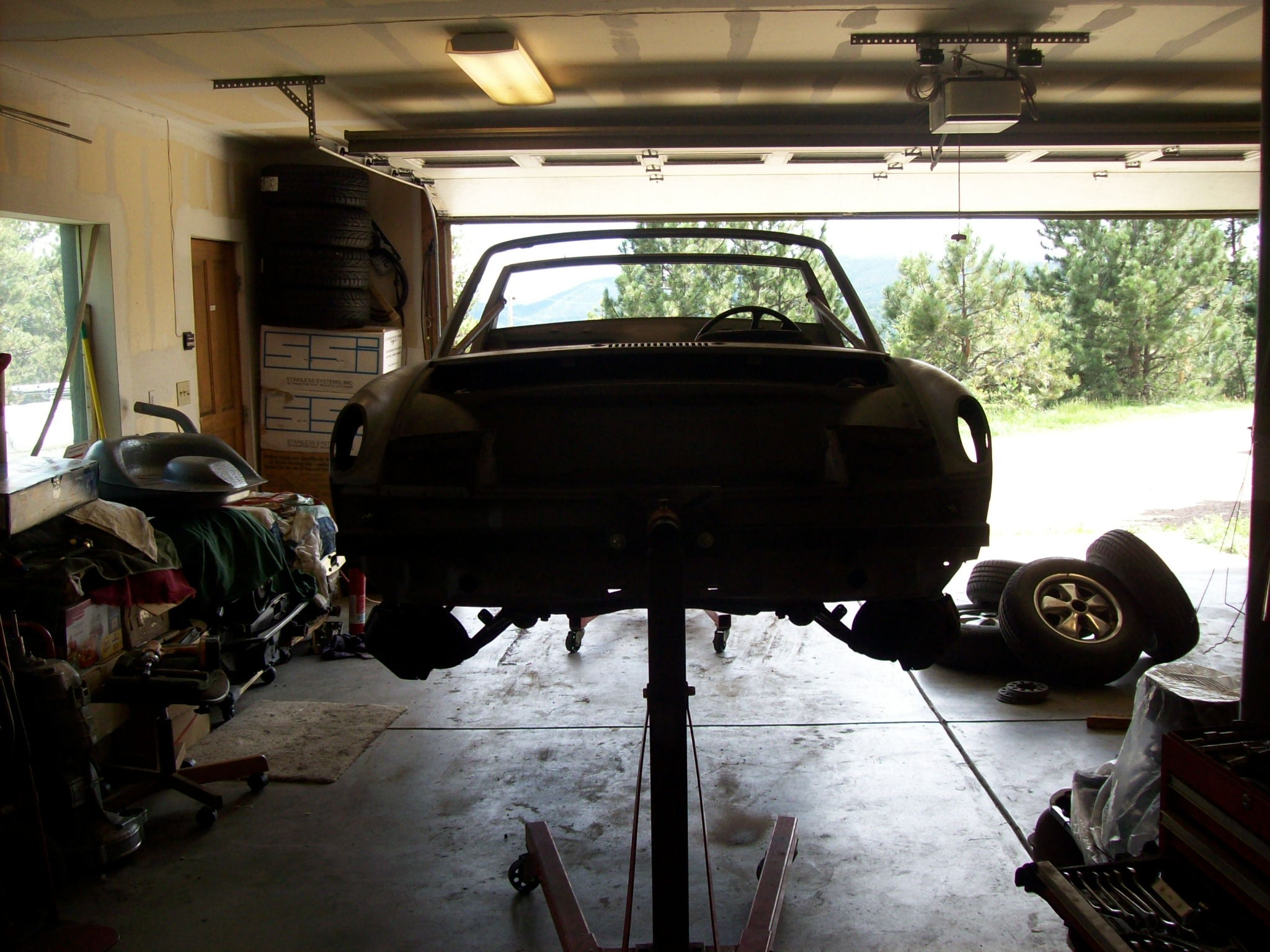

Crap! I rolled my car!
So not claiming to be the best driver...I have had my share of unfortunate circumstances in cars. Most of the time, it was a result of rapidly changing conditions (weather) or deer...hey I live in the mountains at 8100 ft. I remember as a kid hearing some teenagers bragging about having "rolled their car" and walking away unscathed. Well as I usually drive a 911 year round and don't have much seat time in a 914...I guess I got a bit cocky yesterday. I should have been more careful, it was nobodies fault but my own...and as I can fix it...I will.
Not for the faint of heart, but here are the pictures.
Before...kind of a nice artsy shot

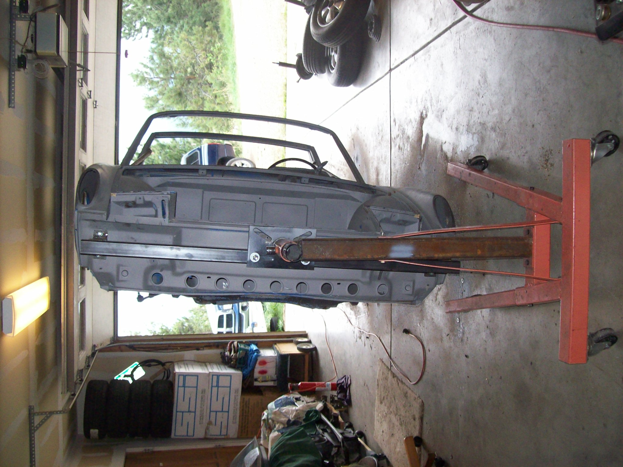

During ...
And after...
Pretty scary stuff.

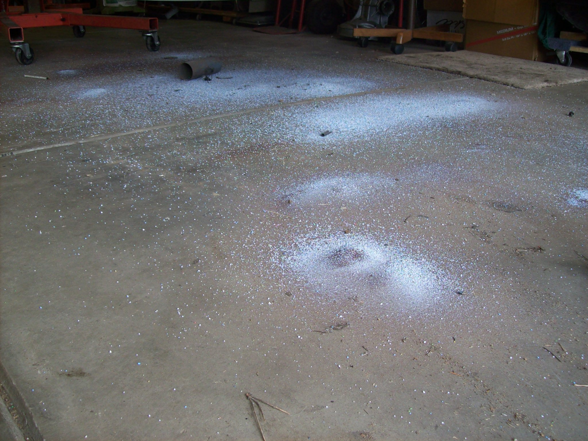

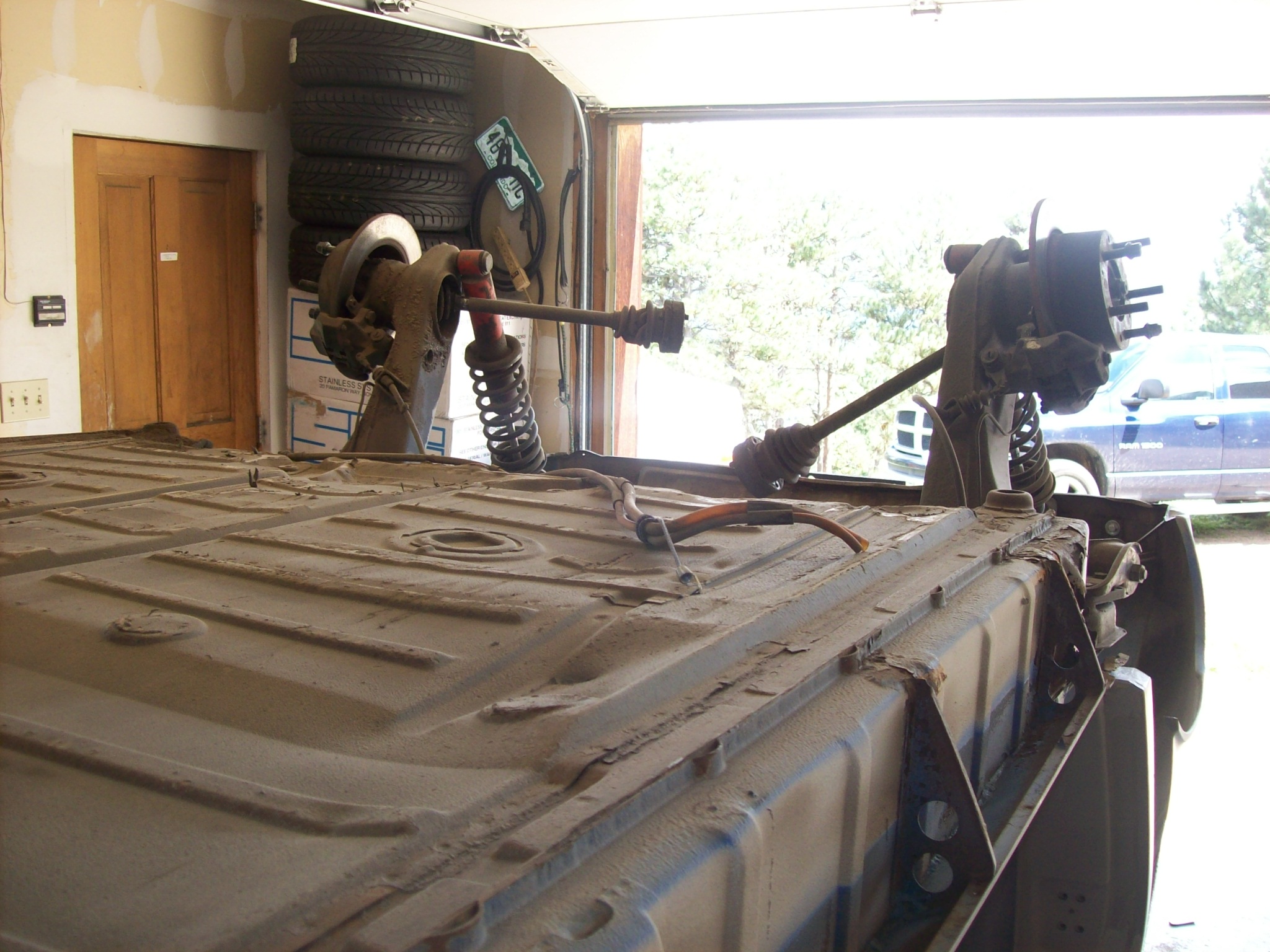

Oh I get it, if I keep rotating the car...more of this stuff (sandblasters media) will come out. I could just hook a small motor up to the rotisserie and leave it over night. I might also polish the internals on the chassis
Removing the suspension is going to be an easy job while upside down
