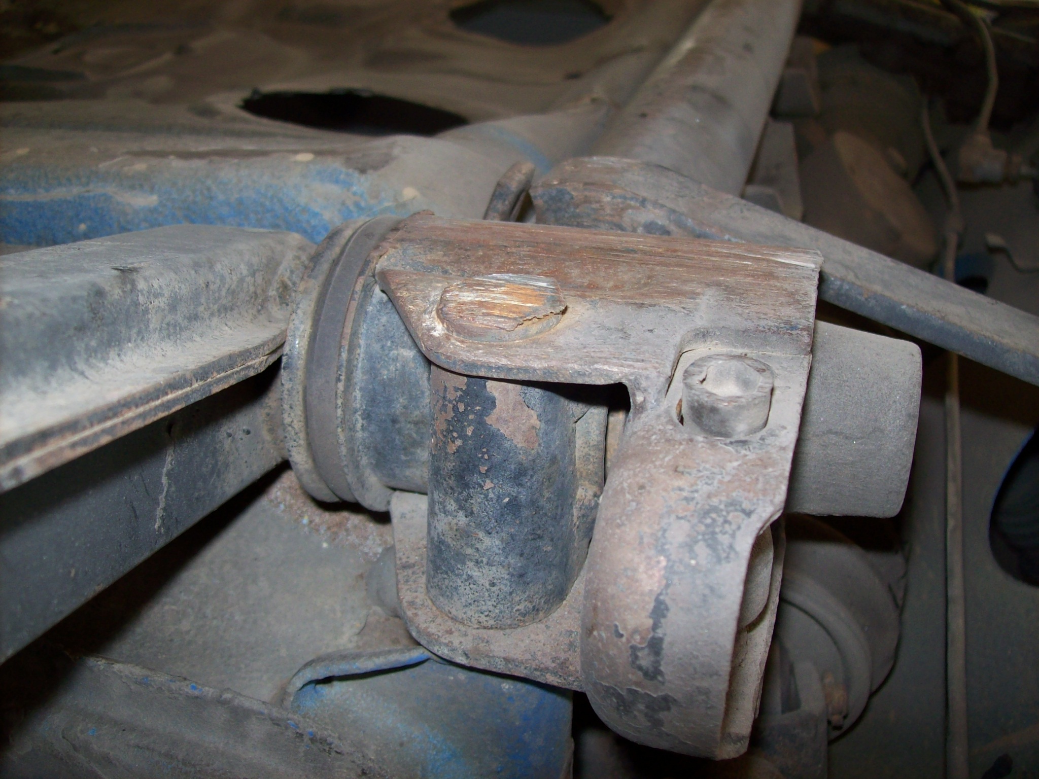

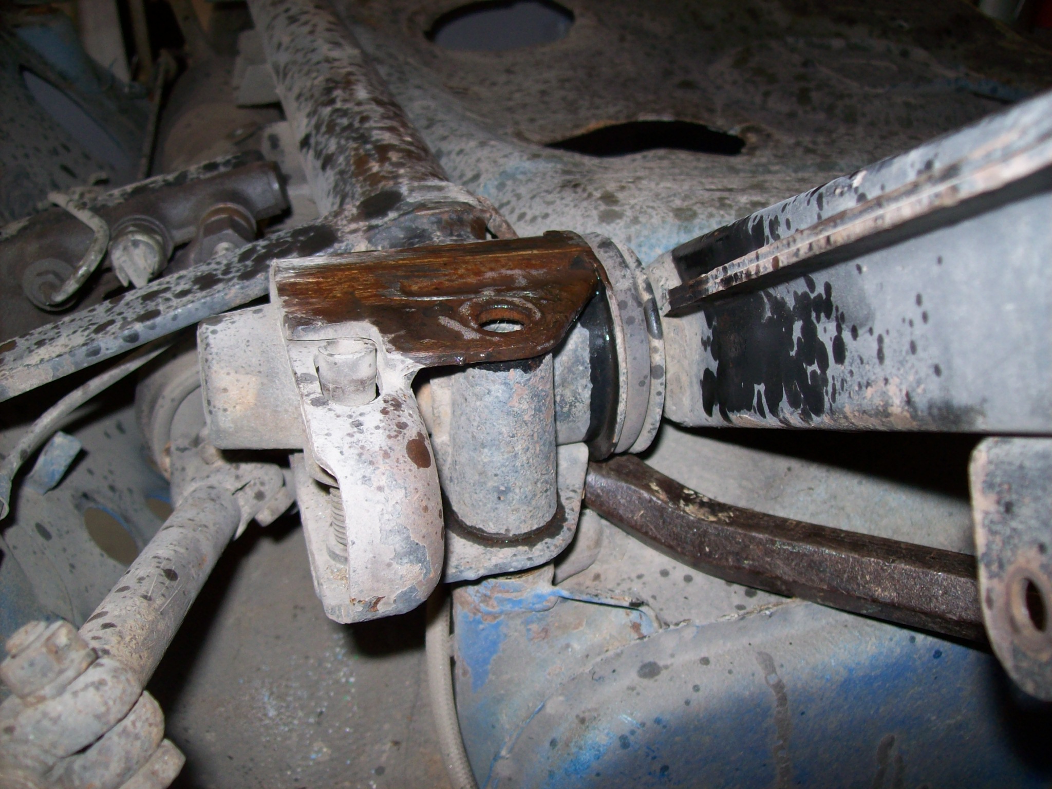

Front suspension first. Nice to have easy access to the crossmember and A-arm mount points. No problem till I found this...
Wait, not the other side too? Really?

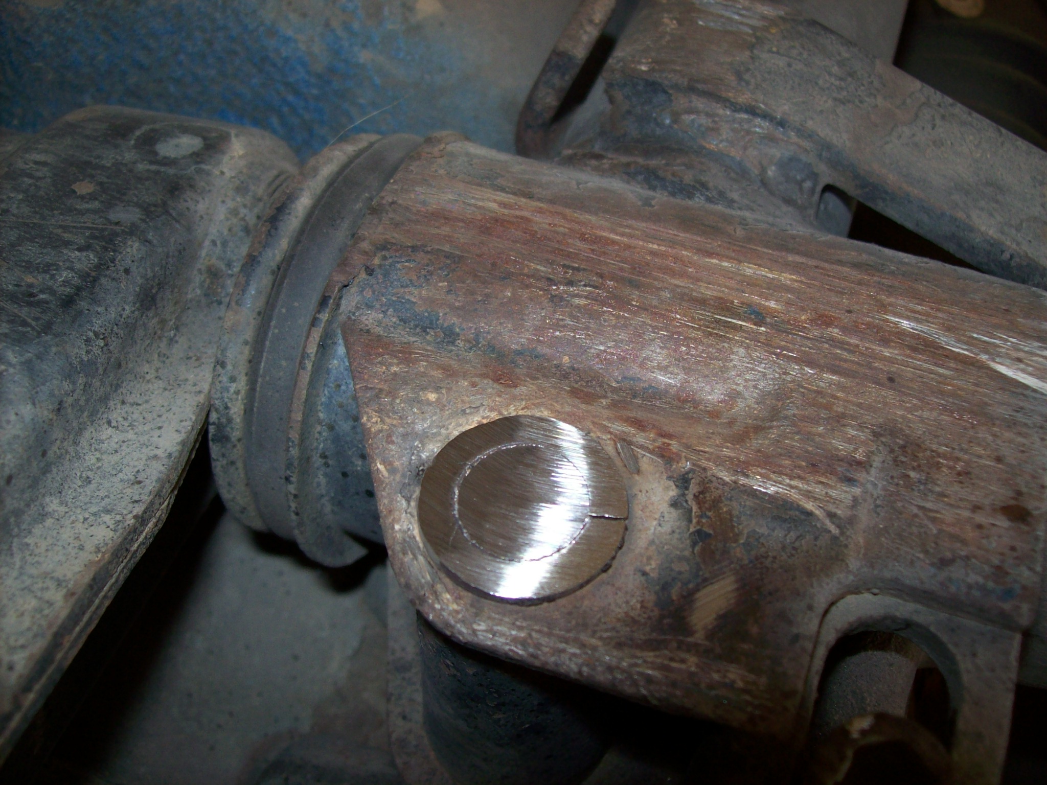

These are hardened bolts. These are not scuffed, or gouged...these are ground down to the point that there is little seperating them from the lock washers. Amazing. Probably a result of hitting those dog-gone autox cones so many times. This is going to either turn out badly or double badly.

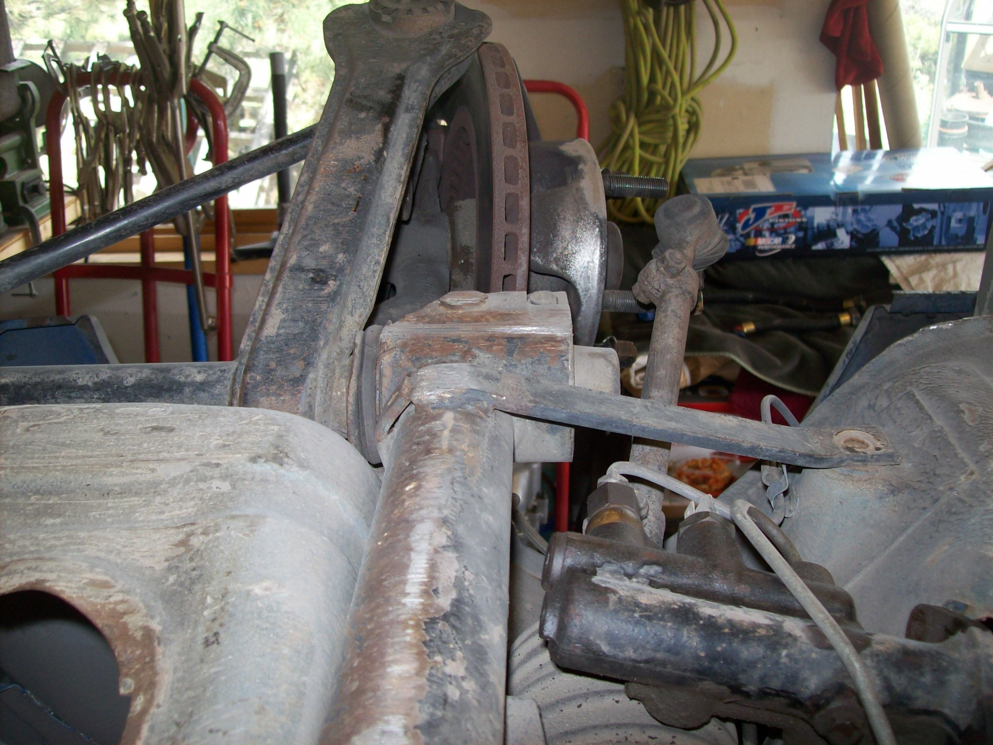

I will try to grind the remaining heads down to the washers
And pry the crossmember off the remaining headless bolts
Bingo...fortunately the bolts were not rusted to the inside of the crossmember. On 911s, this can happen on the early cars with steel crossmembers. With the later aluminum crossmembers, not a problem
Whew...feel like I dodged that bullet.
