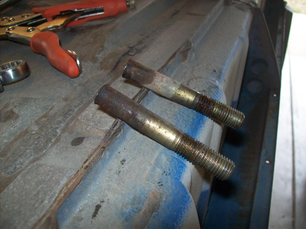

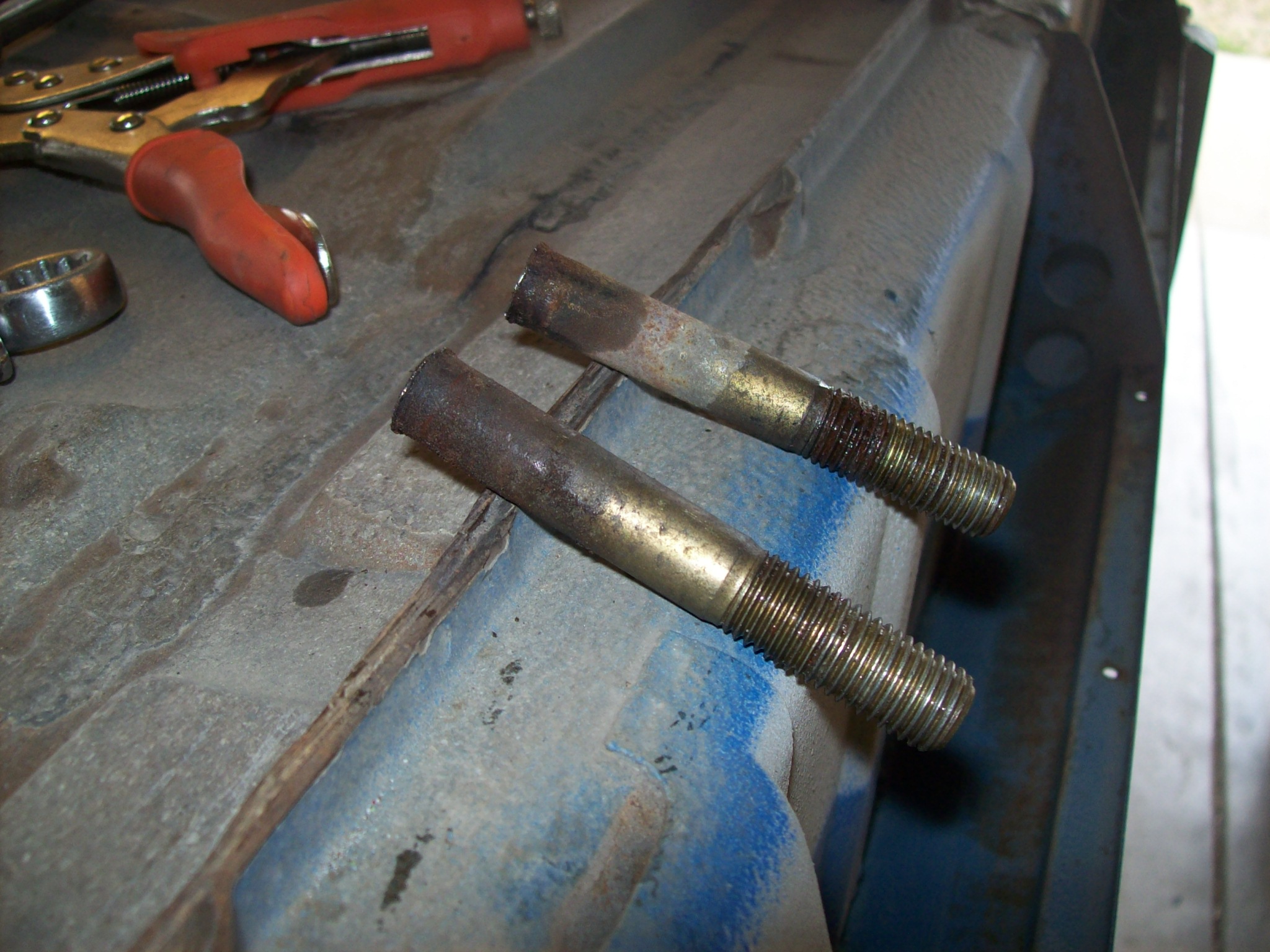

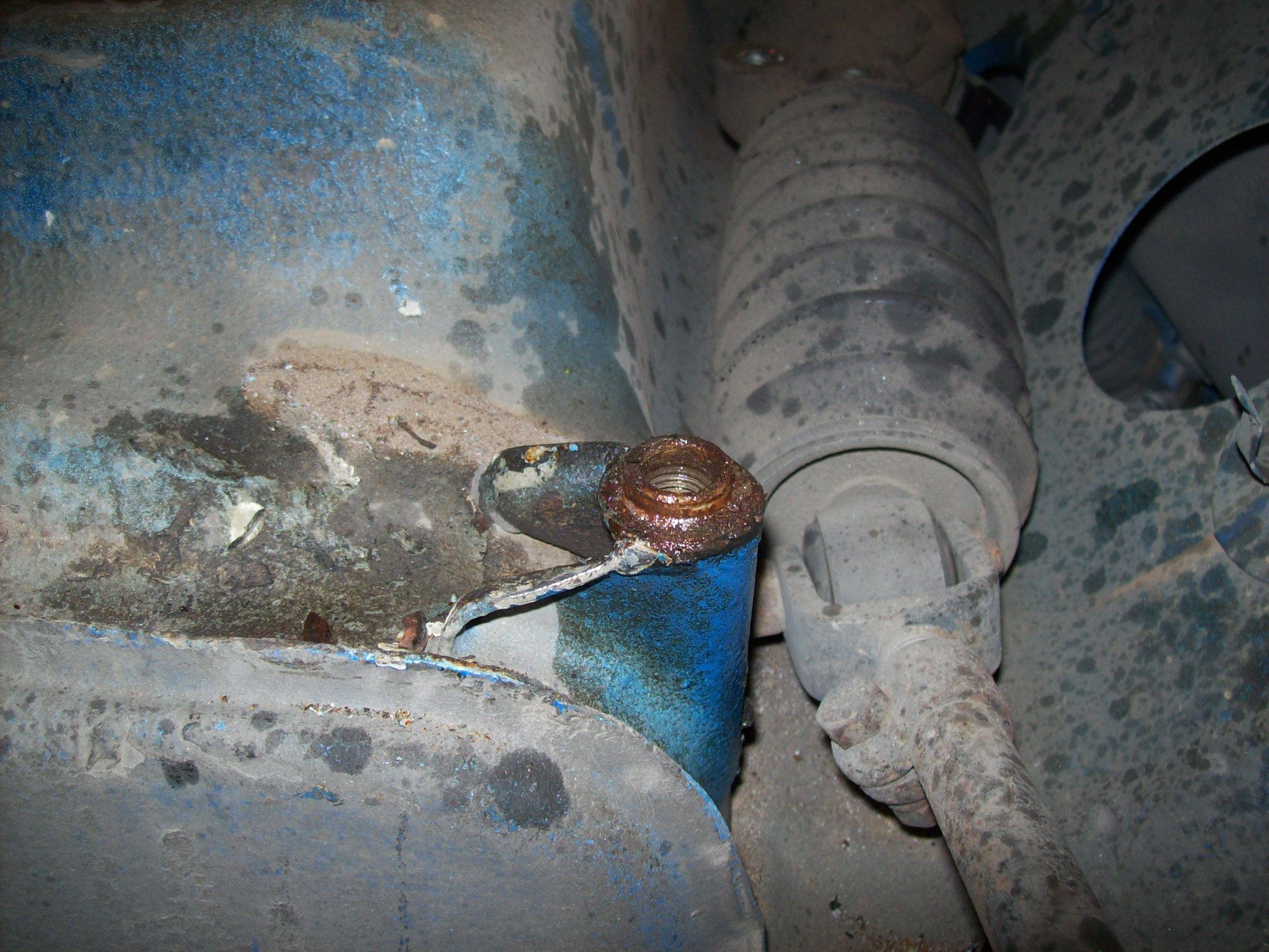

My next concern was whether or not the remaining bolts were rusted to the inserts in the chassis. I was lucky so far. Fortunately with some penetrating fluid, they backed right out
This is all that was left

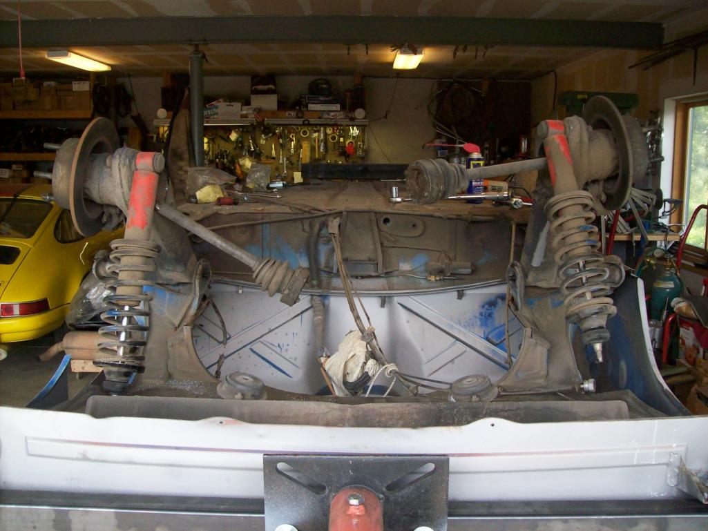

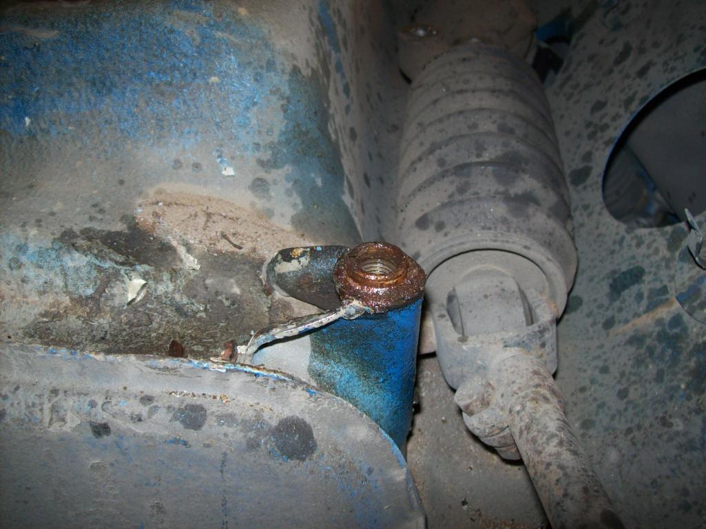

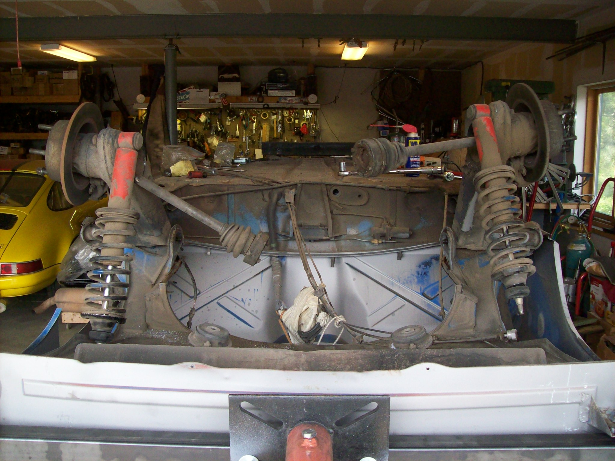

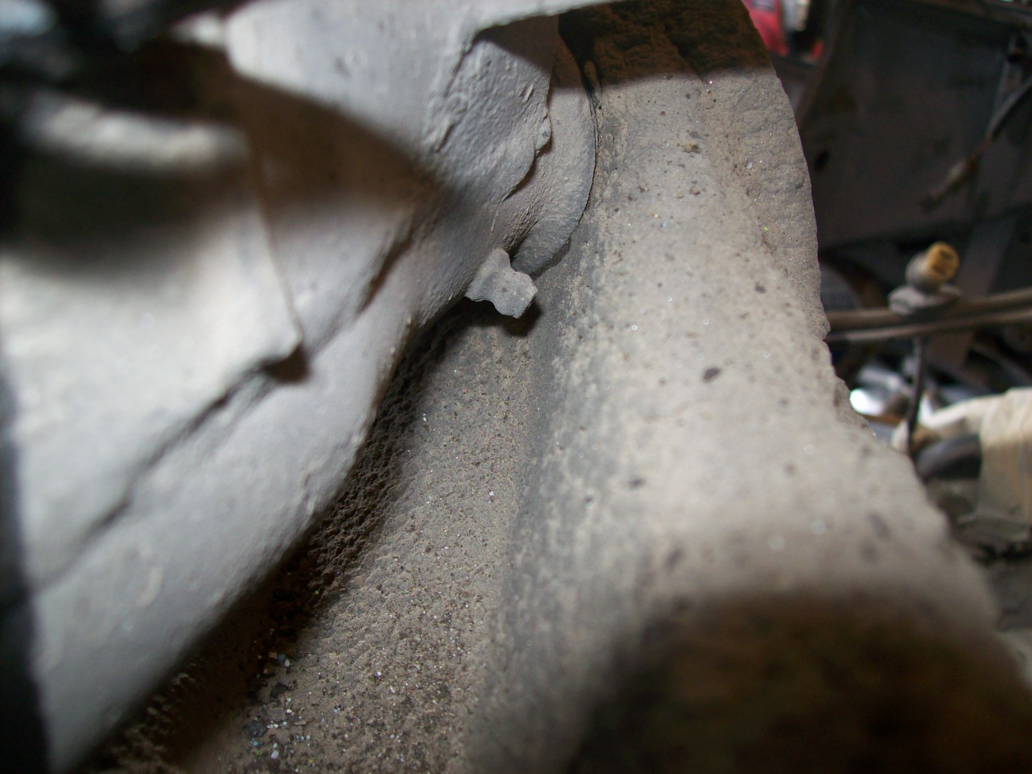

On to the rear suspension. As the 914 front suspension is identical to the 911 suspension...I was in my comfort zone. The rear is new territory for me.
BTW how do you get to this fitting to grease it? Is this factory?
Everything came apart as one might expect. This beast just lost about 700 pounds
Now I need to disassemble and clean up all the suspension components...maybe sandblast and repaint or powdercoat. Am I correct in thinking that the A-arms and crossmember and rear control arms were all semi gloss black? The struts will be their basic colors (Koni orange, Bilstein green, and Boge black)...right? Looks like I have Boge with some sort of aftermarket inserts.
