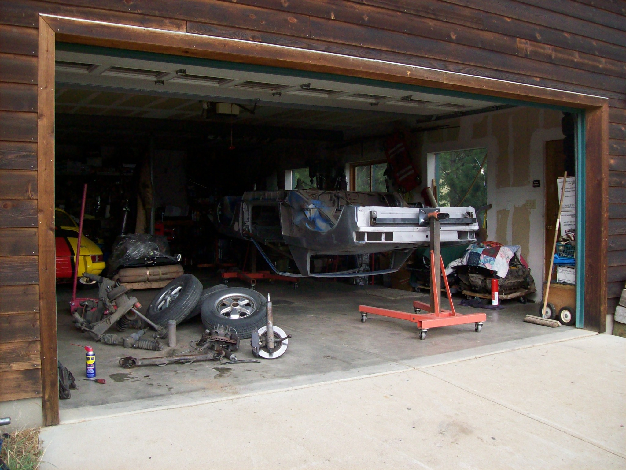

Long days work...but it feels good to get the car up in the air and get the suspension out of the way.

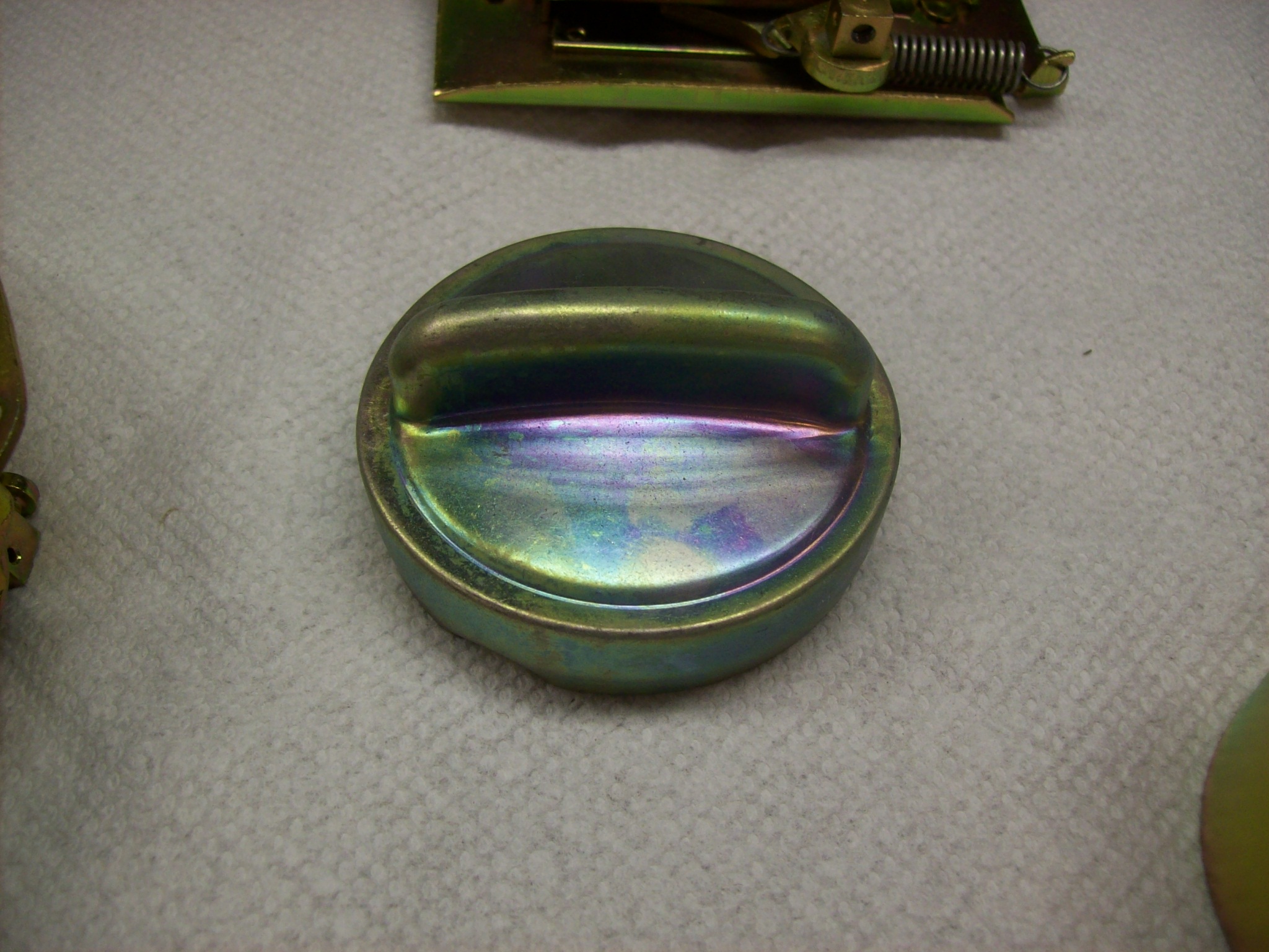

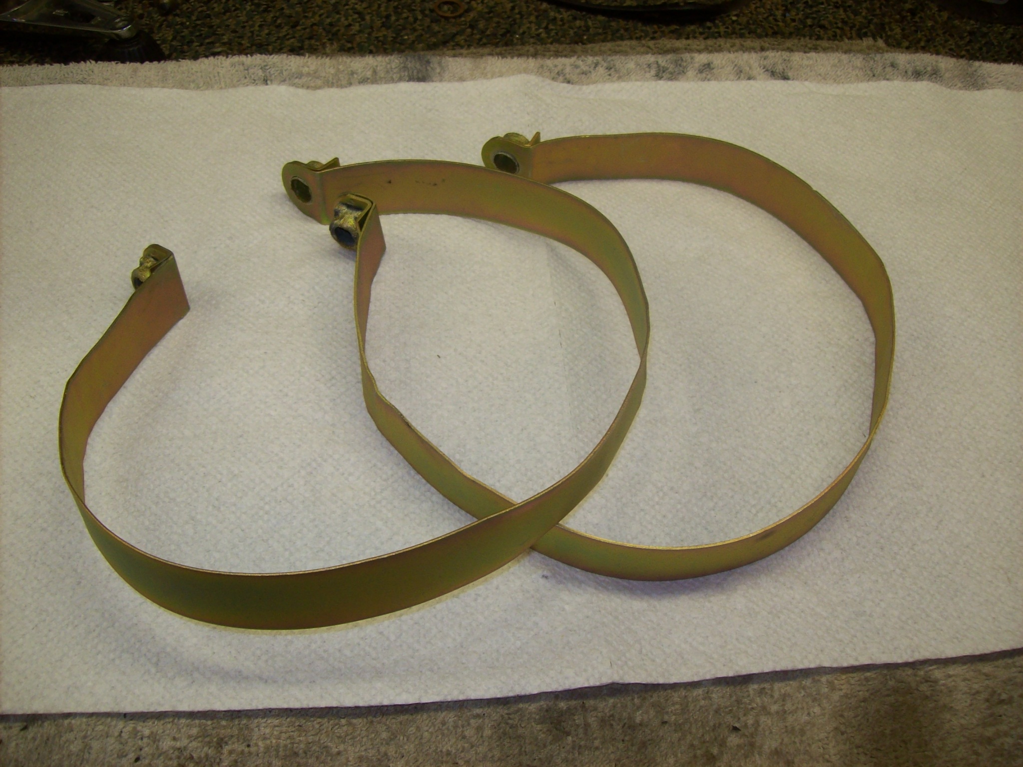

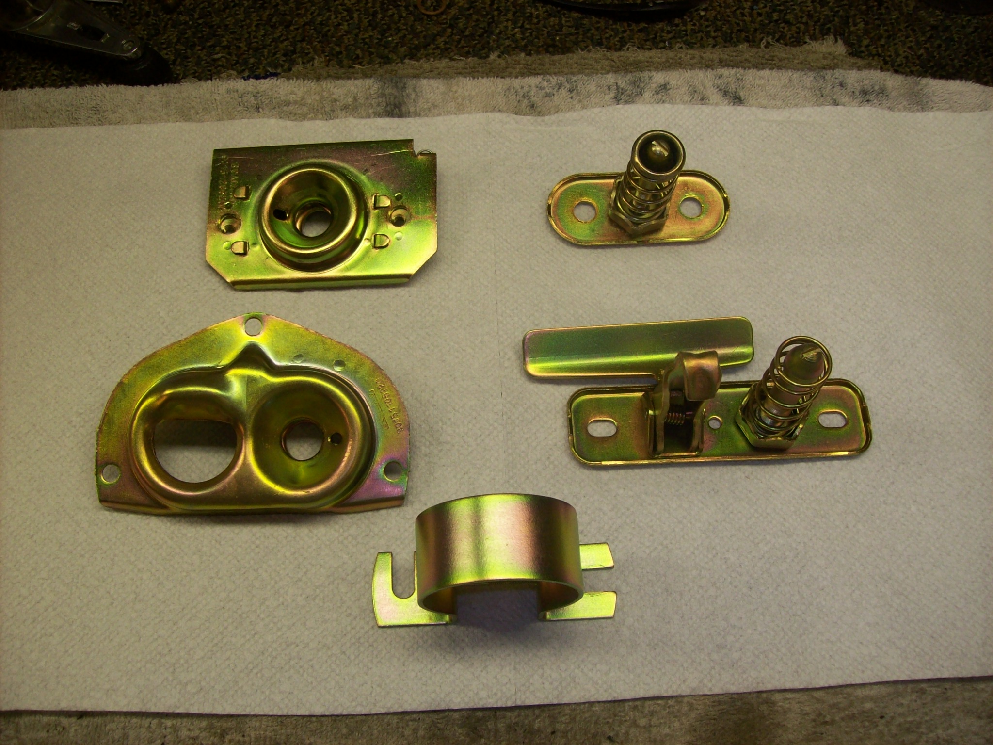

I got my plating (latches etc) back from the plater

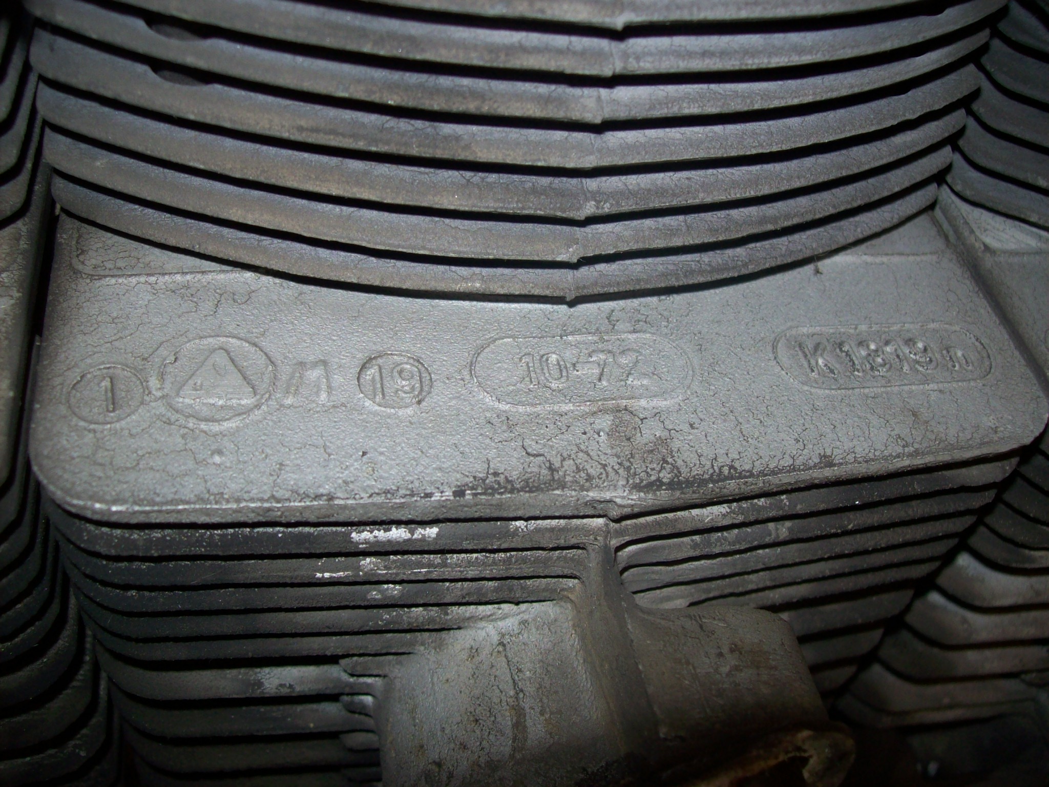

Still wondering about this engine...me thinks this is not a 2.7 at all...but a 2.4 instead.
I emailed the seller and he says that he built up the engine himself. I suppose a head dated in 72 could be an early 90 mm 2.7 head, but my guess is that it is an 85 mm head which would make it a 2.4 and I am fine with that. I measured the ports and they are 36 I and 35 E. With 2.4 S pistons and a Crane cam (S profile), that would mean likely the engine was built to 2.4 S specs...ok with me.
I sent the fan-shroud-strap and valve covers off with the engine tin to get powder coated. I will tear the engine down to short block and decide if I split the case at that point...TBD by what all I find. I am inclined to go to zero and have the case line bored and build it back up...but if the short block seems stout, and bearing are devoid of slop, maybe I clean it up and just do a top end.

sixnotfour   2.4 heads only need a chmfer to work for 2.7 PC...   Aug 12 2012, 12:51 PM
wachospeedo   2.4 heads only need a chmfer to work for 2.7 PC...   Aug 12 2012, 06:59 PM
