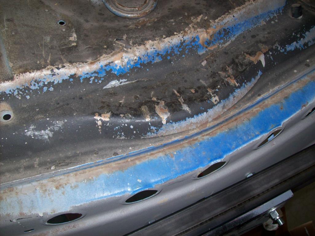

I took a few hours Friday afternoon,a couple yesterday, and a few more today. Almost ready for the blaster
yuck...passenger side. Drivers side looks ok. Before you question...yes I do have some hell-hole issues.

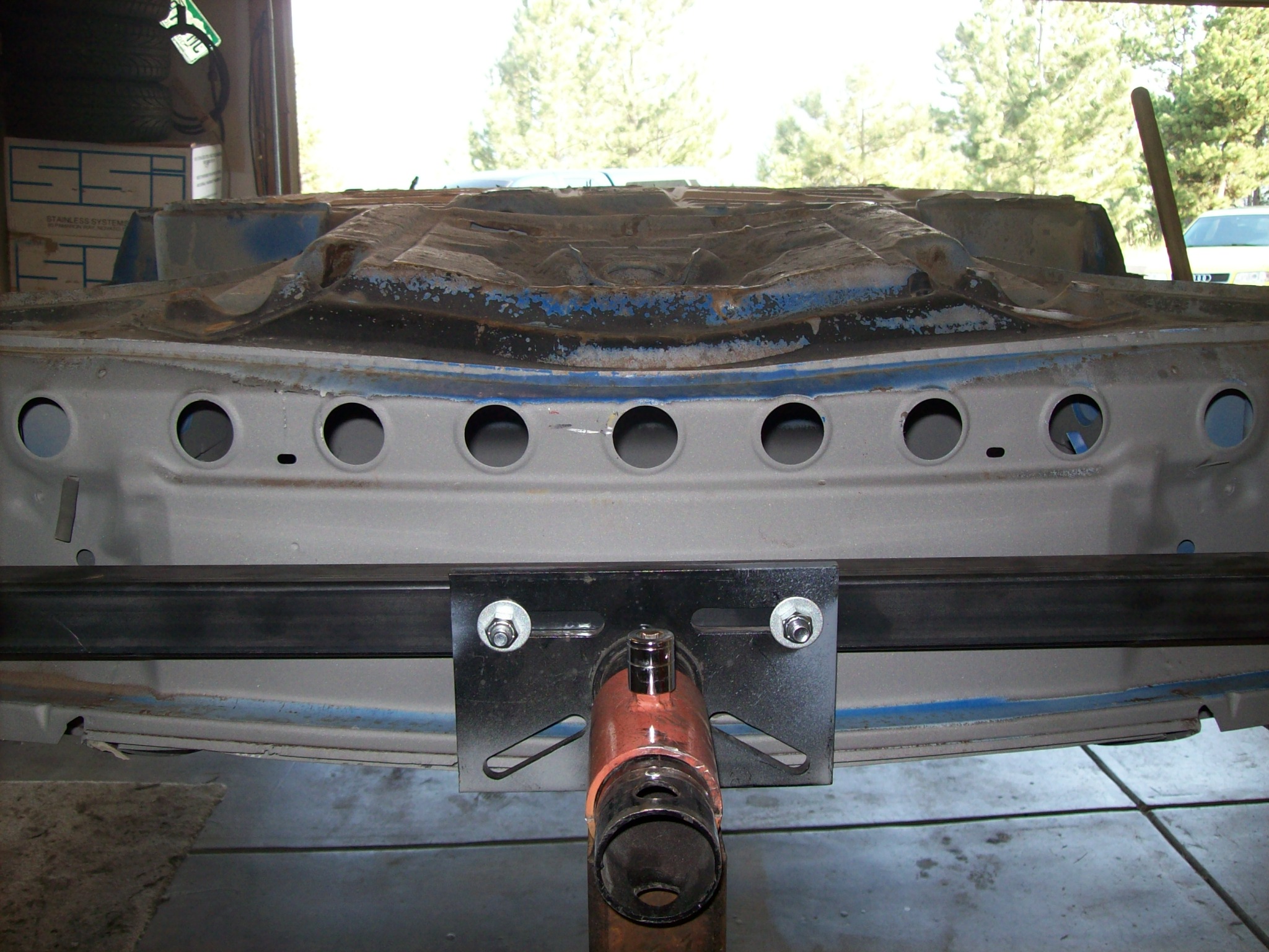

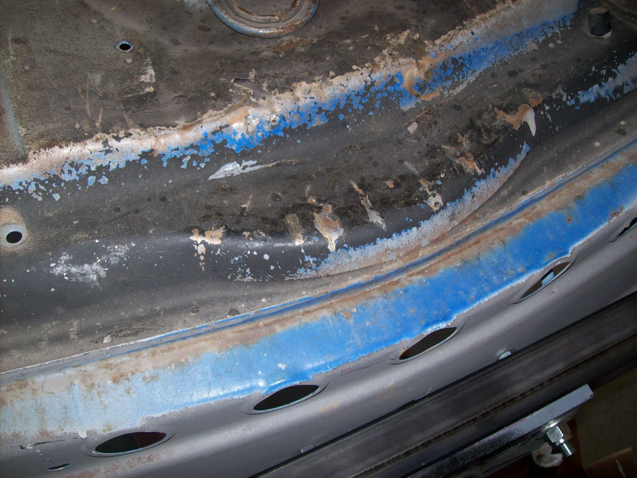

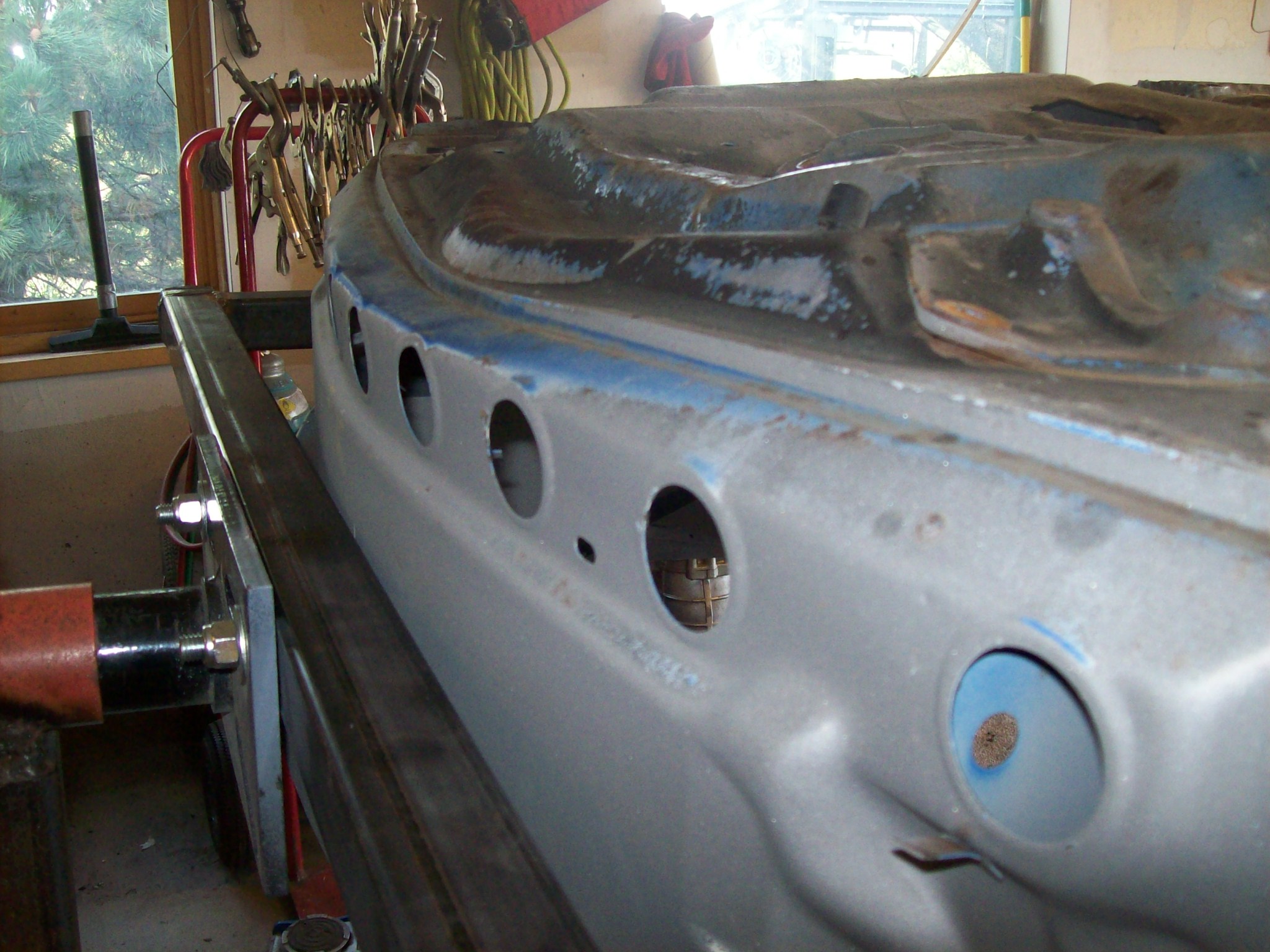

So I need to get a concensus as to whether where the front latch panel meets the floor panel is completely horizontal. From my pics, there is a minor arch. I can't believe that autox cones have symmetrically created this arch. I know that the front trunck pans are bowed upwards...but this looks factory. Responses encouraged...but be nice.

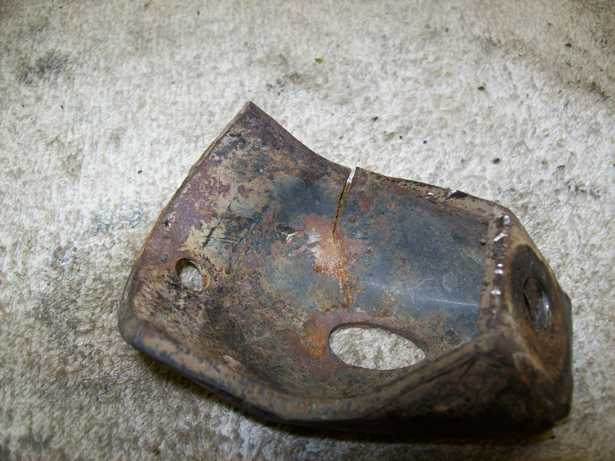

This guy served his purpose protecting the front of the A-arm...but needs to be welded back together again...

wachospeedo   So I need to get a concensus as to whether where t...   Aug 13 2012, 08:15 PM
seanery   That looks bent to me.   Aug 13 2012, 08:54 PM
brant   sorry but I agree... bent can people please add p...   Aug 13 2012, 10:40 PM
DEC   sorry but I agree... bent can people please add ...   Aug 14 2012, 03:07 AM
Cairo94507   Yup; should be flat.   Aug 14 2012, 06:25 AM
brant   Nice shot DEC does anyone have a frontal shot sho...   Aug 14 2012, 08:35 AM
