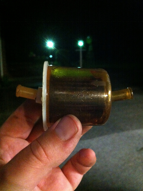

Years ago I ran one of Chris's stainless fuel lines through the tunnel. For years I considered selling the return line. Almost gave it away twice. Glad I didn't. I was not looking forward to running it in, but tonight I did just that. While I had the tank out, I also pulled all the carb related fuel stuff out.
One kinda scary thing... The fuel filter I put in ~2008 was clearly not intended for ethanol. It looked like this when I pulled it out.
(IMG:http://www.914world.com/bbs2/uploads_offsite/farm9.staticflickr.com-1435-1345257398.1.jpg)
The inlet and outlet were both deformed and degraded from the fuel. If you are using this type of filter - CHECK IT!
Also, there was a LOT more rust in the tank then there was in 2008 when the tank went back in the car. Not nearly enough to be worried about, but enough that I was really surprised when I put a flashlight in and looked around. Stupid alcohol.
