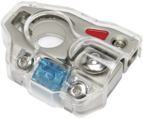

Adding the info on this battery terminal. Looks like a great idea, but a little pricey at about the $30.00 range.?
I am thinking of getting one to see how it looks and if I can use it with my fuse block. Would like to get the second one, but it is no longer available. Tom Edit: StreetWires BC2PF Fused Battery Clamp (+) AFS large pic. Attached image(s)
