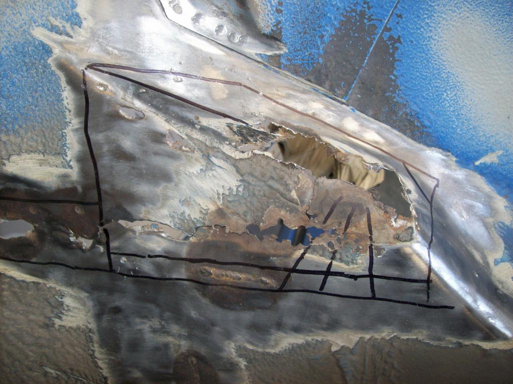

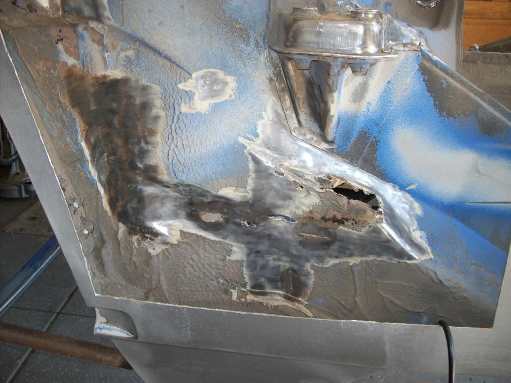

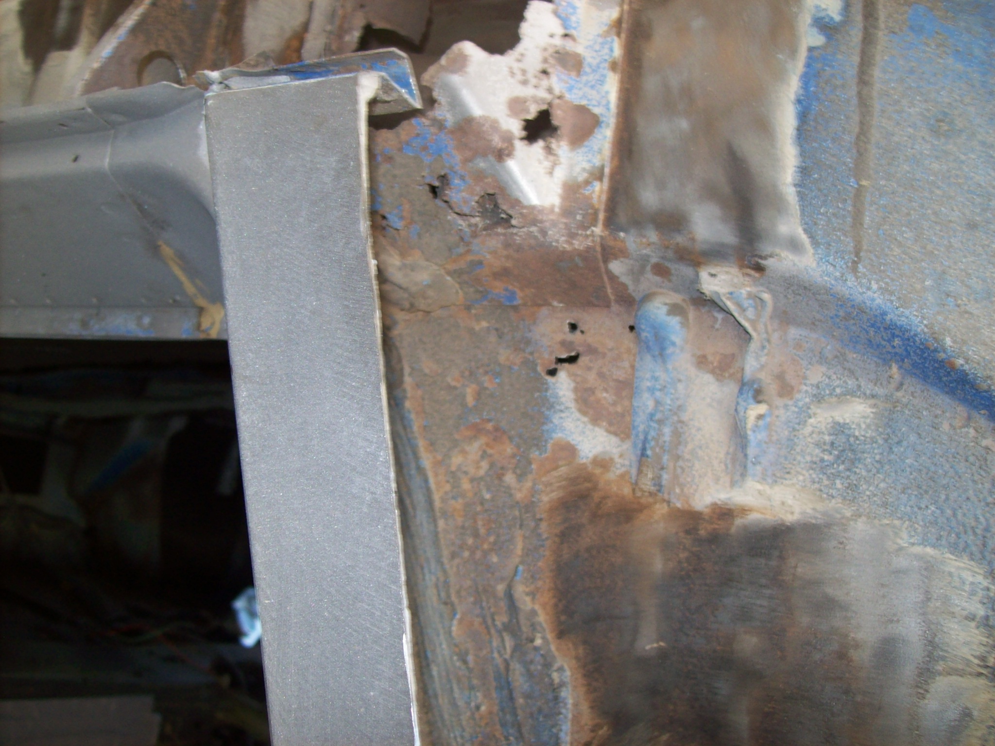

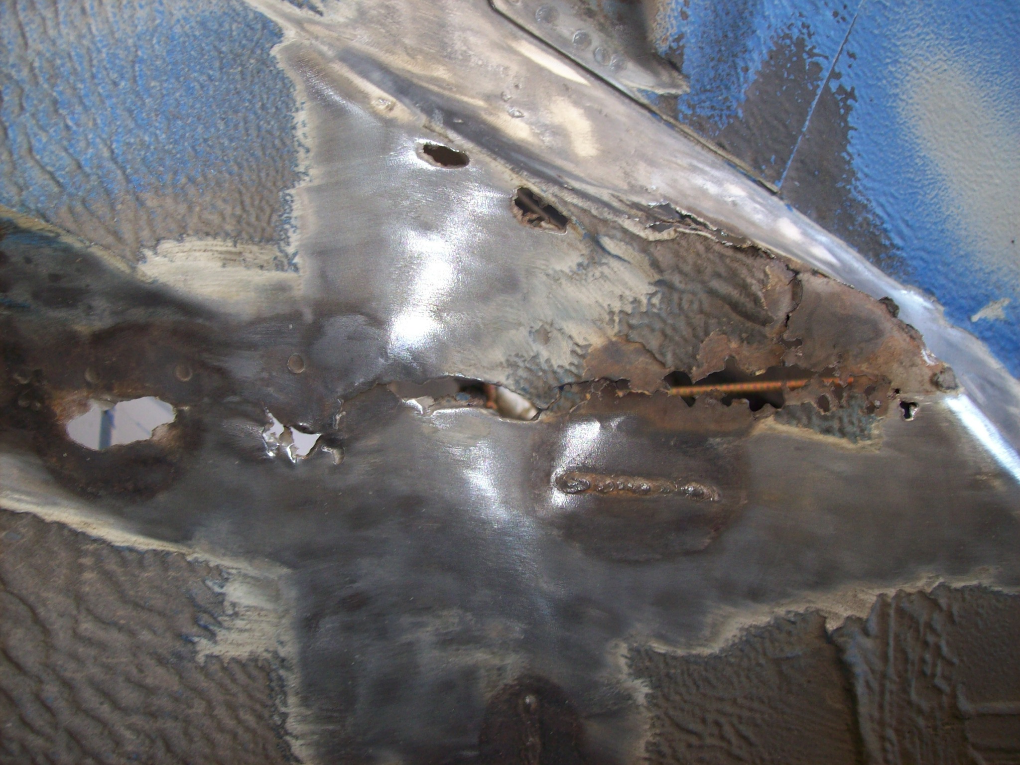

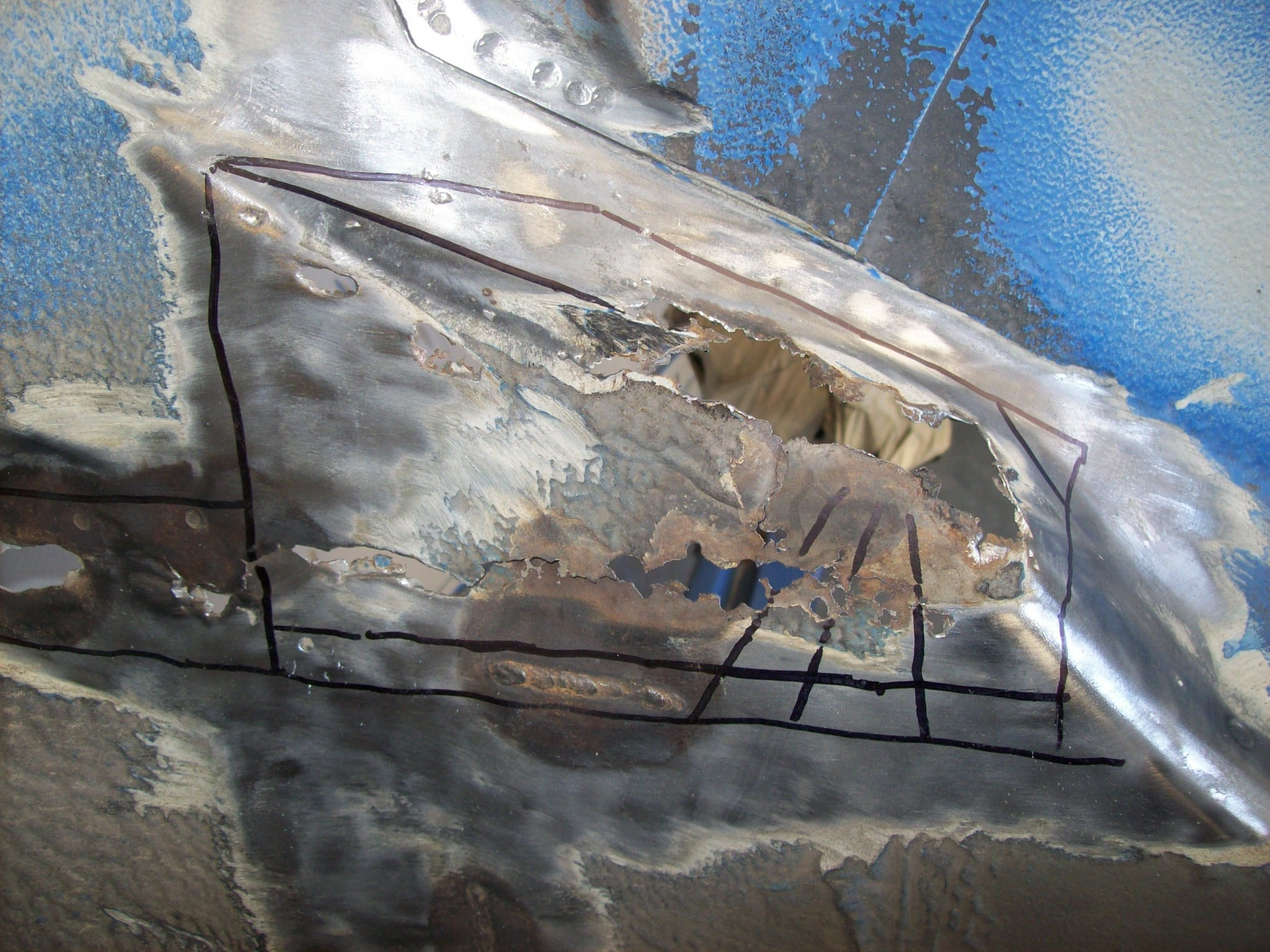

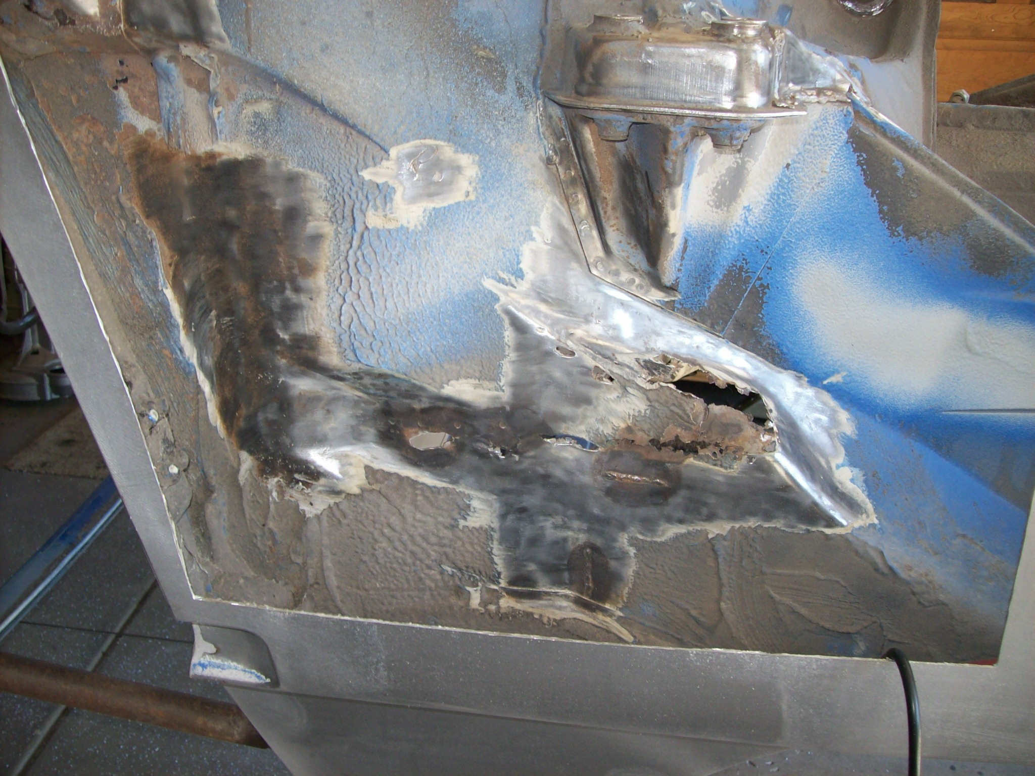

I was going to start hammering on the front end to bring the arch down...using a jack and a 6x6 timber on end to act as a bucking block...but when I applied pressure to the pan with the jack, it wanted to lift the front half of the rotisserie off the ground. Plan B...wait until the car is rotated rightside up and hammer down against the bucking block. Brant offered to let me come out to see the underside of his black car as he was going to remove the front bumper. I decided to get the welding going instead. So I decided to launch into the welding...here
I need to get the wire brush out to see where the rust starts and ends...

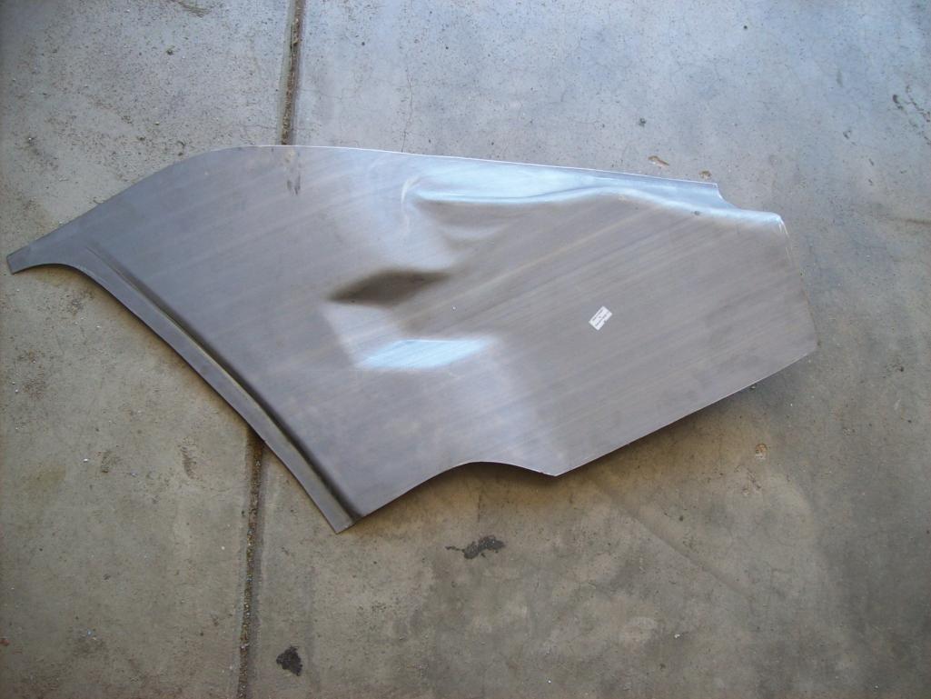

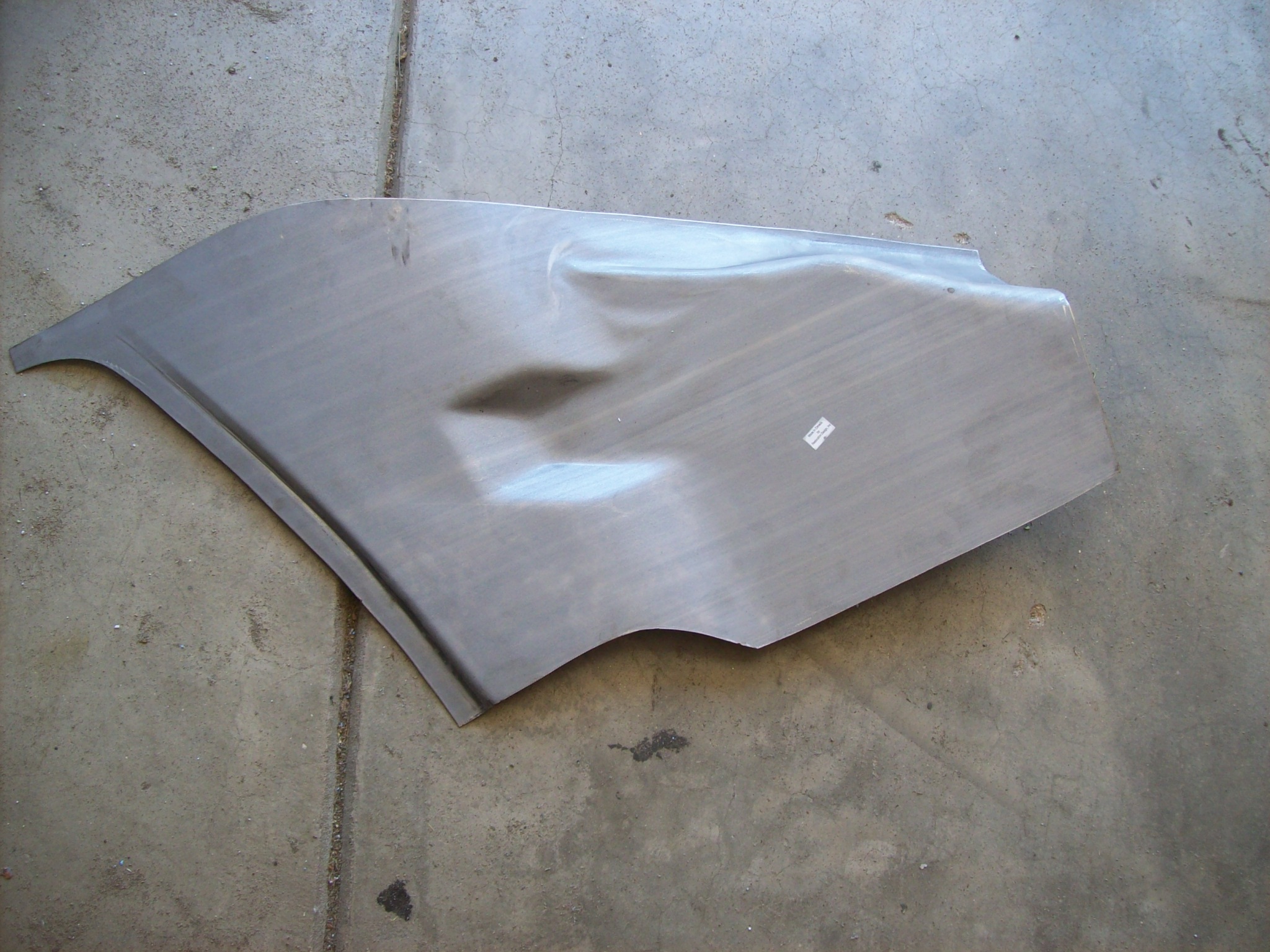

So this is the nice resto design replacement outer longitudinal...but I don't think I need this much.
I only need to replace a decent size area, and up here a bit also needs to be scabbed in...
I think I will save this nice peice and patch this area myself. What I have to work with...
I will try to visualize how the steel needs to be shaped to fit the replacement area.
