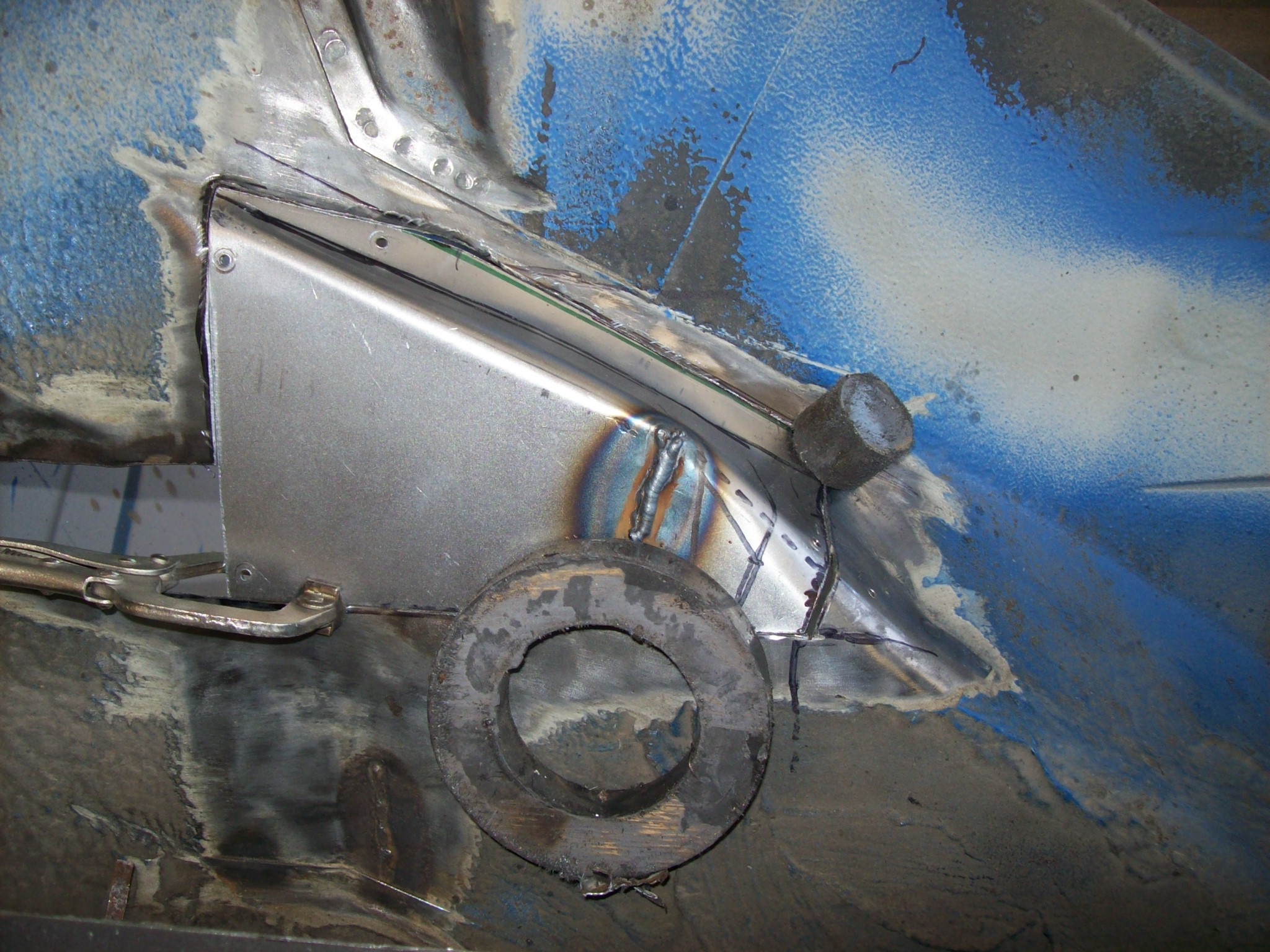

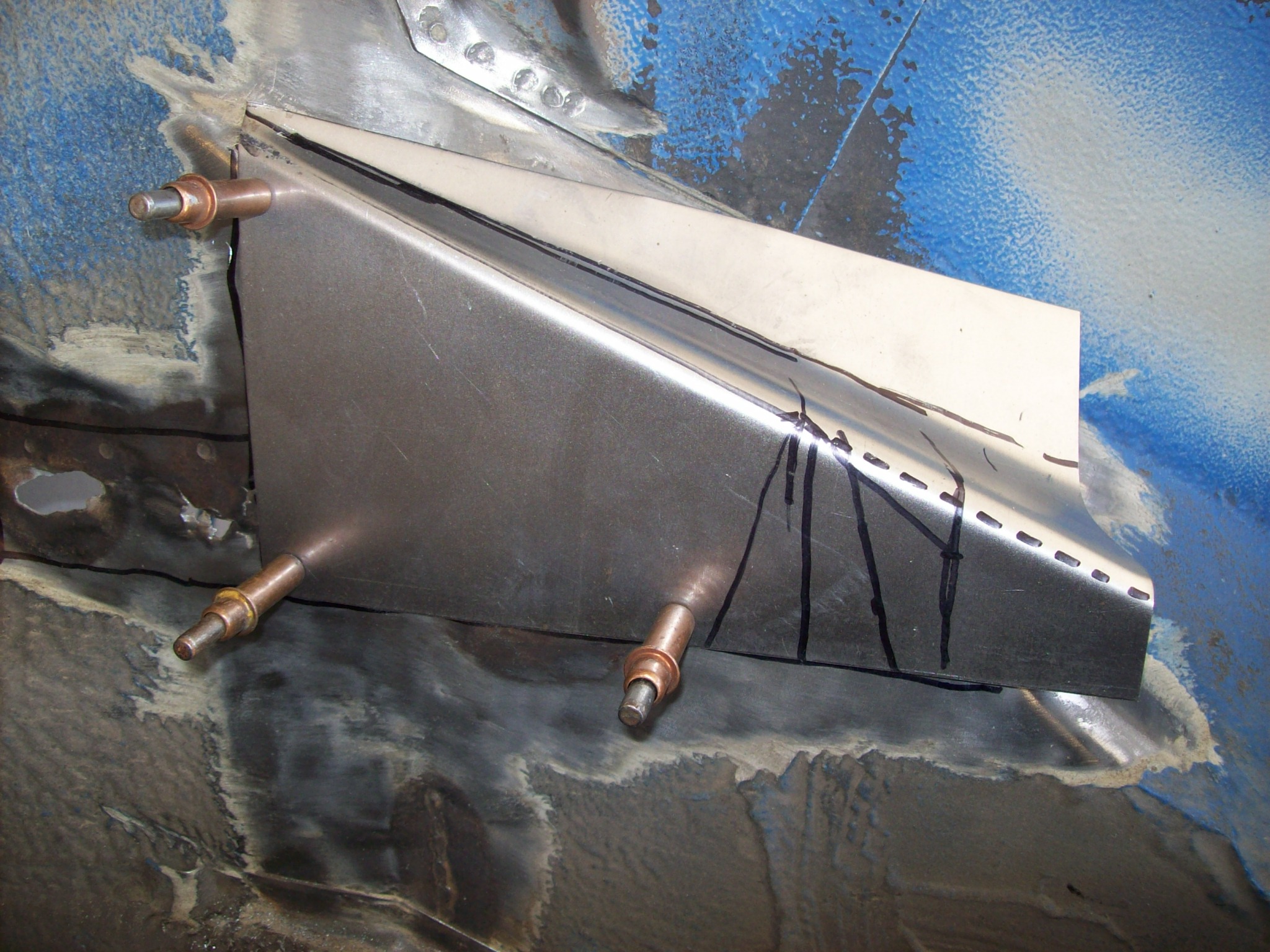

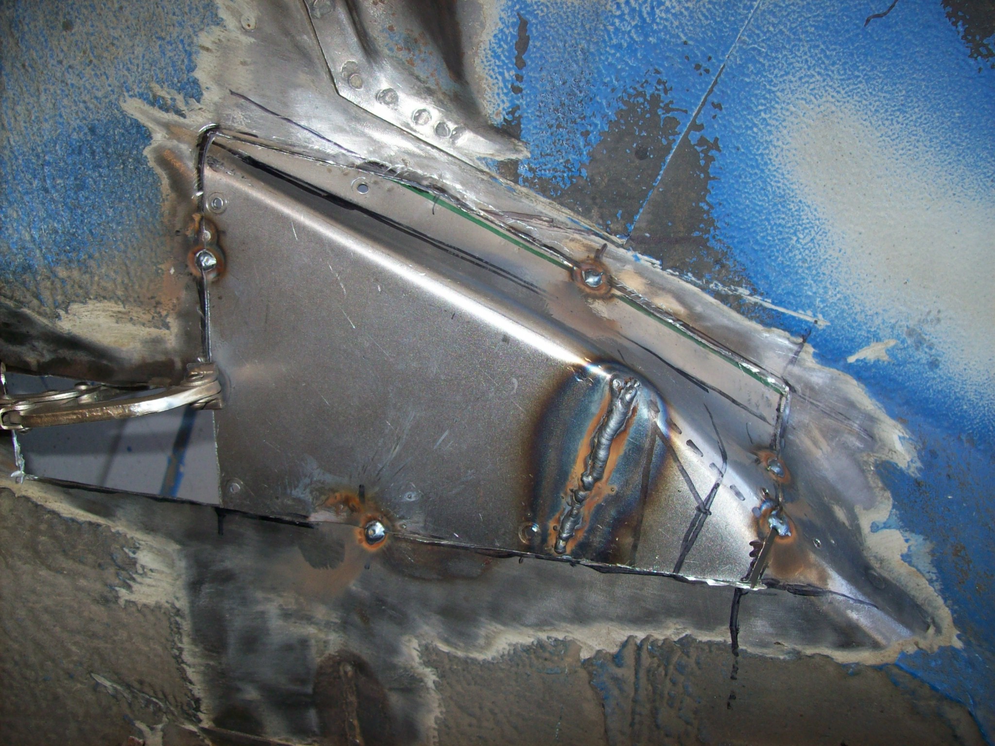

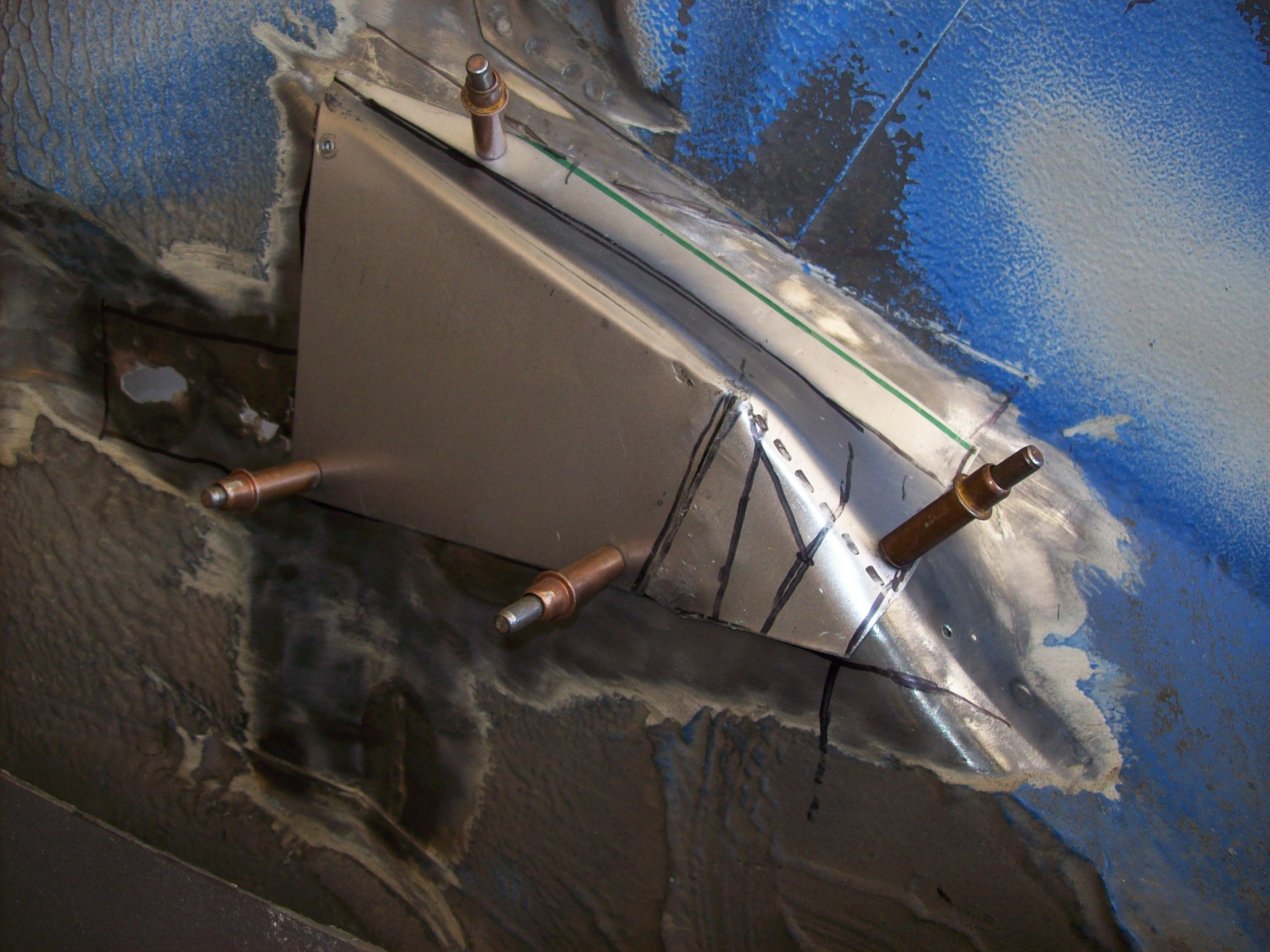

I like the fab work...so we start. Peter's part was a nice one, so I have to be able to create a part nice enough to justify not using his. I am not going to walk you through the process...you all know how this goes.
Now I need to add the dogleg and stich it all in place
