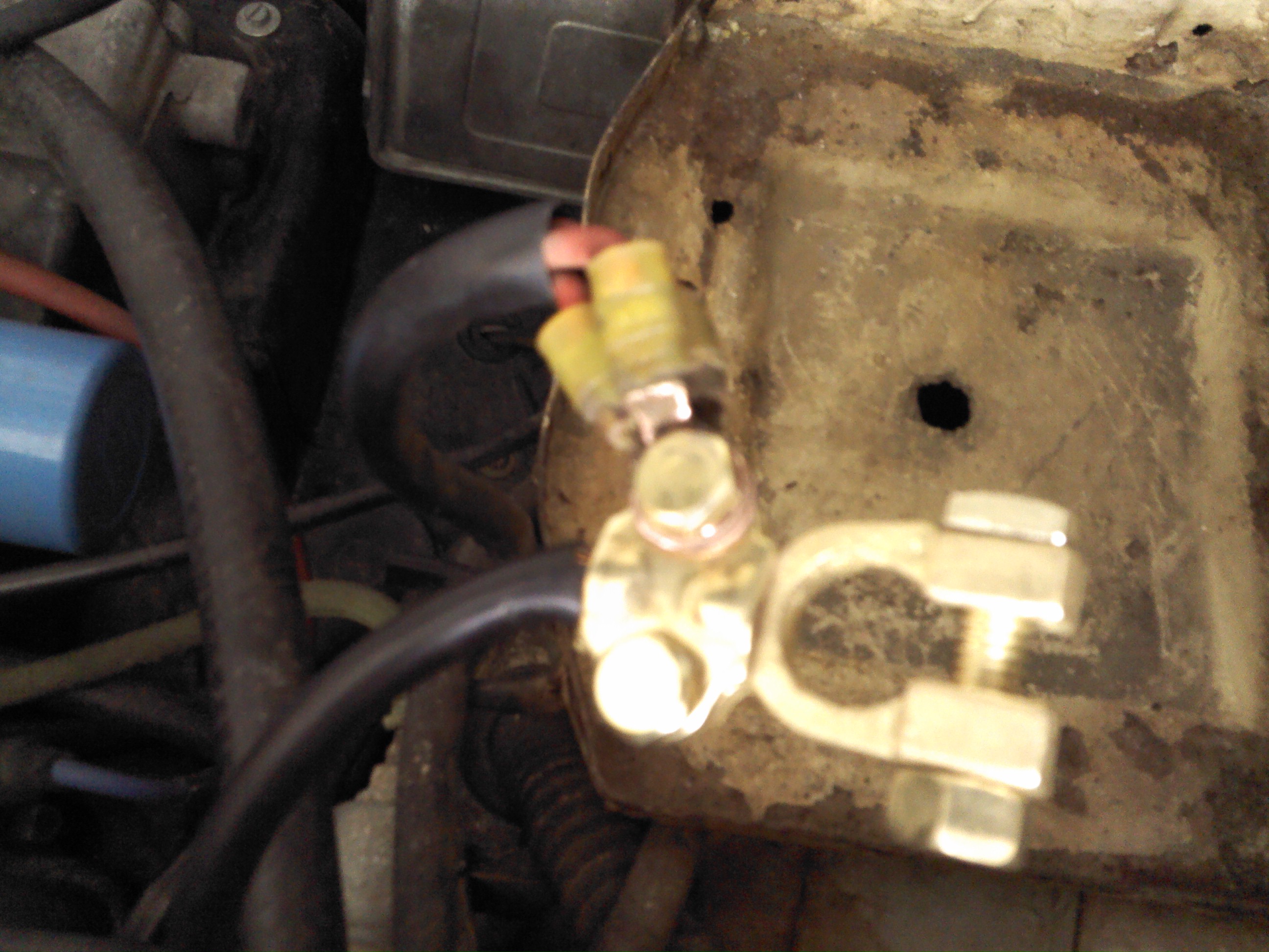

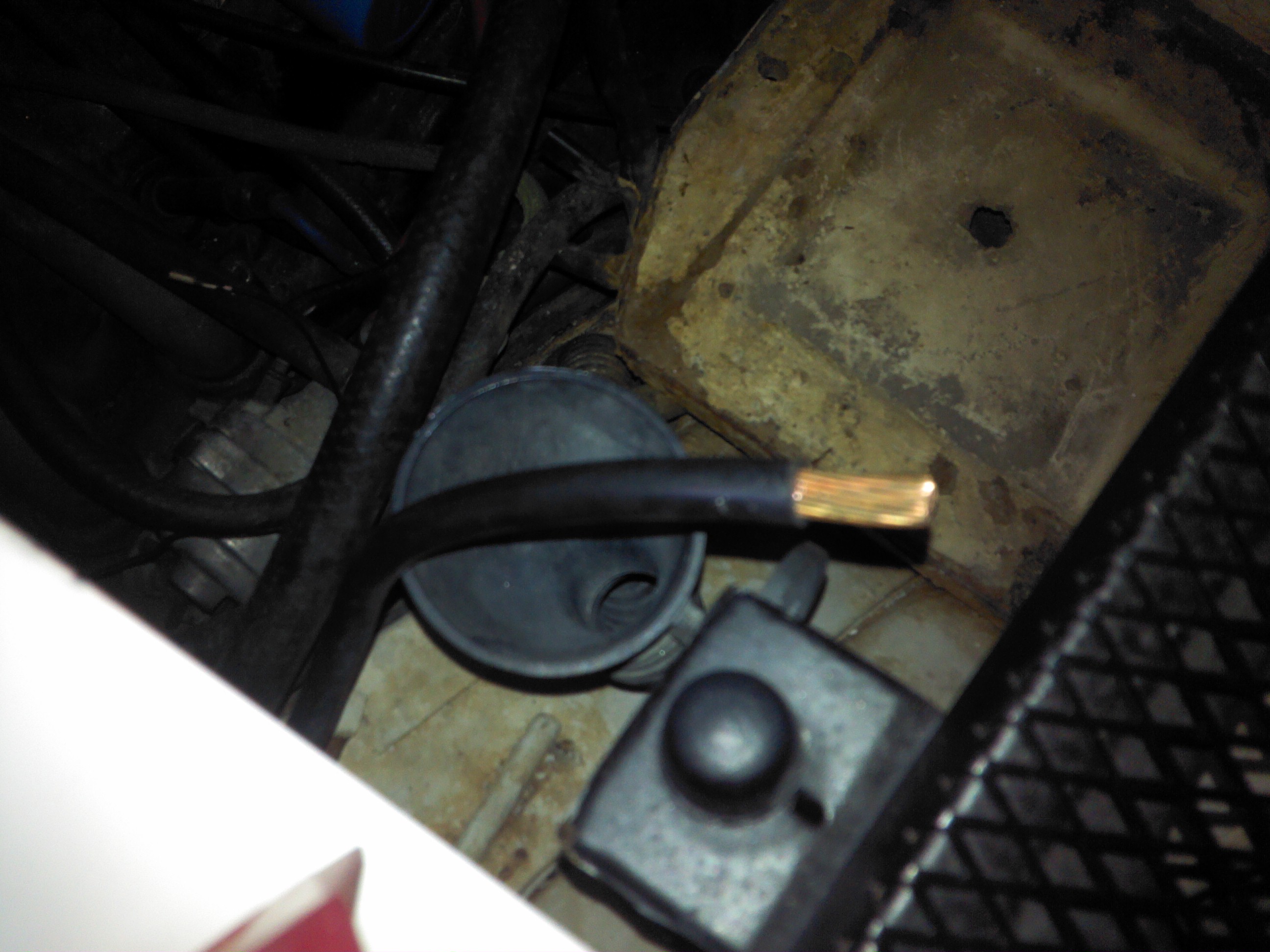

SUCCESS!!! (IMG:style_emoticons/default/cheer.gif)
I replaced the positive battery terminal connection (you were right toadman!).
and cleaned up the connections on that terminal, and she fired right up!
So I have a good back up starter, and I learned a thing or two.
Thanks everyone for helping, I really appreciate it.
Turk
