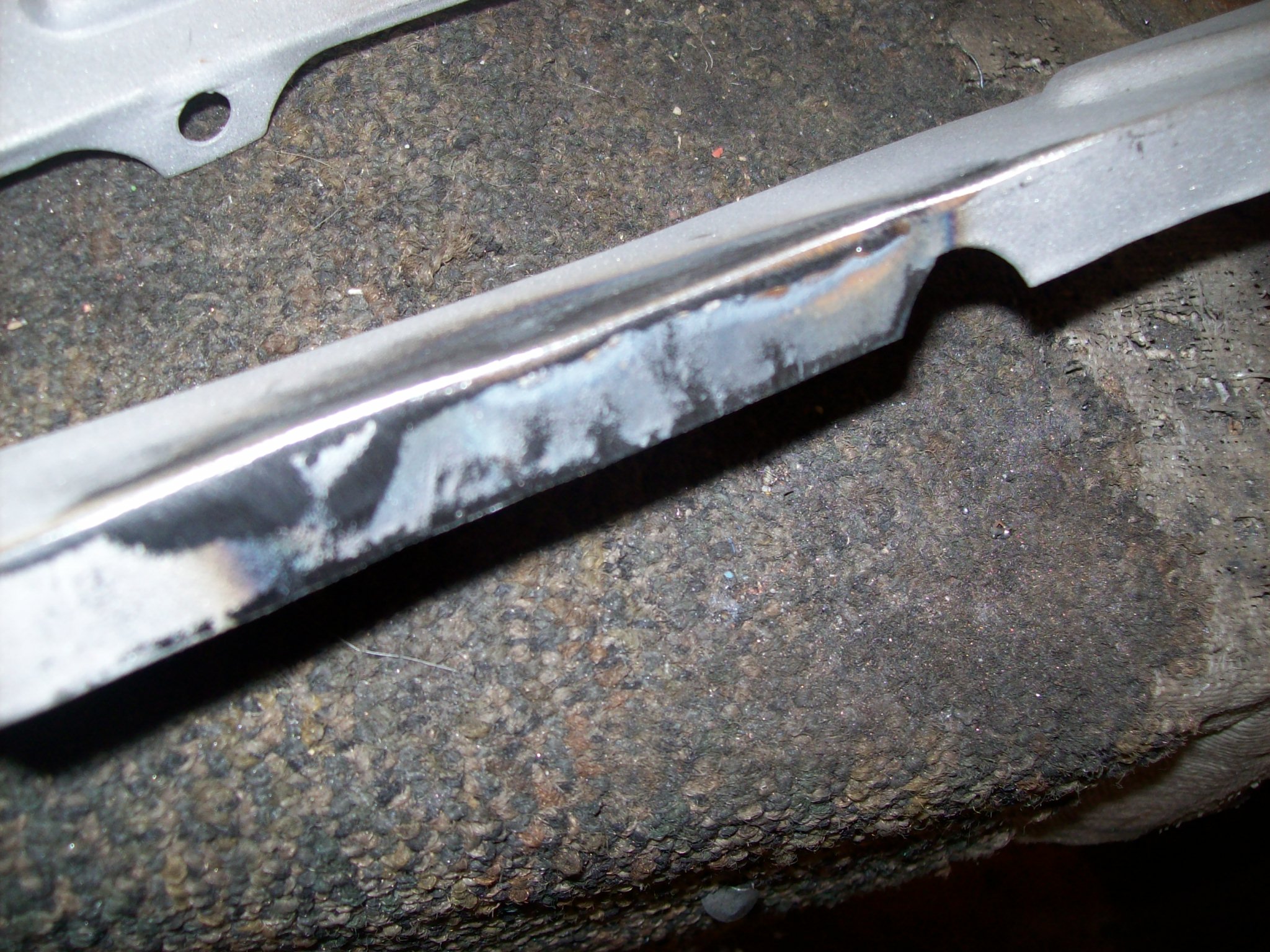

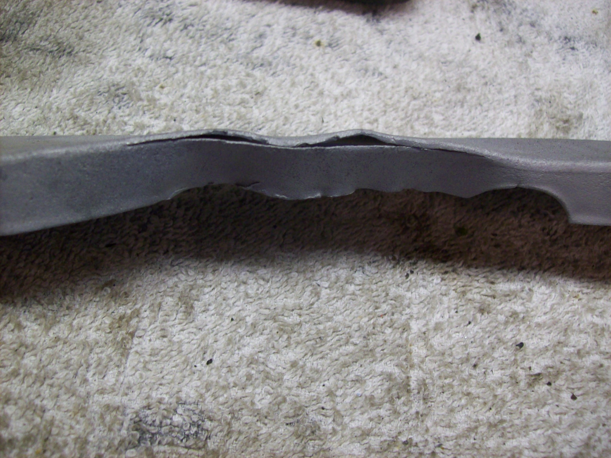

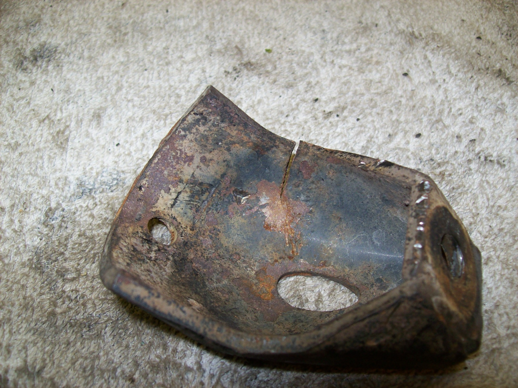

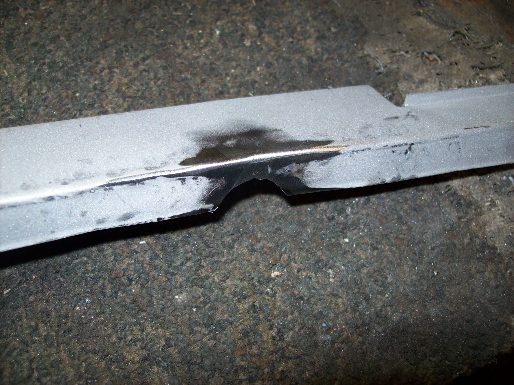

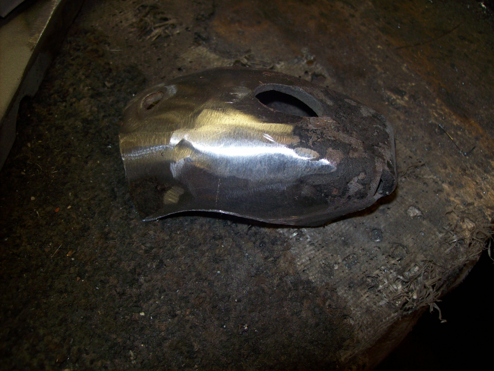

The engine tin that was bent and cracked also was going to be too expensive to replace...so while the welder was out, thin welding repairs occurred. Finally the front cracked A-arm cover was due.
The before...
The after...
