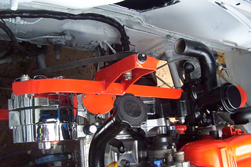

I think you should go with the GM alternator. I run a GM style Powermaster 180 Amp unit. There is no advantage to keeping the stock VR unless you intend to concourse the car.
Biggest upgrade for the buck is up sizing all wires. I run a #2 charge wire and have upgraded all grounds. I bet your stereo wiring is bigger than most of the stock 914 wiring. Add extra grounds, bigger wire. Add a ground from the alternator to the battery.
PLEASE SHOW US SOME PICS OF HOW YOU FIT AND SET IT UP. (IMG:style_emoticons/default/piratenanner.gif)

QUOTE(pnewman @ Aug 21 2012, 09:52 PM) *
Don't get too excited... I don't have a T4 engine... Don't you read my build thread?
