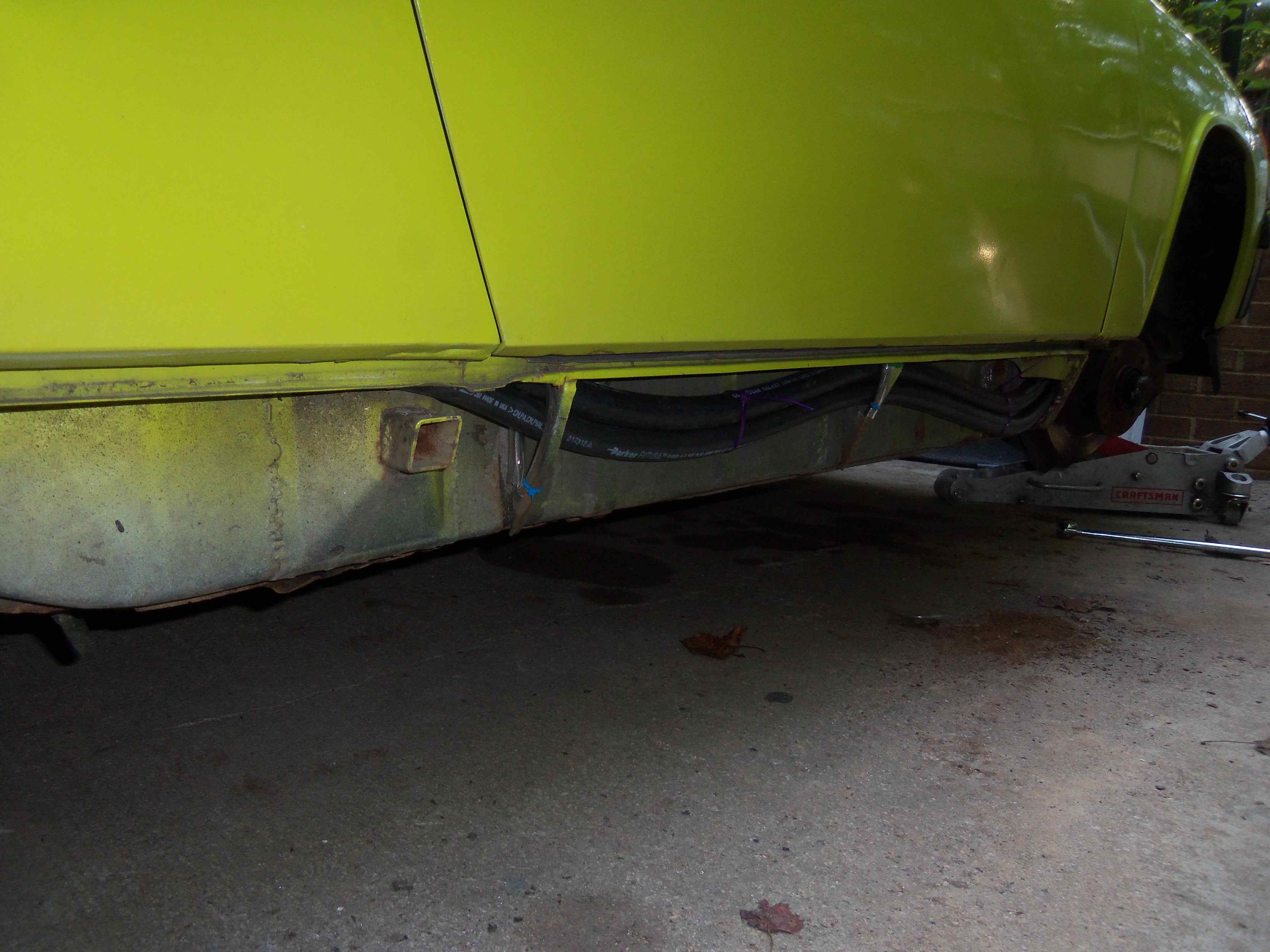

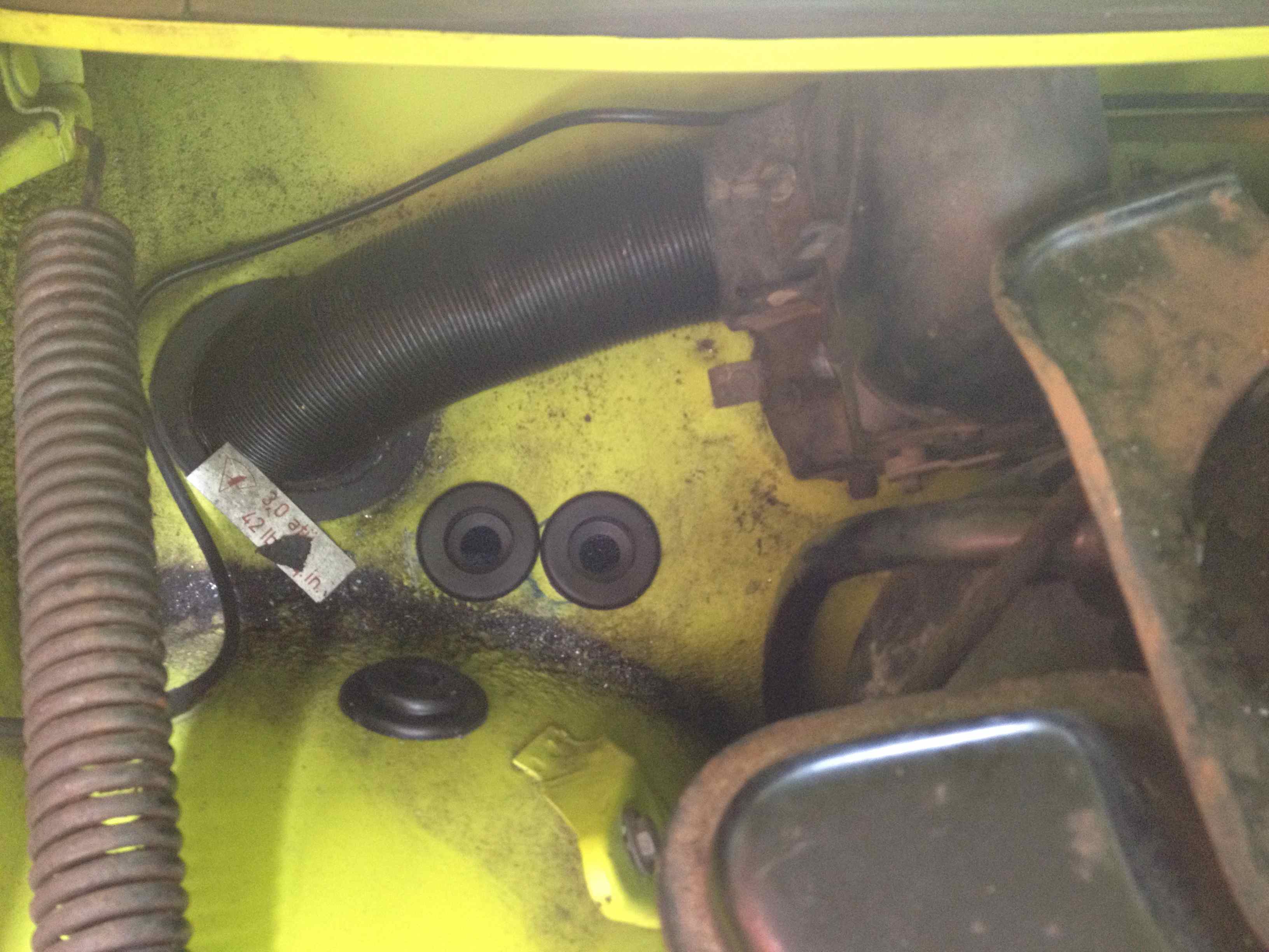

After getting the condenser in I began routing my lines and drilling holes. The grommets I used require a 1.5" hole. I ran my lines similar to that in an original system. There are probably better ways to route the lines however my setup works just fine. Plus they will probably get redone when a redo my car in a few years. I still have to button up the lines in a few areas. The pictures below are mostly during mockup.
I order 13ft of #8 and #10 hose and 9ft of #6 hose. I ended up with about a foot left of each so it was just the right amount.
