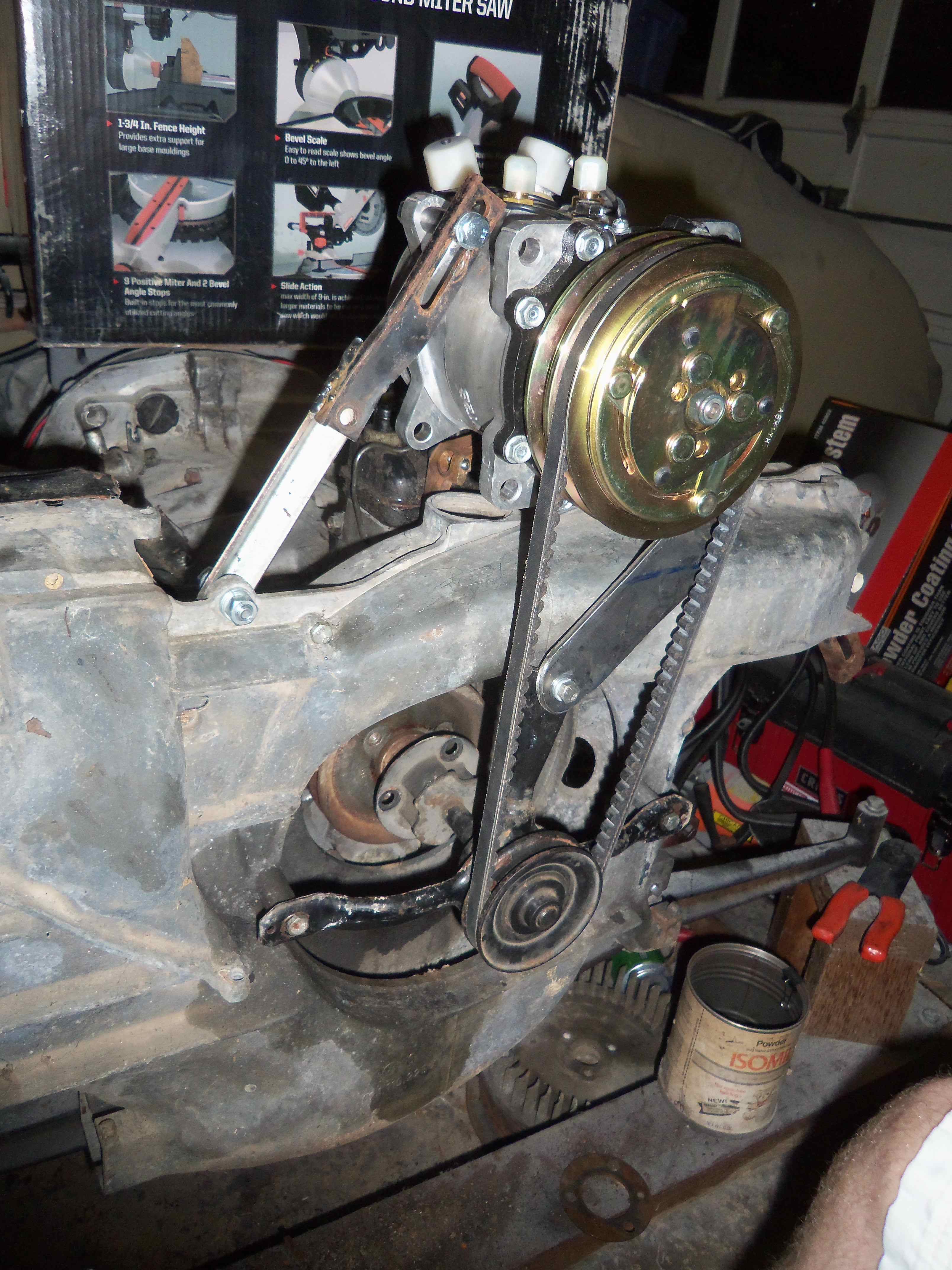

dlee6204   Onto the compressor... I decided to go with a to...   Aug 23 2012, 06:33 PM
dlee6204   Some more pictures on the test engine. I ended...   Aug 23 2012, 06:38 PM
dlee6204   More Finished   Aug 23 2012, 06:43 PM

dlee6204   I thought I would share some additional informatio...   Aug 26 2012, 08:12 PM

dlee6204   I made some progress on my A/C pulley. As I state...   Nov 25 2012, 04:12 PM
zambezi   looks like a great design. very similar to my cas...   Nov 25 2012, 05:09 PM

dlee6204   I just finished making a new mount. :) I'm...   Dec 15 2012, 08:55 AM

dlee6204   Agreed :D So, what's the weakest link in th...   Dec 15 2012, 09:40 PM
