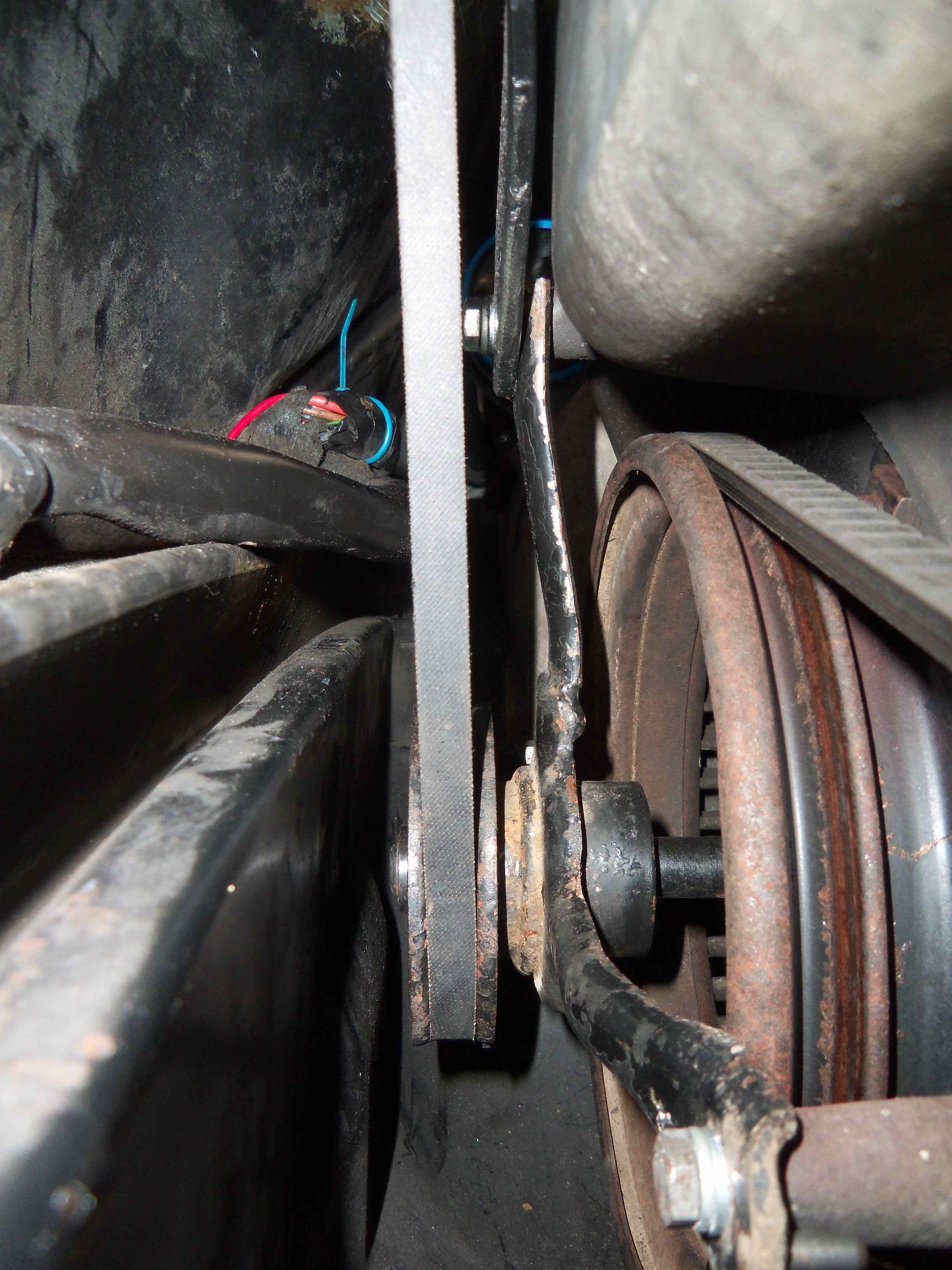

Thanks for the pictures. I think my setup is a little closer to the firewall than yours. I have a little more clearance between the belt and fan shroud.
I have a little under 2 inches to the firewall
