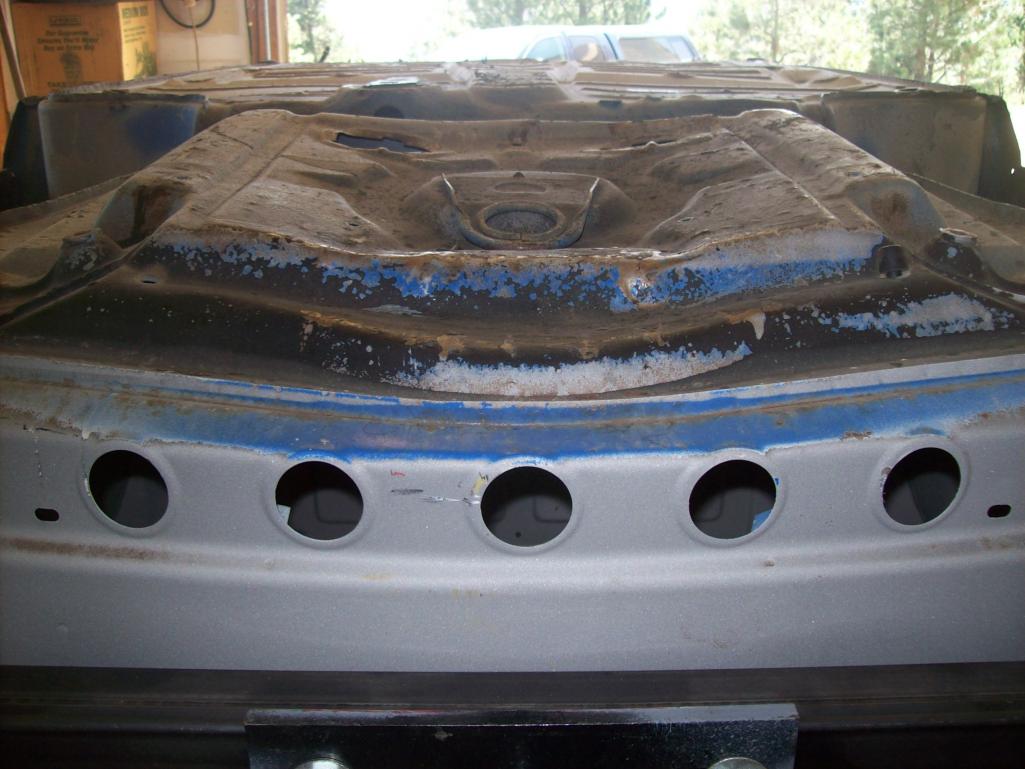

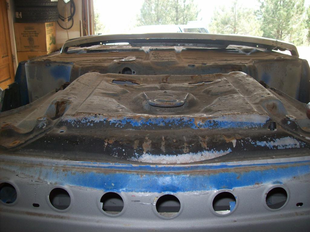

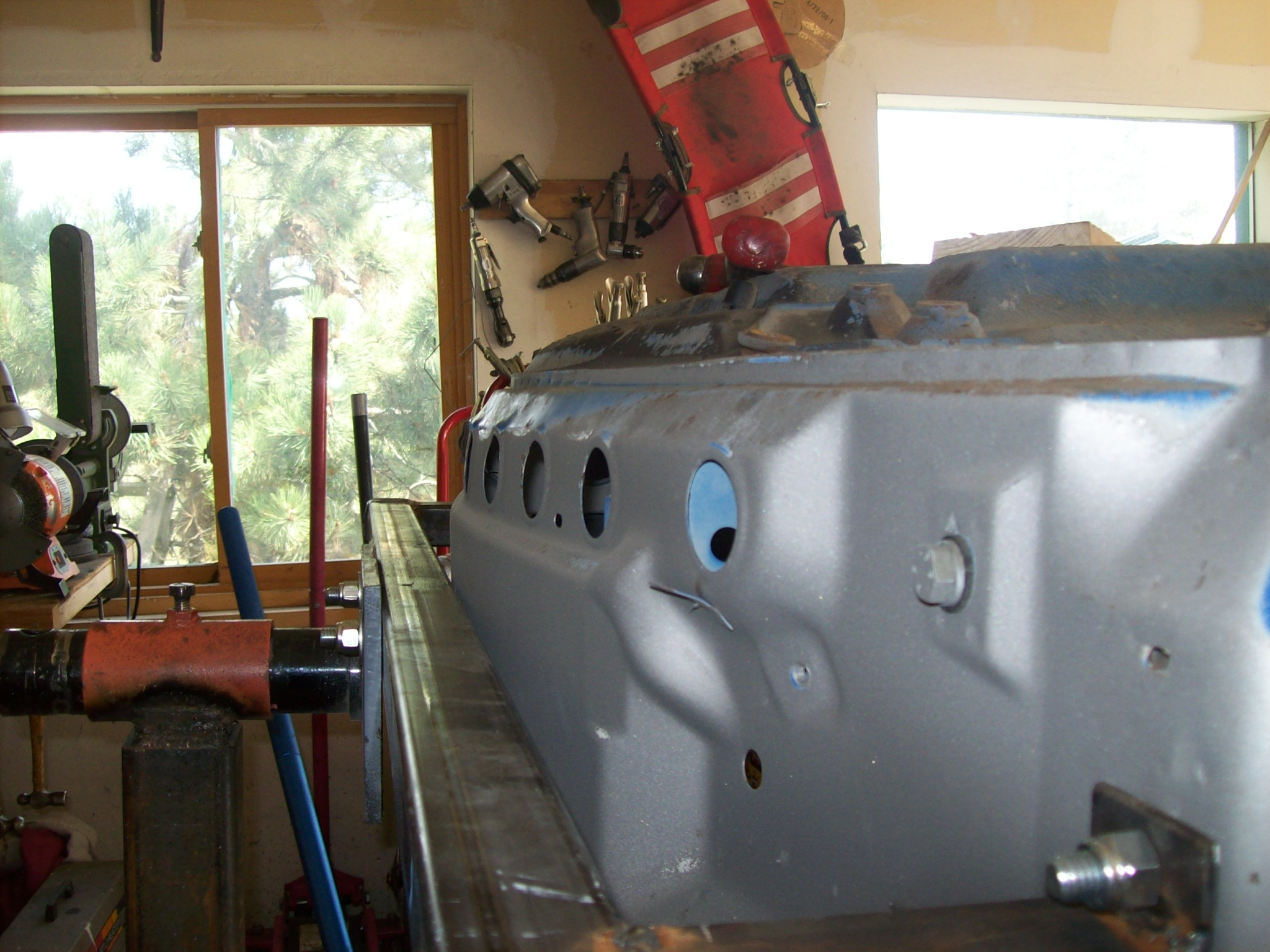

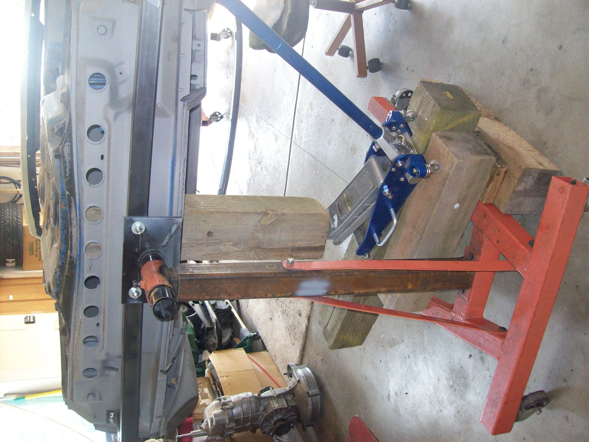

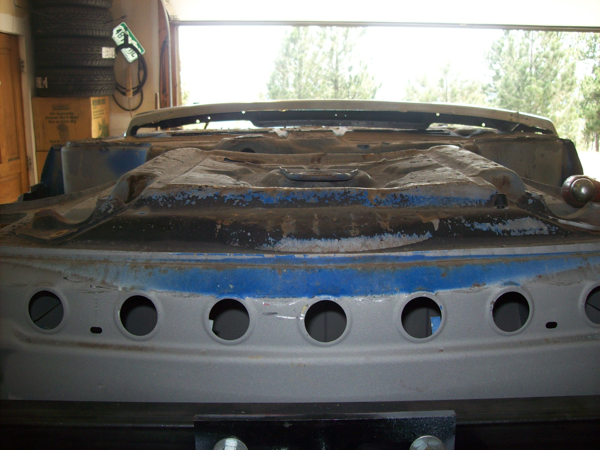

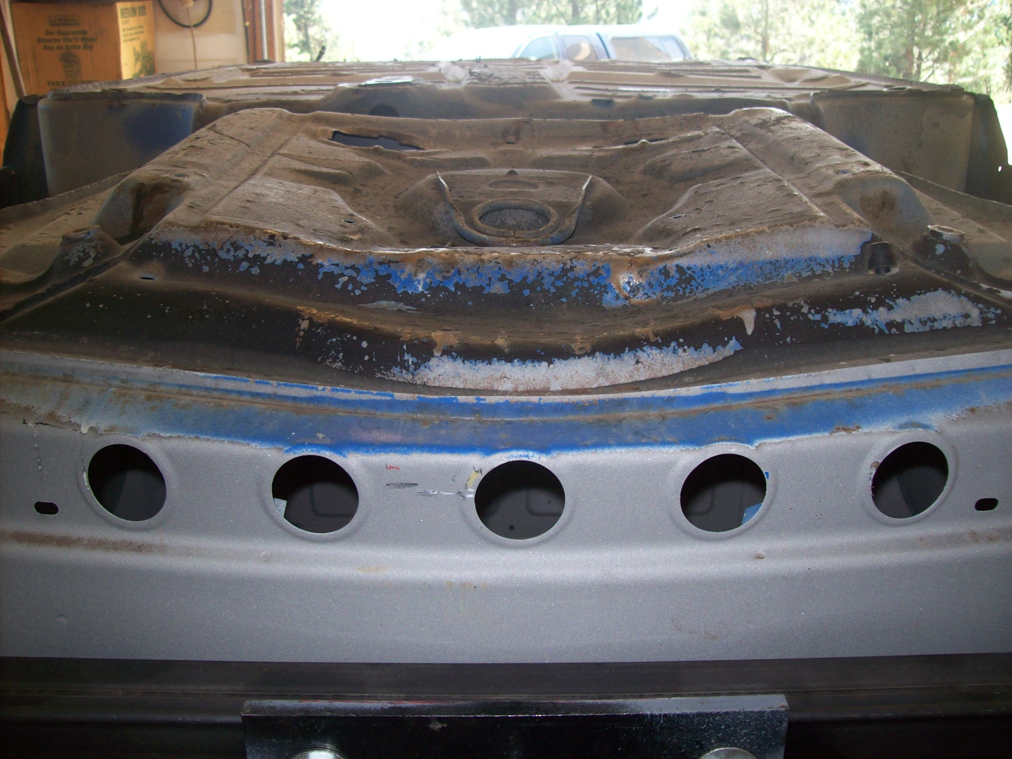

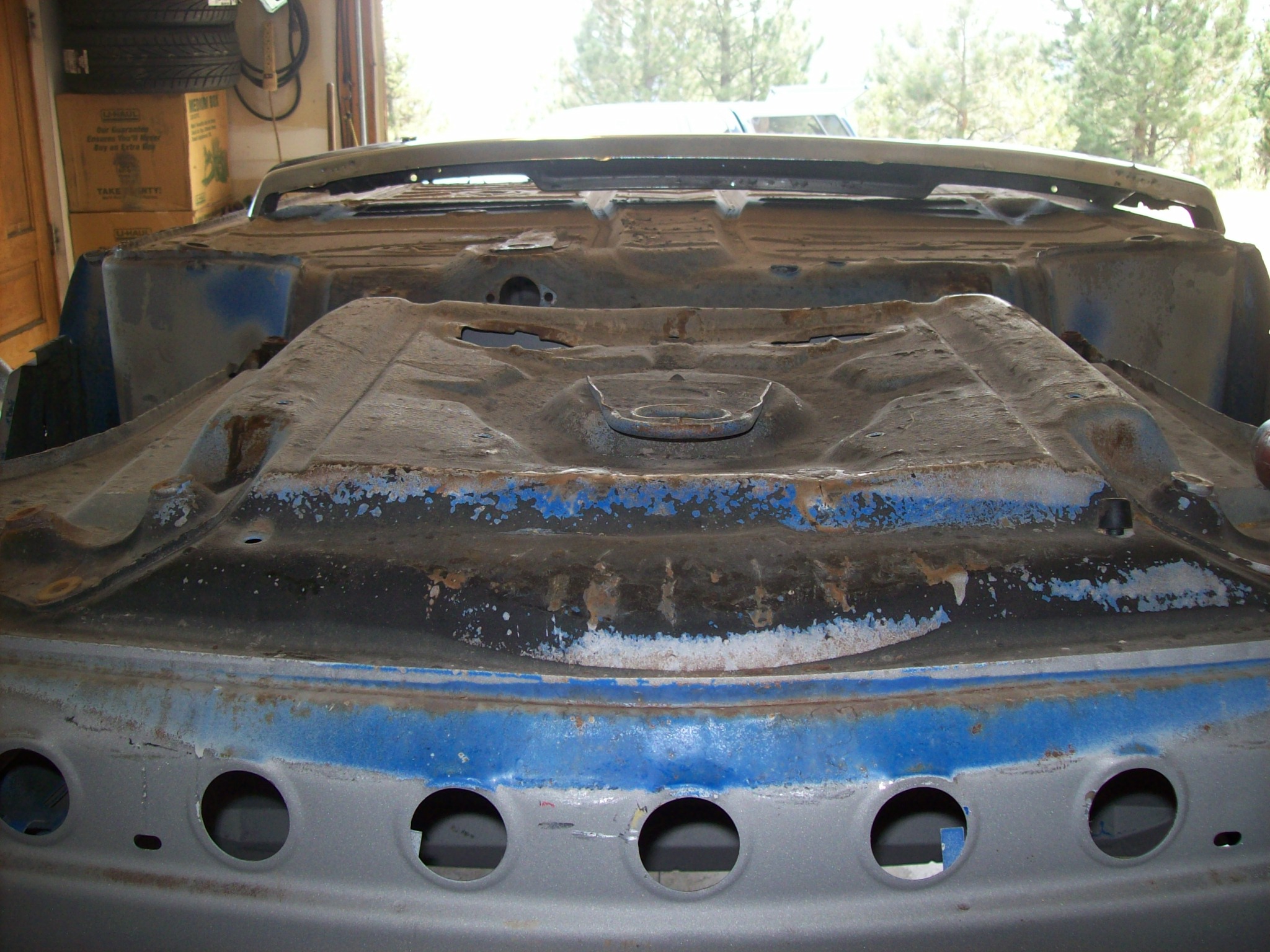

I needed to beat on something this weekend. As it has been suggested (by people far smarter than me)...that the front pan is beyond repair, I decided to tackle it. My first problem was how to create a bucking block. No sense in pushing or hammering awy at the pan without something behind , or on the other side of the force. With the floor jack on the concrete pushing up on the pan using a 6x6, all I accomplished was to lift both the car and the rotisserie up into the air. Not exactly what I wanted to accomplish. So my plan B was to create a platform across the two legs of the rotisserie on which I could place the jack. Now as I force the 6x6 pole up into the floor pan...either the car was going to give (floor pan move), or the rotisserie was going to explode. Fortunately the former happened. Here was my rig...sorry, couldn't get the pic to stay rightside up.
I will go to work on the front lip first. You guys have convinced me that the lip was originally straight, not arched. I don't want to believe, but the pics posted don't lie. This area will be hidden behind the bumper...but it needs to be made right. So this needs to be massaged...note also how badly dented down/in the pan behind the lip...tow hook can hardly be seen
I worked in small segments, using my mallet to relieve the steel as I went along. It was slow work, but it worked. Nothing broke, not sheet metal tearage...I'm quite pleased.
Side view...
So now I bring the tow hook back to life and start to work on the front pan. I thought initially that the pan was so stretched that I'd have to slice it lengthwise and reweld it flat. Or, as Peter at RD suggested...just replace it. I'm optimistic.
