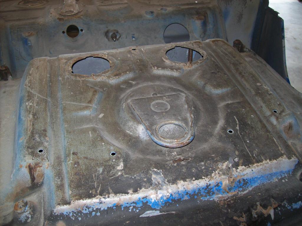

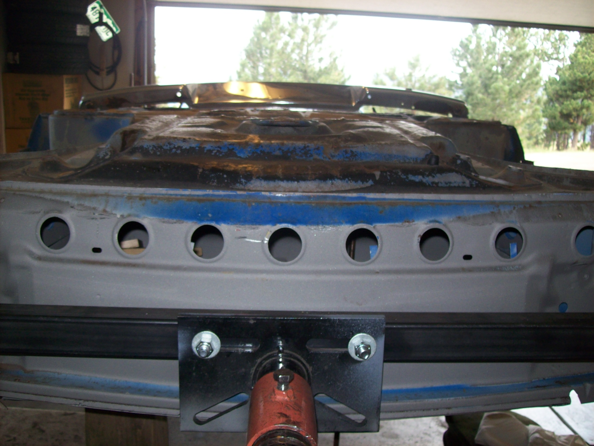

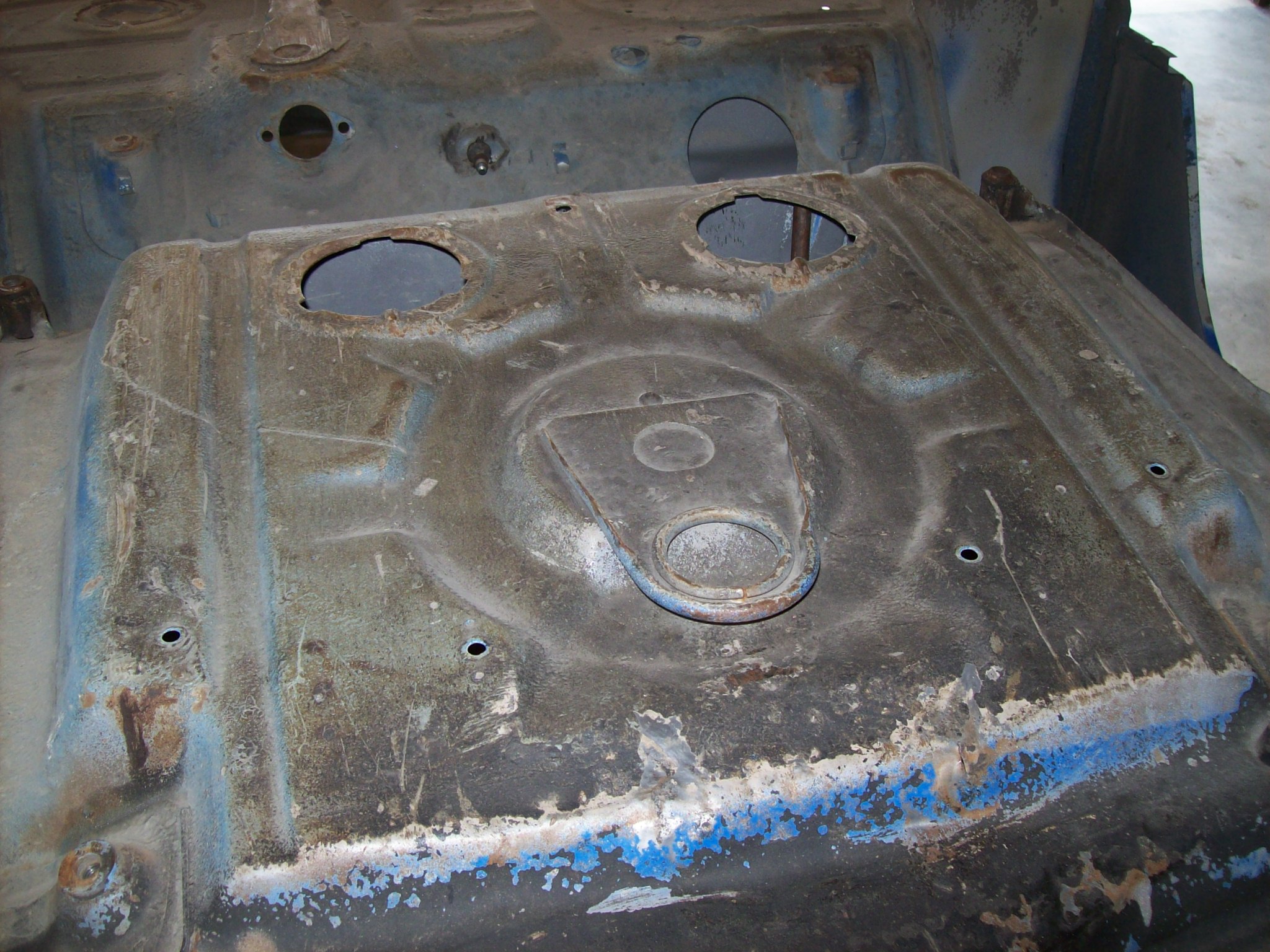

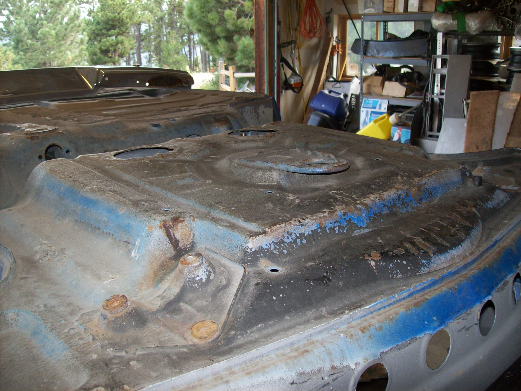

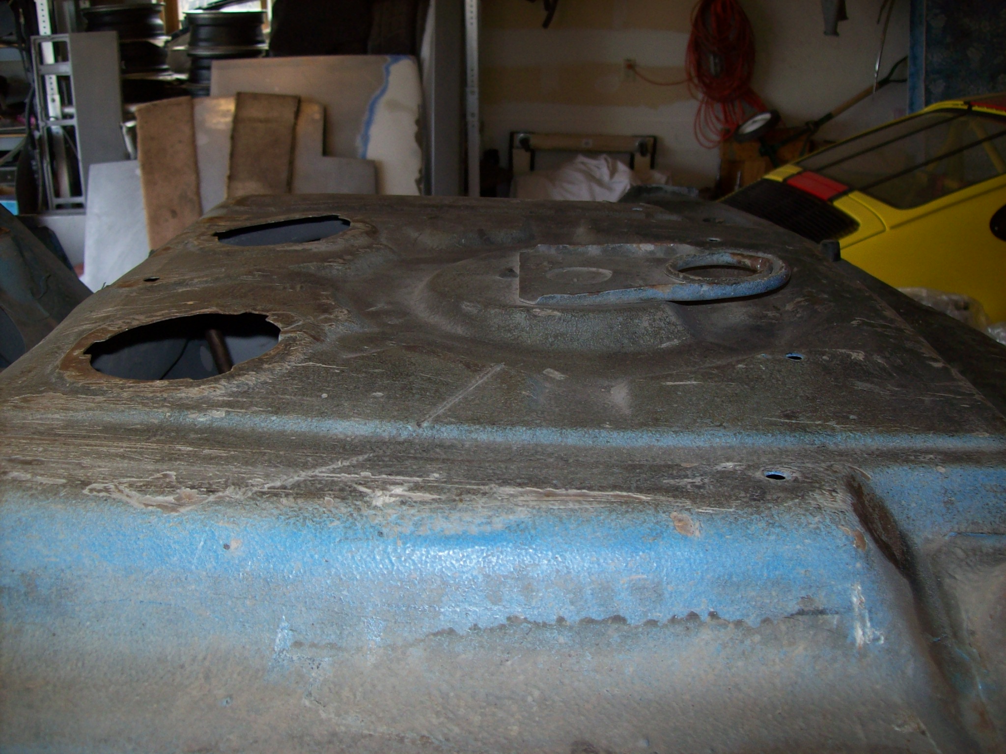

This is going to take some time...lots of big damage, and lots of dings too. I would use the flat surface of the top of the 6x6 as my bucking block as I worked the steel. The jack forces the floor up pas the neutral position and I would work with the hammed to compress/shrink the steel. Then I would release the jack and the floor would settle. Press repeat 100 times. Here is what I used to work the dings out...same process but focused on much smaller ares (like a square inch)
Slowly she is coming back
Side to side and front to back
This would have been a lot easier with two people

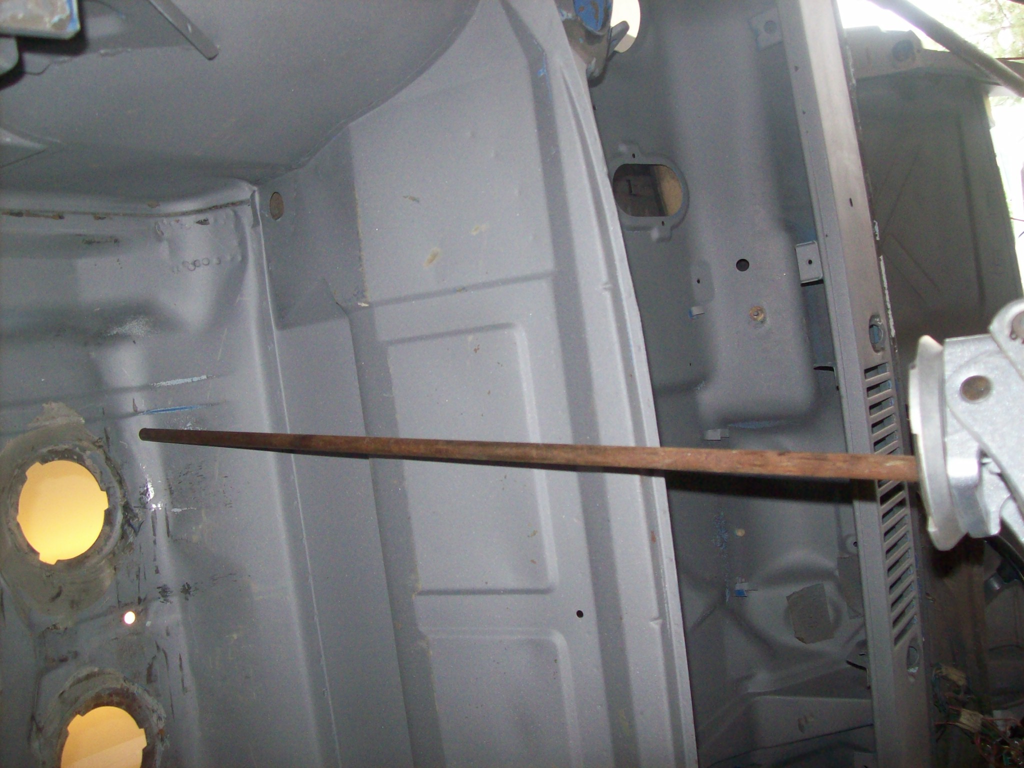

wachospeedo   So I need to get a concensus as to whether where t...   Aug 13 2012, 08:15 PM
seanery   That looks bent to me.   Aug 13 2012, 08:54 PM
brant   sorry but I agree... bent can people please add p...   Aug 13 2012, 10:40 PM
DEC   sorry but I agree... bent can people please add ...   Aug 14 2012, 03:07 AM
Cairo94507   Yup; should be flat.   Aug 14 2012, 06:25 AM
brant   Nice shot DEC does anyone have a frontal shot sho...   Aug 14 2012, 08:35 AM
peteyd   Heres a pic...   Aug 14 2012, 03:12 PM
sixnotfour   Pete's looks pushed up in the center also.   Aug 14 2012, 04:07 PM
Katmanken   Dang, I wonder if the PO used the flat of the fron...   Aug 14 2012, 06:03 PM
seanery   I like where you're going with that ken.   Aug 14 2012, 06:27 PM
