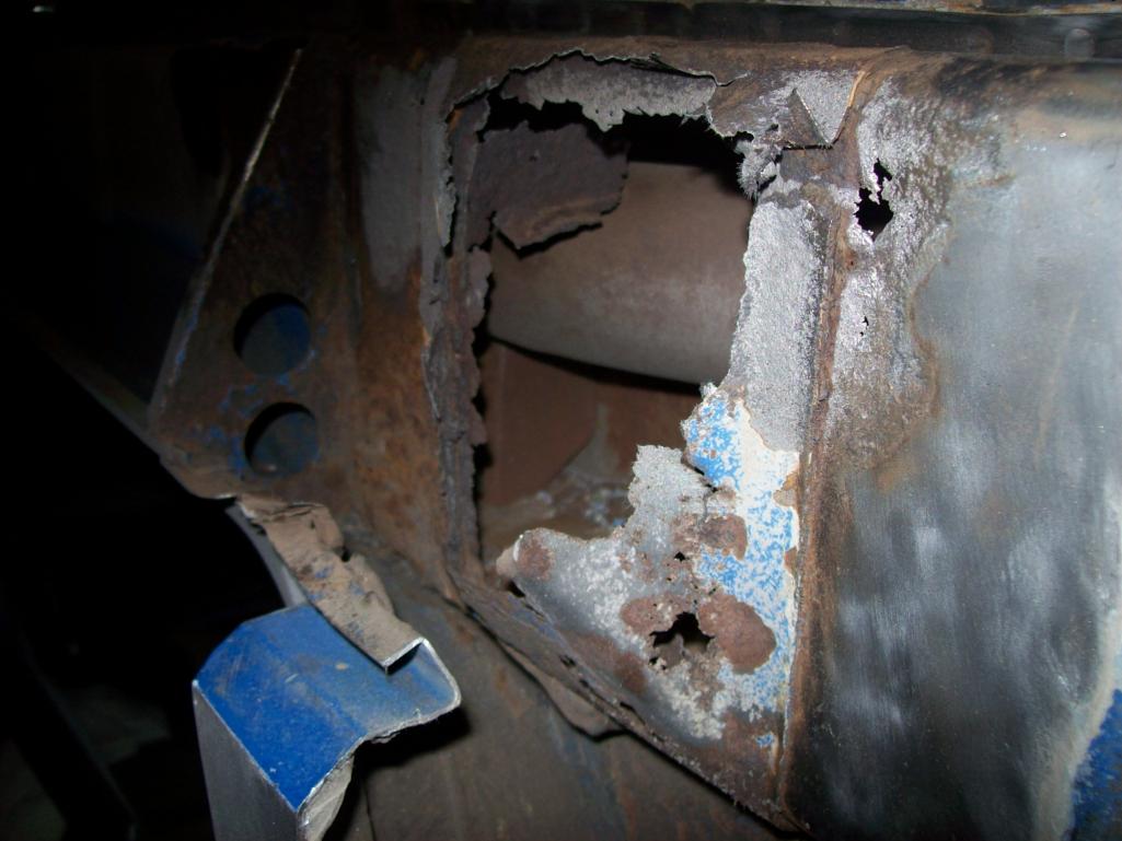

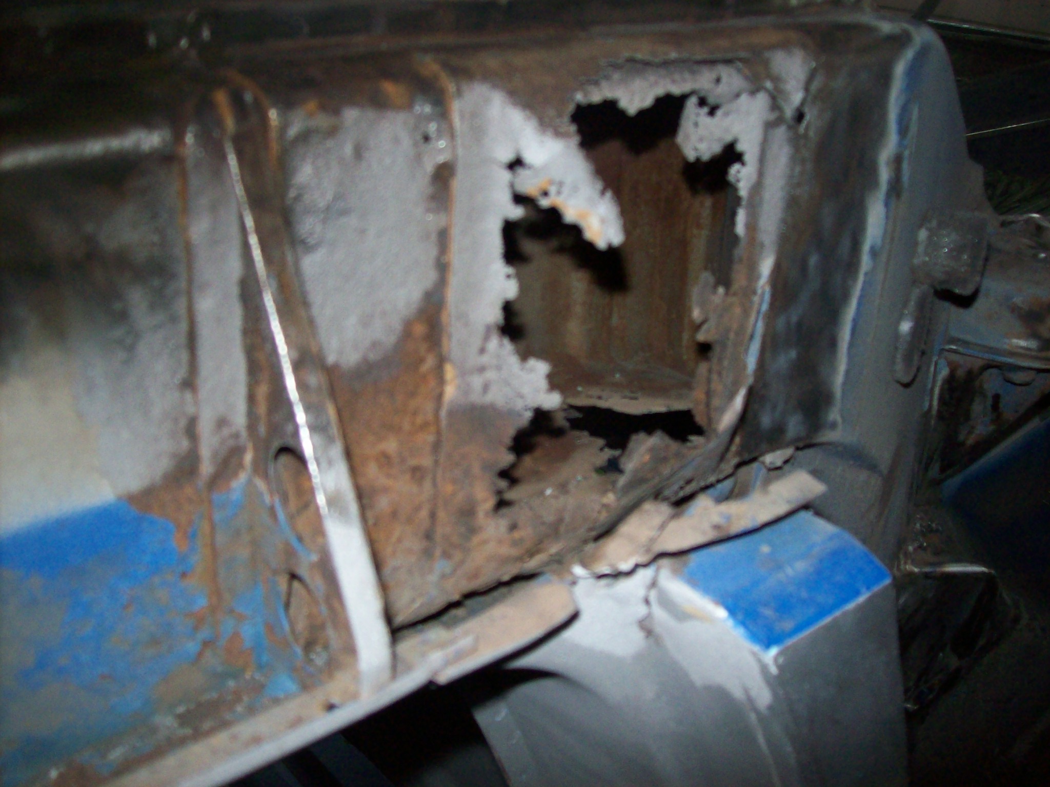

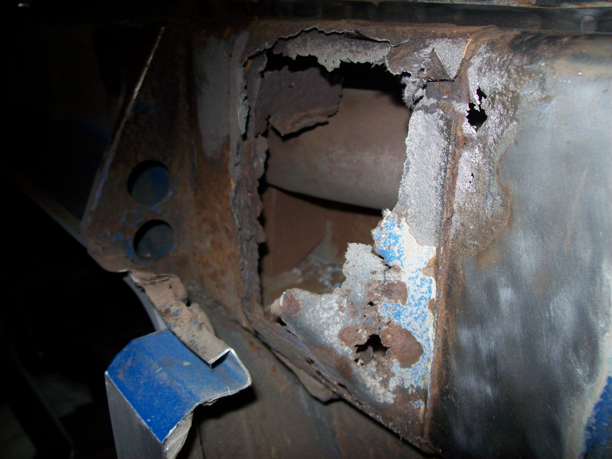

New to the board. Most of my work and experience is over on Pelican with 911 longhoods. I stalked a local PCA guy who was going to eventually sell his 914-6. No pressure, just every few months I let him know I hadn't forgotten. Finally got a chance to see the car in person three weeks ago. Passenger rocker issues as well as surface bubbling in a number of places. Car had been extensively autocrossed at PCA parades for years...very successfully. Owner had pulled the original 2.0 and replaced with a 2.7 RS spec engine with carbs. He bought another mid-engined car (boxster) and ignored the 6. I bought the car (w/ 2.7) and original engine. Got the 2.7 running well enough to drive the car...and decided to dive into the resto. I am familiar with rust, and plan to do it correctly. I have a rotisserie with 911 mounts, but shouldn't be a big deal to make mounts for the 6. Made a couple calls to Resto Design to check on parts...and away I go. I have a 71 911 softie that has been at paint too long...so while I wait for it to come home, thought I would see what my sandblasters schedule was. Turns out he can do the car in two weeks. So, I have a deadline. So...I guess this is my resto thread on my new Adriatic Blue 6...
I took a few hours Friday afternoon,a couple yesterday, and a few more today. Almost ready for the blaster
yuck...passenger side. Drivers side looks ok. Before you question...yes I do have some hell-hole issues.
More later...

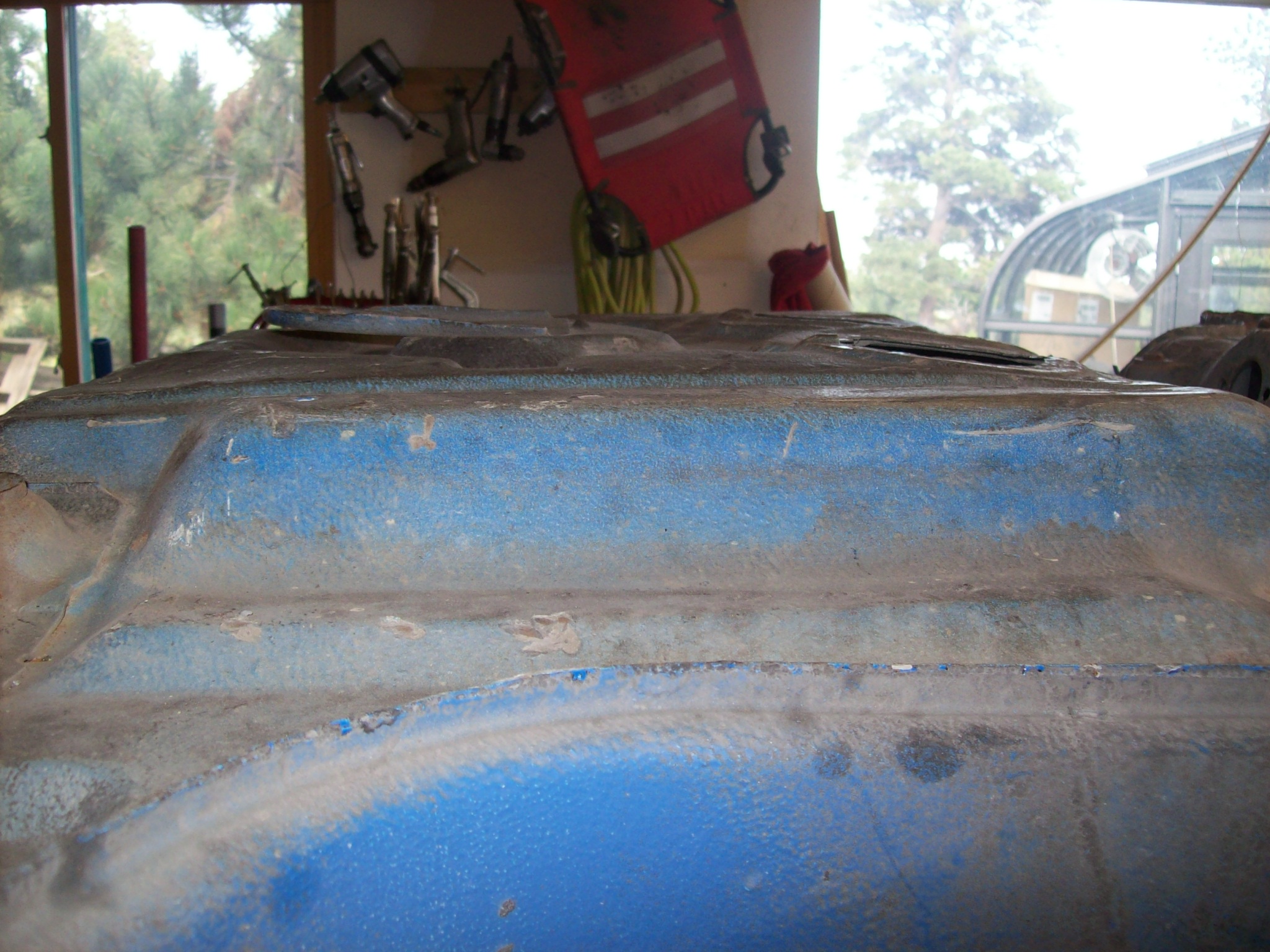

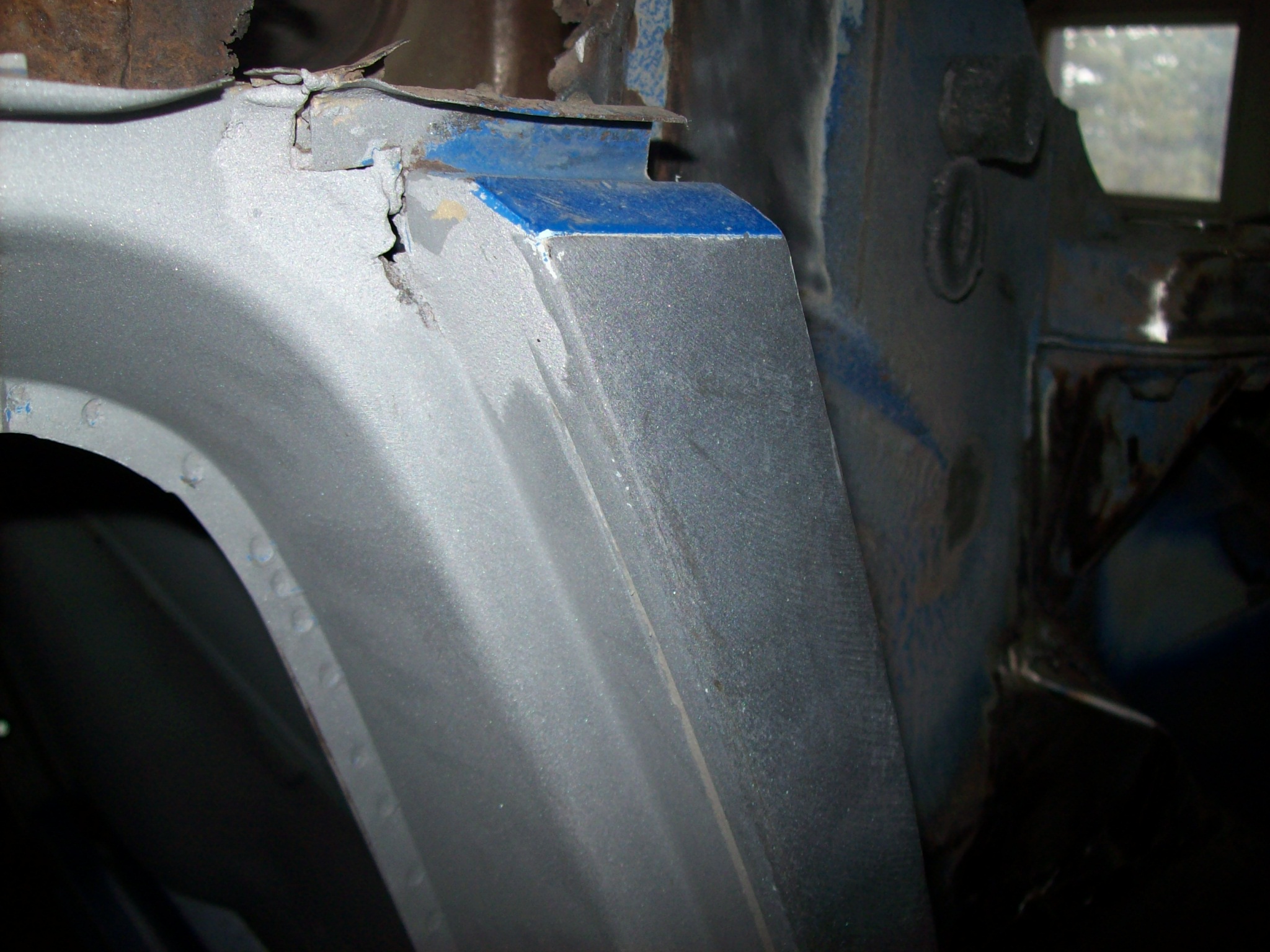

And the finished product...
Beats replacing the entire pan. This is in better shape than most pans I have seen (granted that would only be a few) and after it gts wire brushed and sealed up, the Wurth undercoating will hide any minor imperfections that remain. There are some dings in the center floor pan, but I think they will best be addressed when the car is back upright. The bottom lip,flange of the floor pan was trashed from "errors in jacpoint decisions" in many places, so I spent some time circling the car, bringing these seams back to vertical. Next step is to attack the passenger rocker and jackpoint. I get to drill out some spotwelds in preparation.
What are the supports called that hold the sill in place...sill supports?
I may need to remove the lower 8 inches of the lockpost to get good access to this area.
I am actually looking forward to this area as it is totally different than repairs on 911s in the same area.
