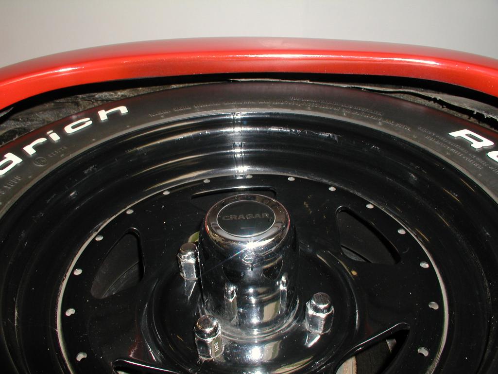

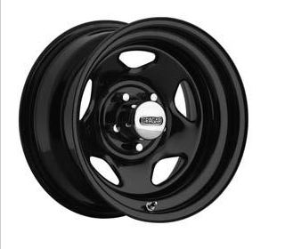

Lennie,
The wheels are Cragar 365 and are 4 x 100mm pattern. I'm not sure they sell that pattern anymore.
LINK to CRAGAR 365
I think I have 7" x 15" up front and 8" X 15" on the rear. I am running 215/60 front tires and 245/60 rear tires. I have no rub front or rear but less than 1/2" clearance on the rear fender well with 1/2" spacer.
